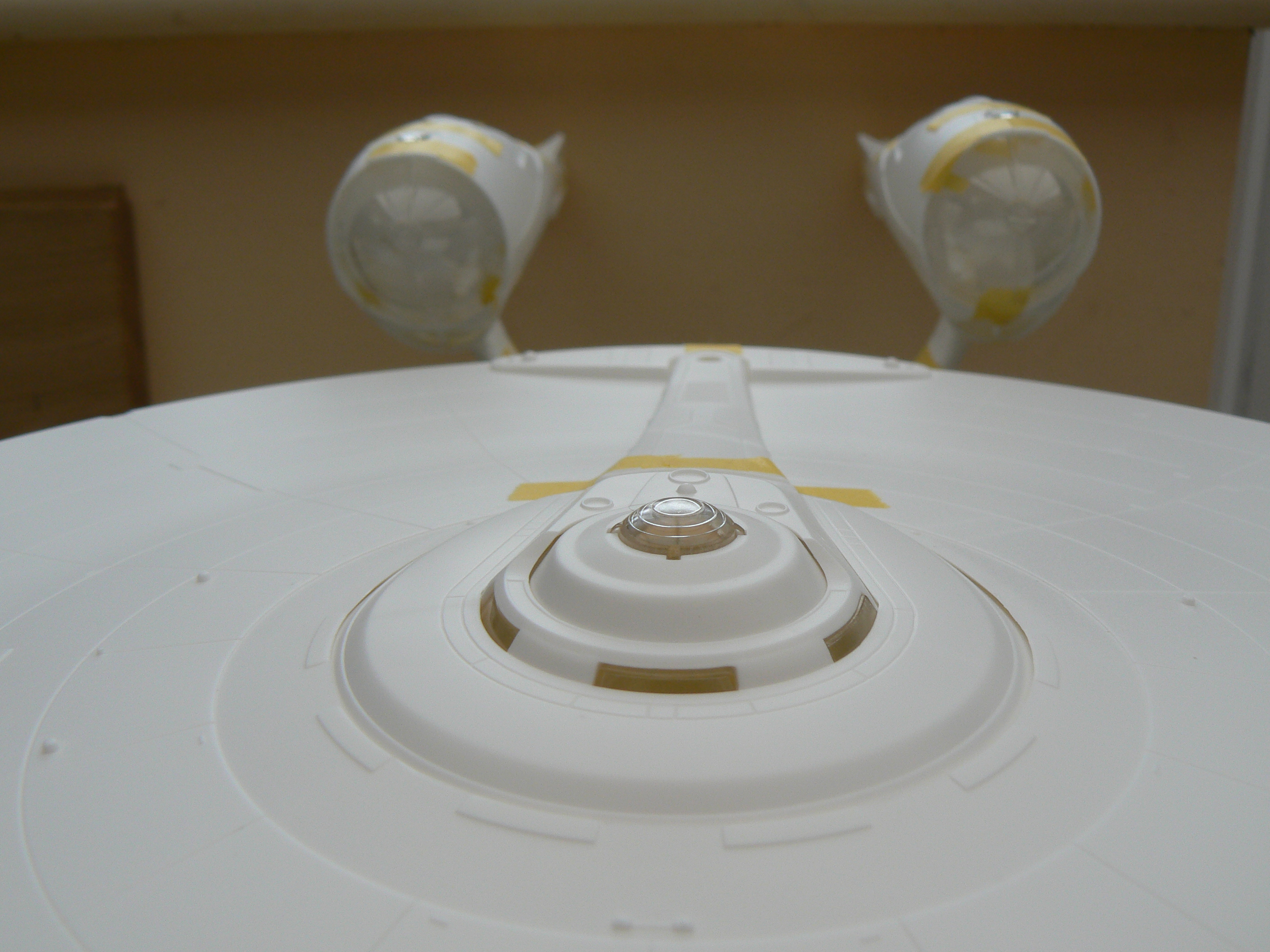

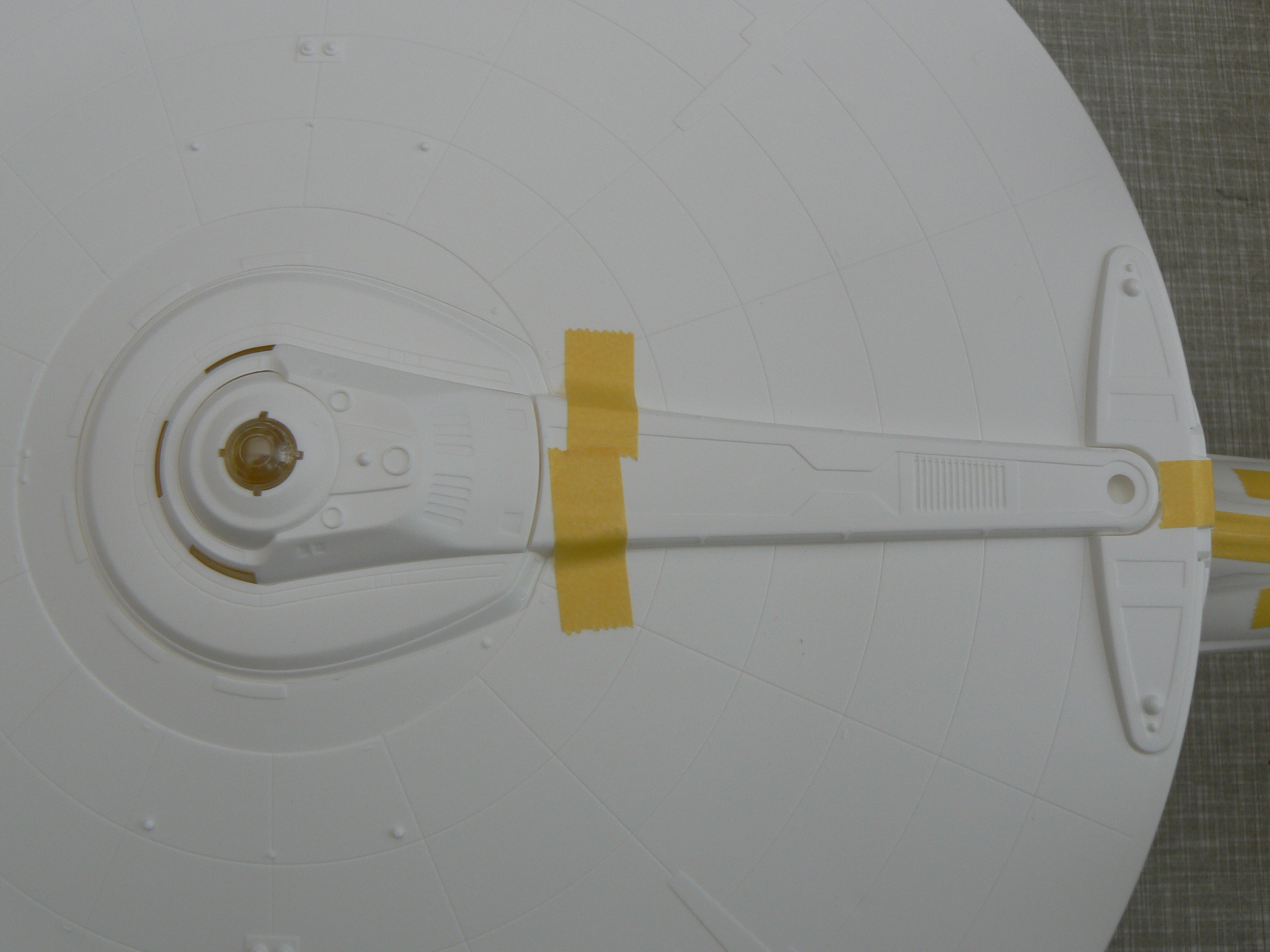

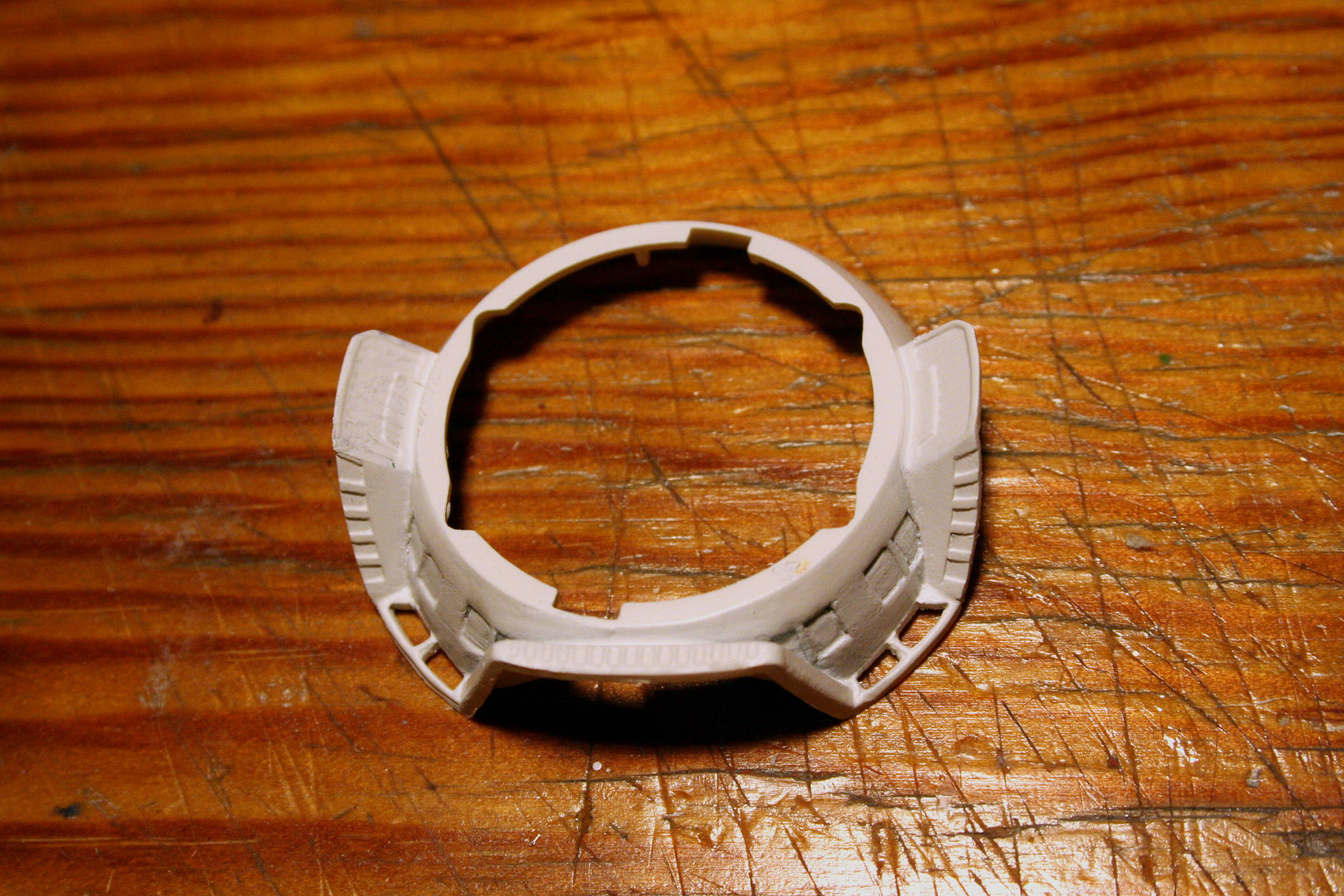

today I nearly finished the sanding-and-filling work on the ring part. Here is how it looks now:
It has still some scratches but overall I'm quite happy with how it came out. Compare it to the picture of the unboxing to see the changes.

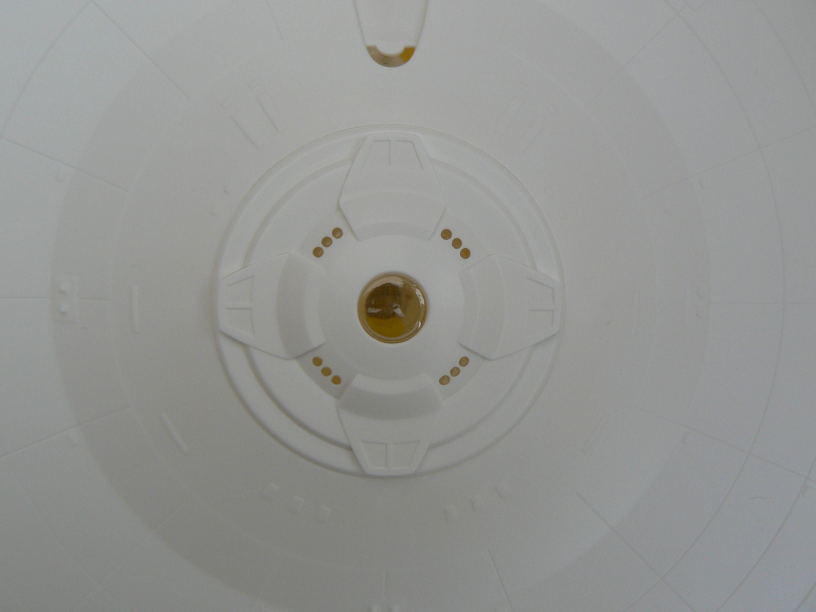

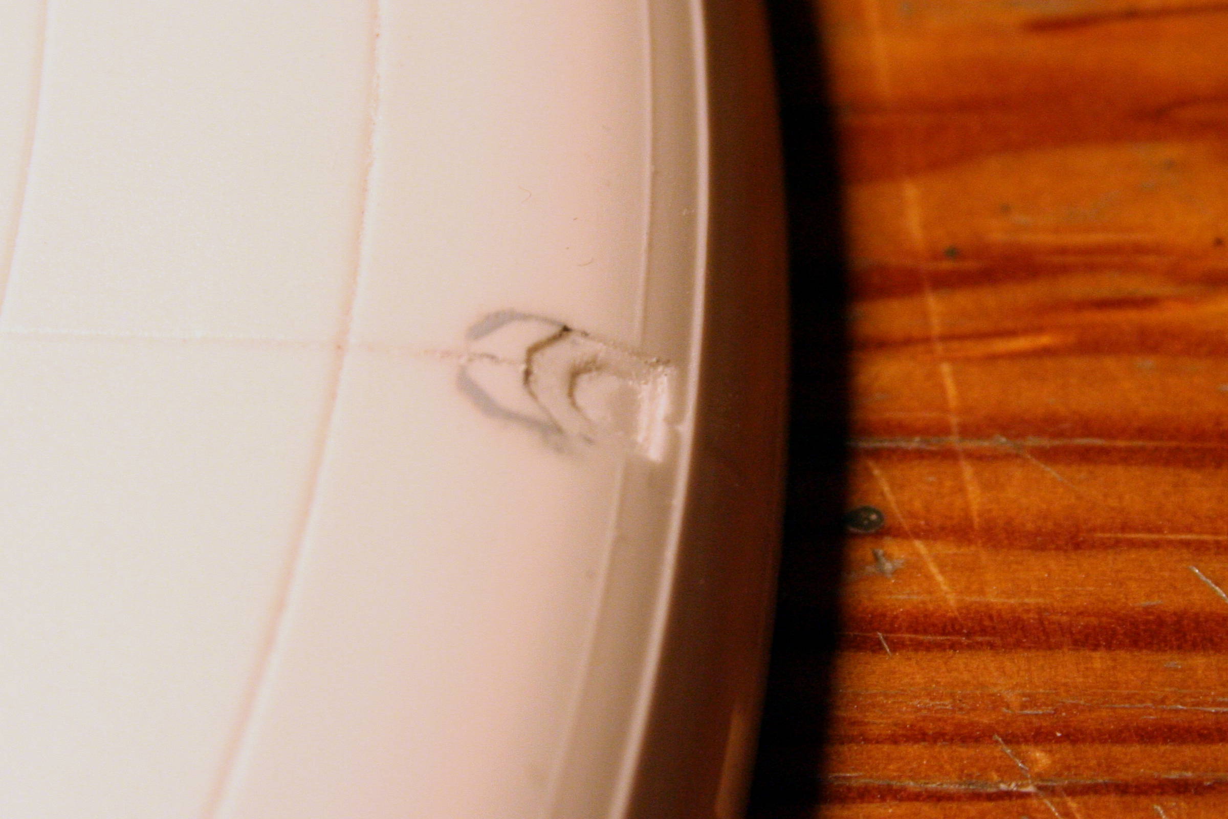

The other area I worked on were the maneuvering thrusters on the bottom of the saucer. They are located about 3.5 mm too far towards the center of the disk, and lack any realistic detail. So I first scraped them larger towards the outside and then gave them a recessed inside like the (more correct) ones on the top side. Then plastic card and filler was used to fill the old recessed areas. The still frames from the movie don't show more detail so this will be the final result:
I also filled and sanded some remaining sink marks. Now I have to scratch build the inside of the Bussard collectors and all corrections of the kit except lighting are done. Can't believe it went this fast! :)

DanielB, in fact, moving the thrusters was the easiest and fastest modification yet. It was completed in 2 hours.

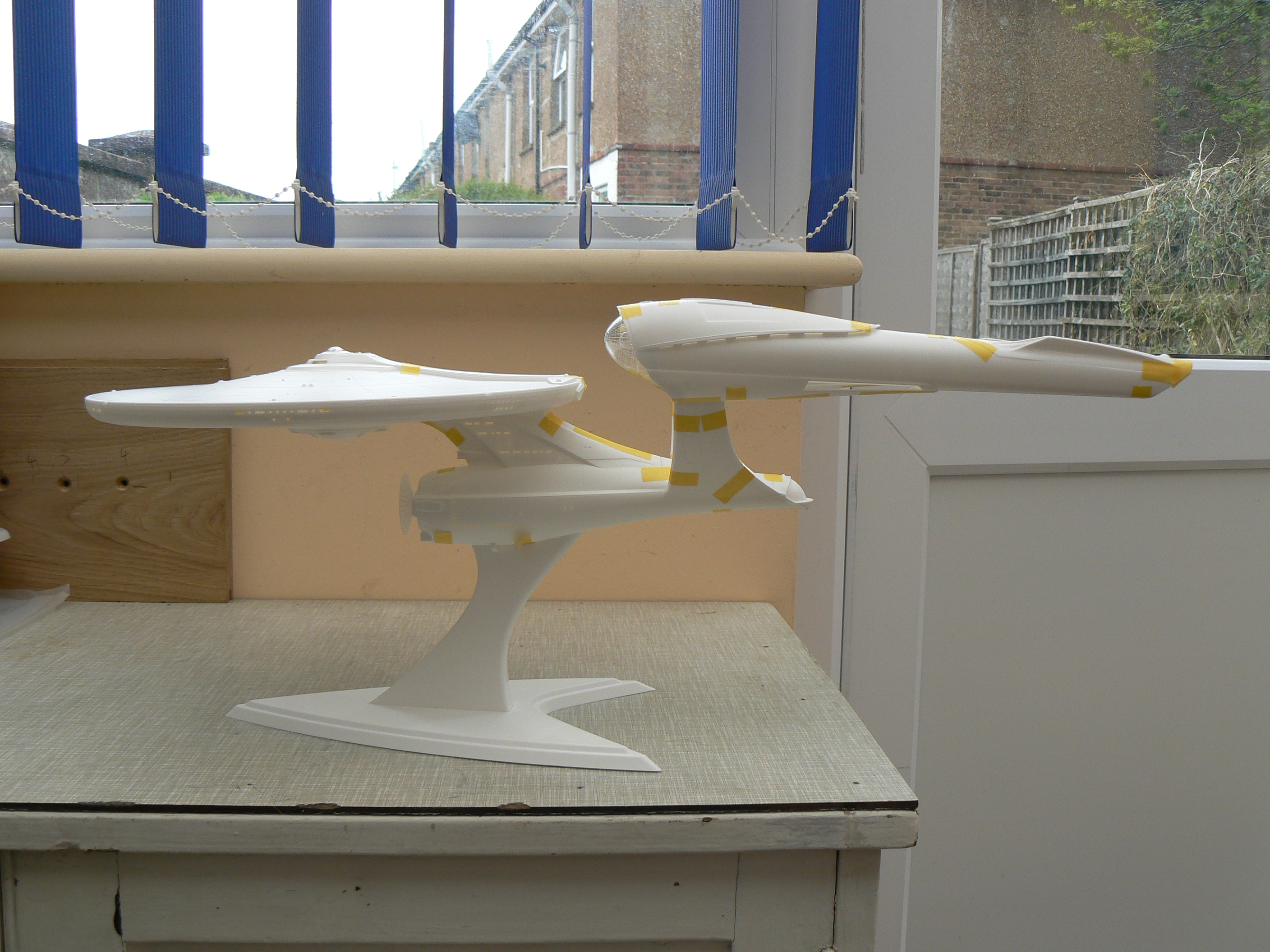

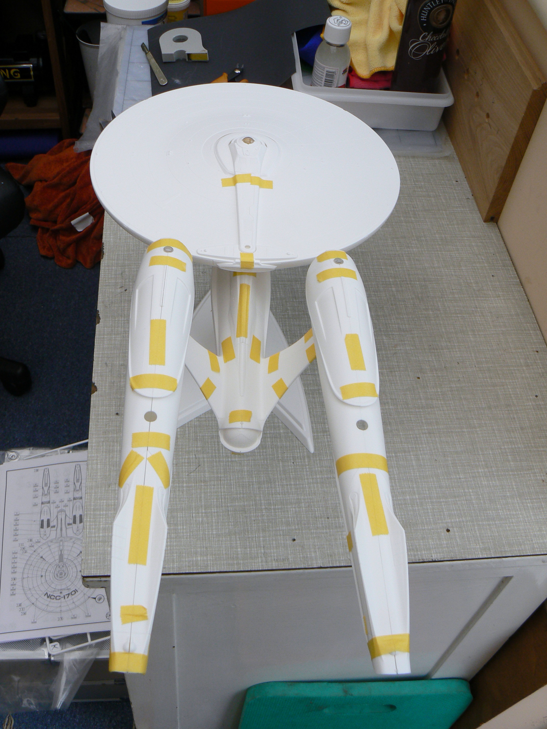

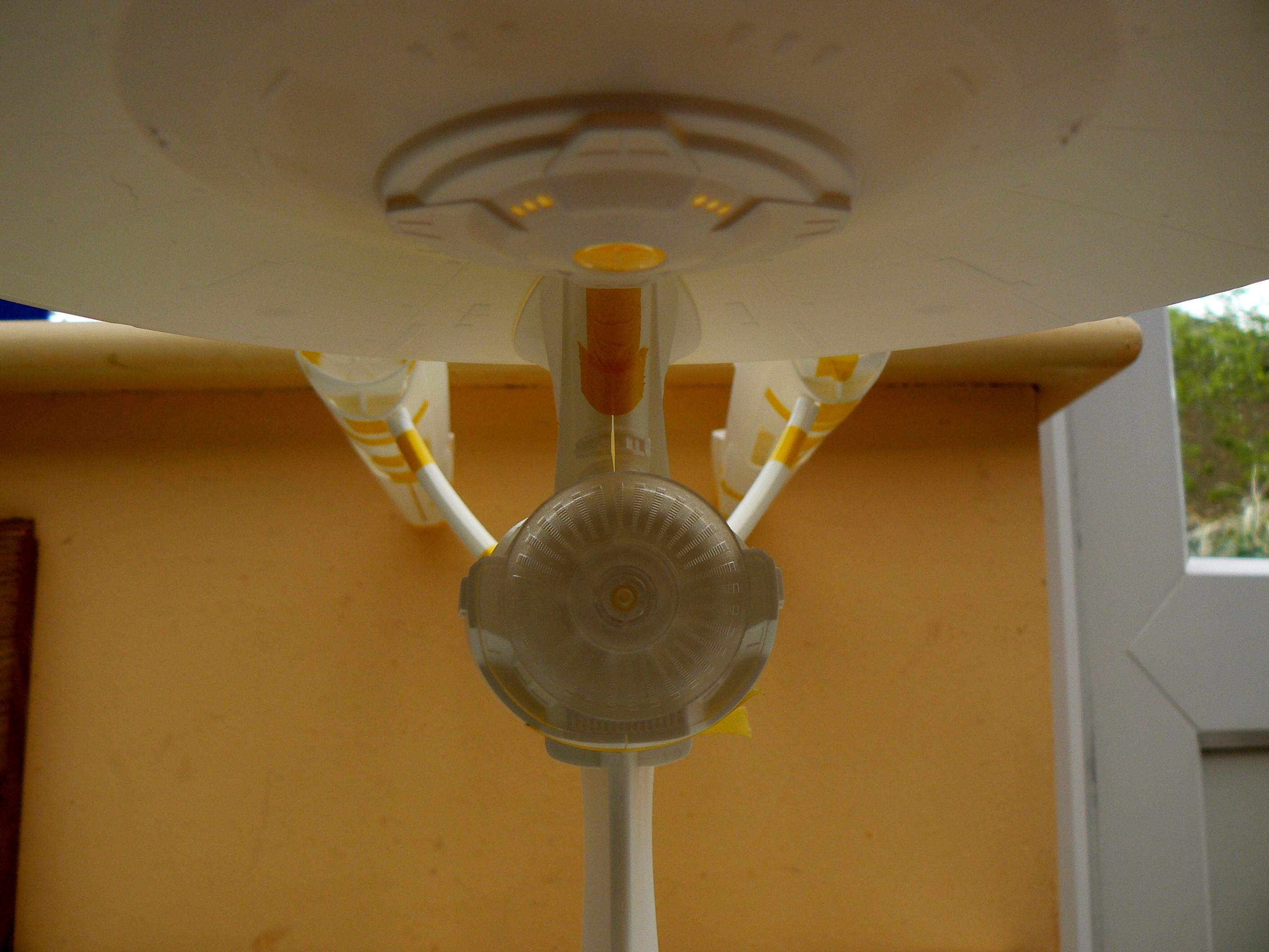

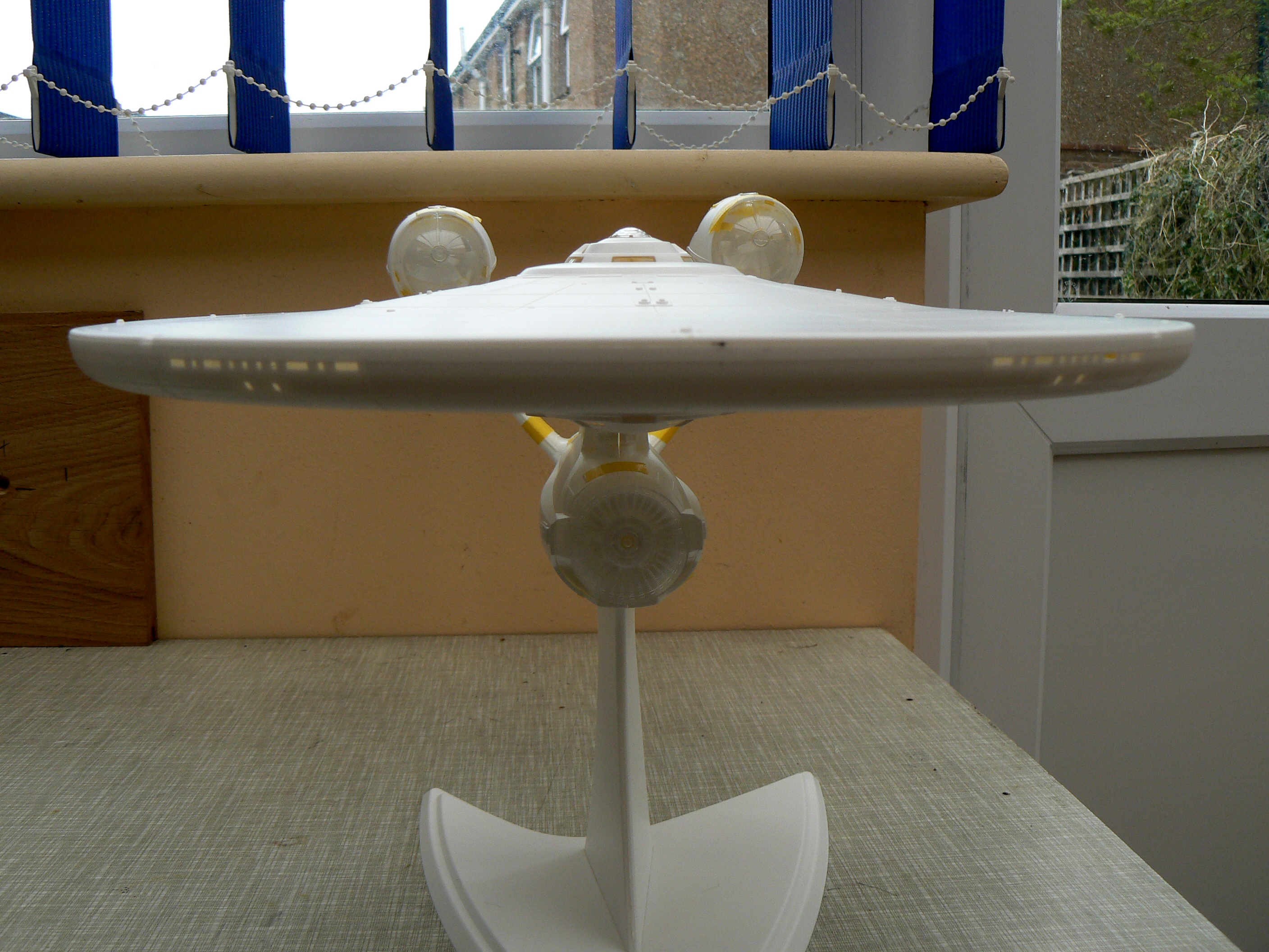

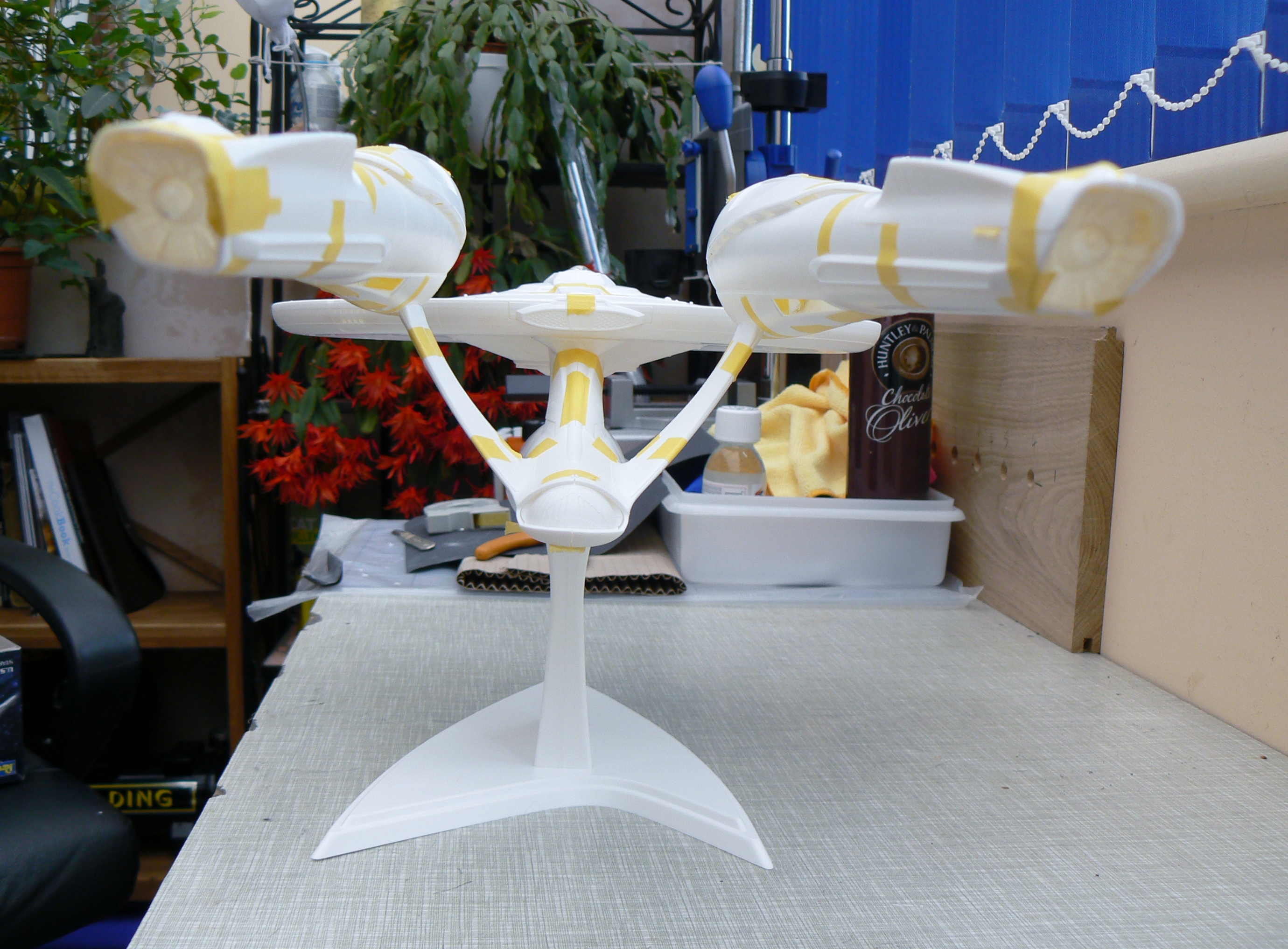

Thanks for the post. I picked my kit up on Saturday and yesterday did a full dry fit which shows where work is going to be needed for superdetailing the model. I'll referring to this video often during the build process. There are a few things I'd like to share. The overall fit of the parts is excellent, in fact I'd go as far as saying it is one of the very best Trek kits for fit in all but a few places. The saucer goes together so well that there is no way you'll need to fill except where the impulse engine insert goes. The B/C and bridge deck and the planetary sensor array parts parts fit so well that once again, filler just won't be necessary. The engineering hull is a good fit however, the shuttle bay end wants to spring apart but that's secondary as the major problem I've found with this dry fit is the nacelle pylons. This may only be an issue with my kit, but I have found that, due to the thin plastic and the shape, the pylons are out of true causing the nacelles to be anything but straight. I think an internal armature will be necessary although I don't have the foggiest idea as to how to tackle the issue. Any suggestions will be appreciated. Two other areas give me pause as there is a gap at the forward torpedo launcer and around the nacelle exhausts. The positioning of the three areas on the nacelle fins that raise at warp are also incorrect. I hope this helps. i've attached some photos of the dry fit so that everyone can have a look. This is all held together with masking tape. If you decide to dry fit the saucer to the neck pylon don't! There is a U shaped cut out in the saucer and there are two lugs on the front of the neck. Get those locked in and you will have trouble getting them apart. I broke em off! Enjoy :D P1040254.JPGP1040255.JPGP1040256.JPGP1040257.JPGP1040258.JPGP1040259.JPGP1040260.JPGP1040262.JPGP1040279.JPG
I noticed that as well so which version do you decide to build. Shame Revell didn't give the option for both. It looks like this post is somewhat redundant. Apologies for repeating what has been posted elsewhere.

Aries2- for some weak spots in other models i have just layered J-B weld on the inside for structural support, not sure what kind of room you have to play with if you plan on lighting her up or not.

Thanks, I do indeed intend to light this model when I have all the necessary bits and pieces to build. There isn't a great deal of room inside the pylons, enough for wiring and maybe a sheet metal armature if I'm clever about it. My pylons seem to need bending outward slightly otherwise the nacelles are tipped slightly out of line along the vertical axis :(. Looks like this one area is going to cause the most trouble. This could be a very long build.

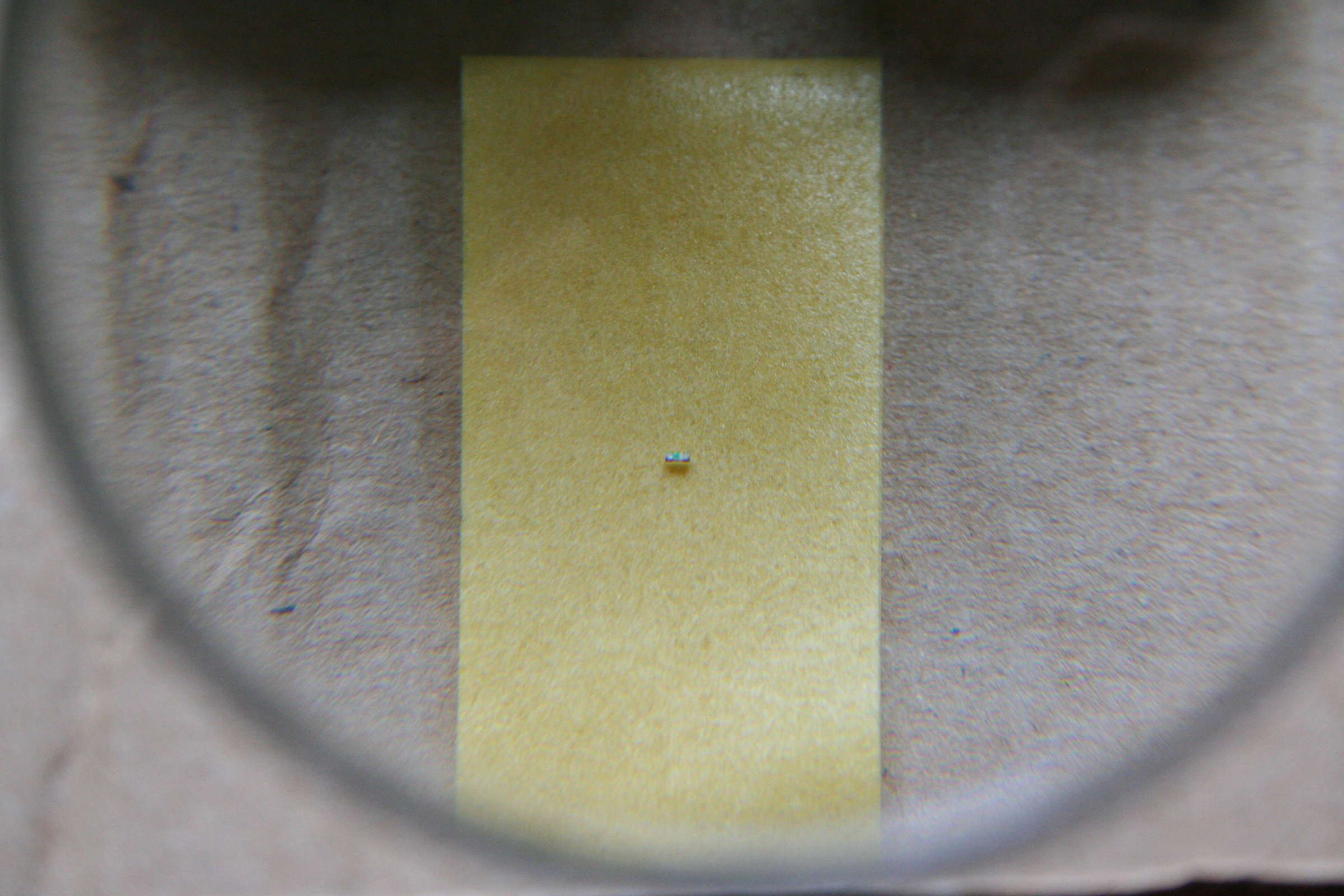

I'm just back from the first attempts to solder the first LED... without success. For you being able to see what we are talking about, here are two pictures of one LED:
The first shows it in the tape, on the second picture it is put onto Tamiya tape. The longest side is exactly 1mm, the pins are the silver rectangles on each side.
I tried to assemble it to the wires for about 1 1/2 hours now without success. Almost everytime when I got one wire on and tried to solder the other one in place, the first one came off again. About 4 times I had both in place, but after connecting the other ends to the plugboard one wire came loose. The connecting surface is just too small to withstand any mechanical forces.

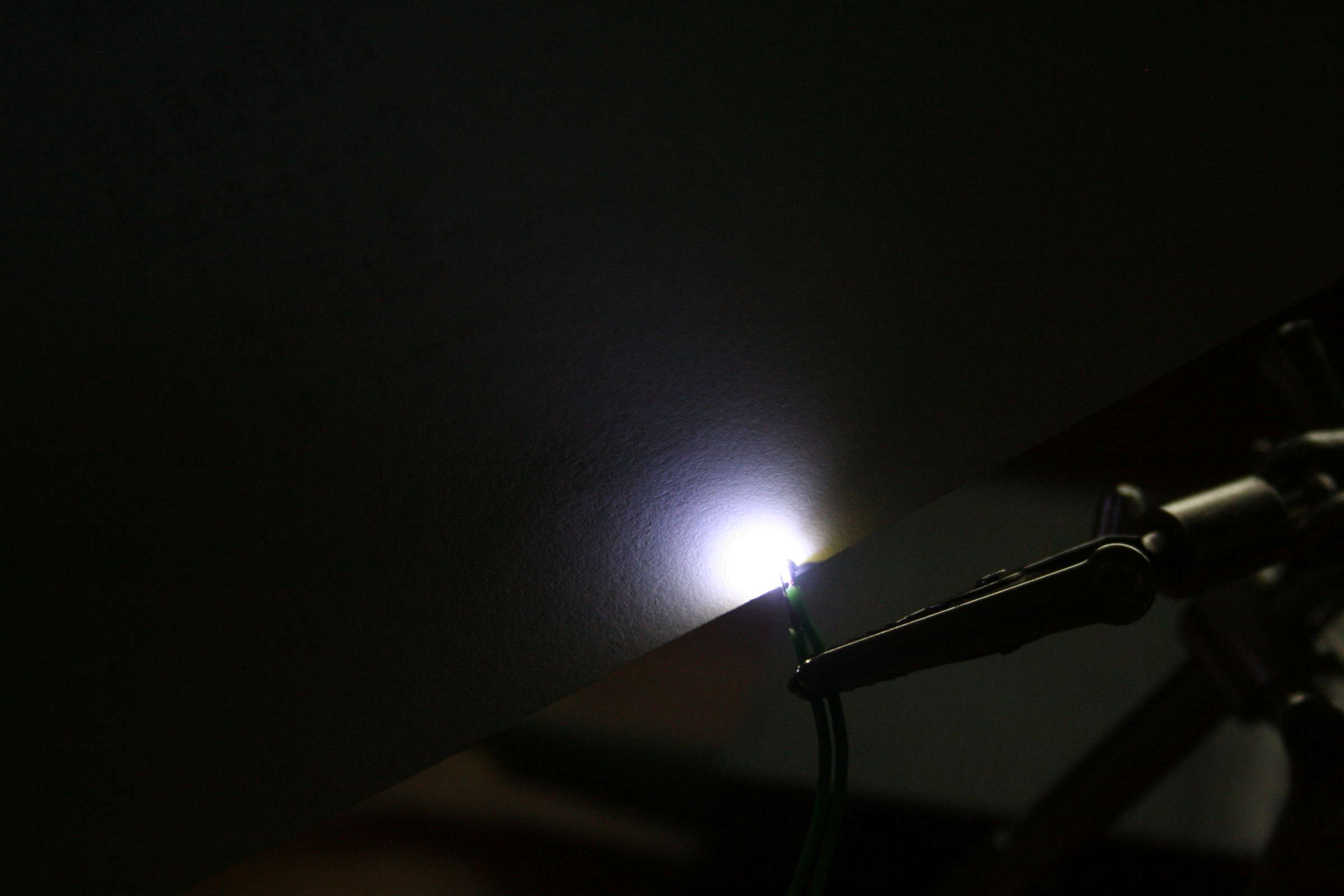

However, with one wire soldered and the other helt in place with a clamp, I managed to at least connect it to the battery once to see how it looks like when turned on. Here is a picture with a paper helt to its backside (paper in touch with the LED):
The first impression is that you should not directly look into the LED, it is so very bright! I guess the look on the surface would be ok, but if I don't find a way to connect it properly, I will have to come back to the lighting-from-behind-method... Sadly... So if anyone has an idea how to fix it, please tell me!
