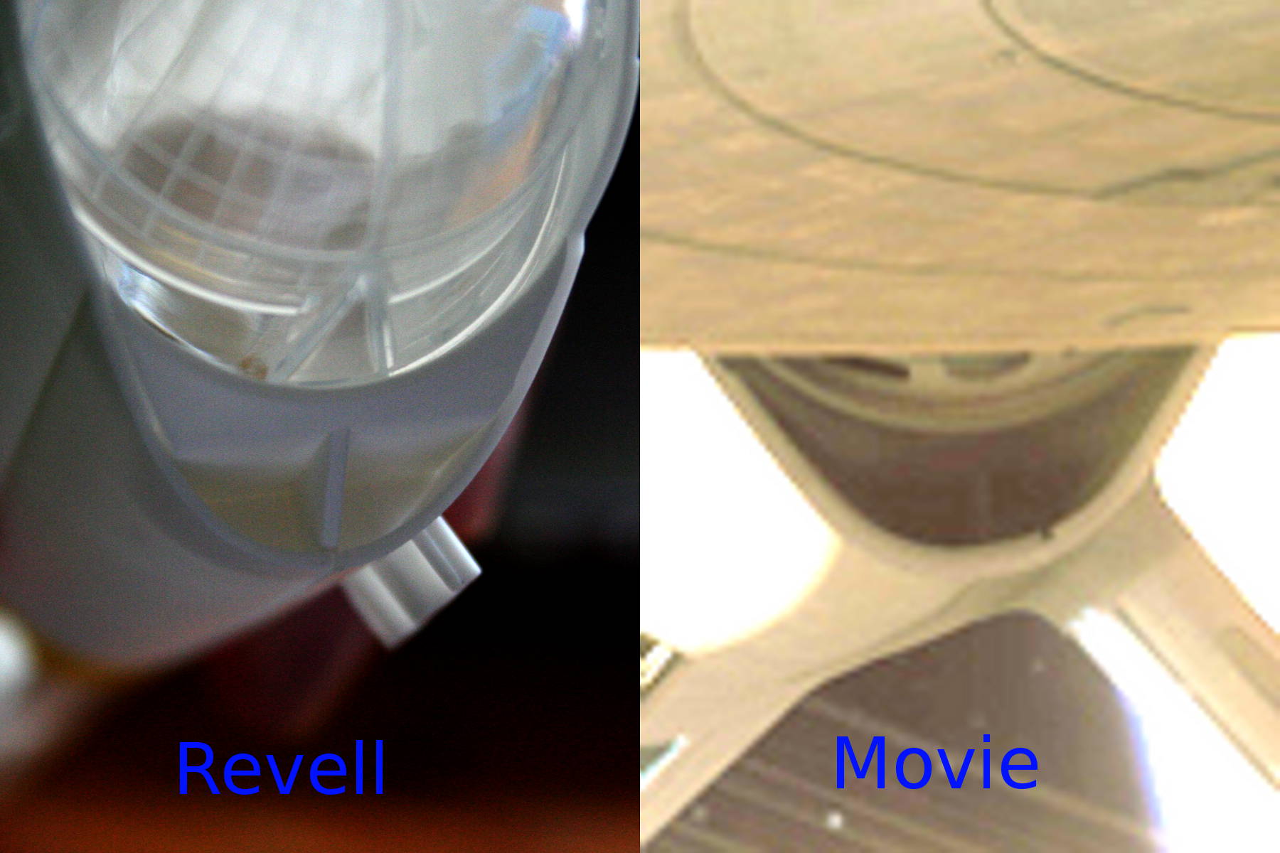

I'll now work on the warp nacelles first as they also have some delicate spotlights down to the pylons... A quick dryfit of the bussard dome parts reveals another area of inaccuracy, as seen in this comparison shot:
The right image is a contrast adjusted crop of the shot where the ship hovers over the atmosphere of Titan. It's also the only one known to me which shows the vertical lip in the "intake" below the dome, which is not really correctly shaped on the Revell kit. I hope that I find a way to replicate this closer to the real thing. I'm so tired of making major corrections everywhere in the moment... :sick

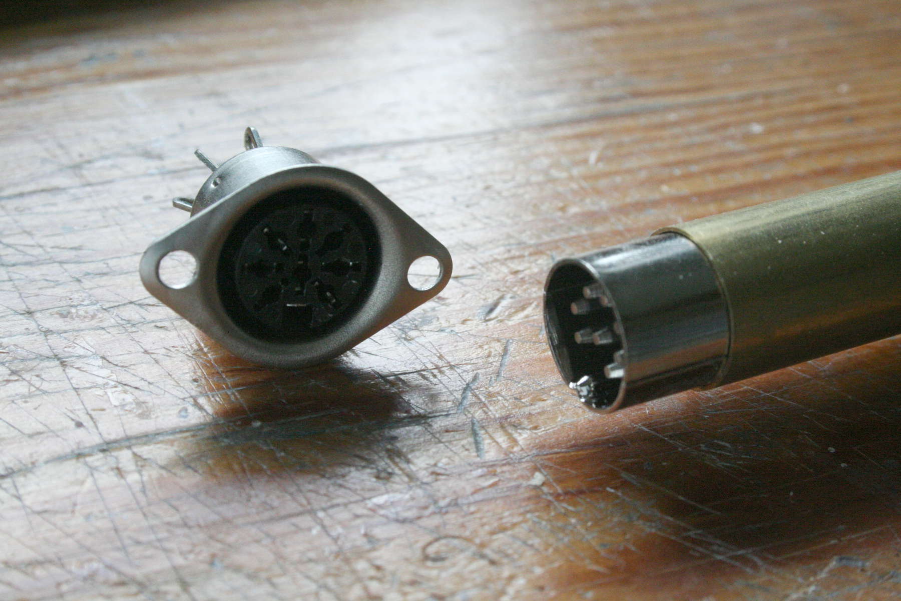

Today was shopping time again. I got a new 8-pin plug on which I will mount the ship on,
some IC connectors and most important: IC L7805 voltage regulators. They have an output
voltage of 5V, so I can run the electric motors with them directly. And it will allow me to use the
transistors of the strobe circuit without a resistor on the base (as Orbital Drydock pointed
out, they can handle only 5V there). But I may have to adjust the resistor values of the
circuit a bit therefore. I'll post an updated shematic when it's done.

The plug I bought are probably not what you mean, they are DIN-plugs which are quite large but can handle a lot of weight very safely. I'll post a picture of them tomorrow, together with an update on the Bussard rotors which I just built.

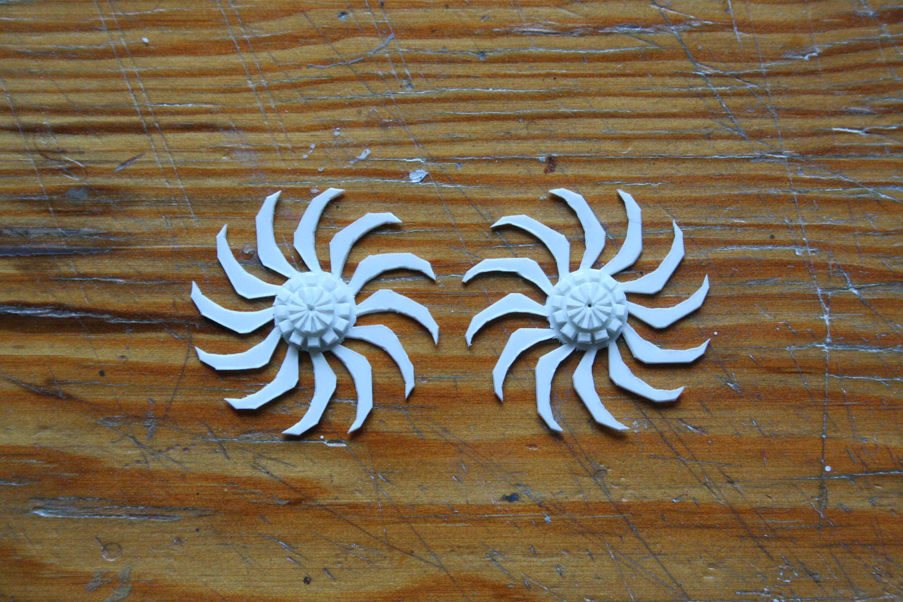

as promised here is a report on the Bussard collector rotors.
They are built up from 3 main layers of 0.5mm plastic sheet,
with another 0.5mm layer between to give them more depth.
The fine details were improvised with small basic triangles
and rectangulas.
The whole assembly won't be seen too detailed through the
dome, so I didn't care too much about clean cuts.
Perhaps I'll glue the rotor to a disk of frosted clear plastic
to give it more strength and to diffuse the light from behind.
Here is the template sheet for the rotor parts, perhaps
someone finds them useful.

Sorry, forgot to add a picture of the plug:

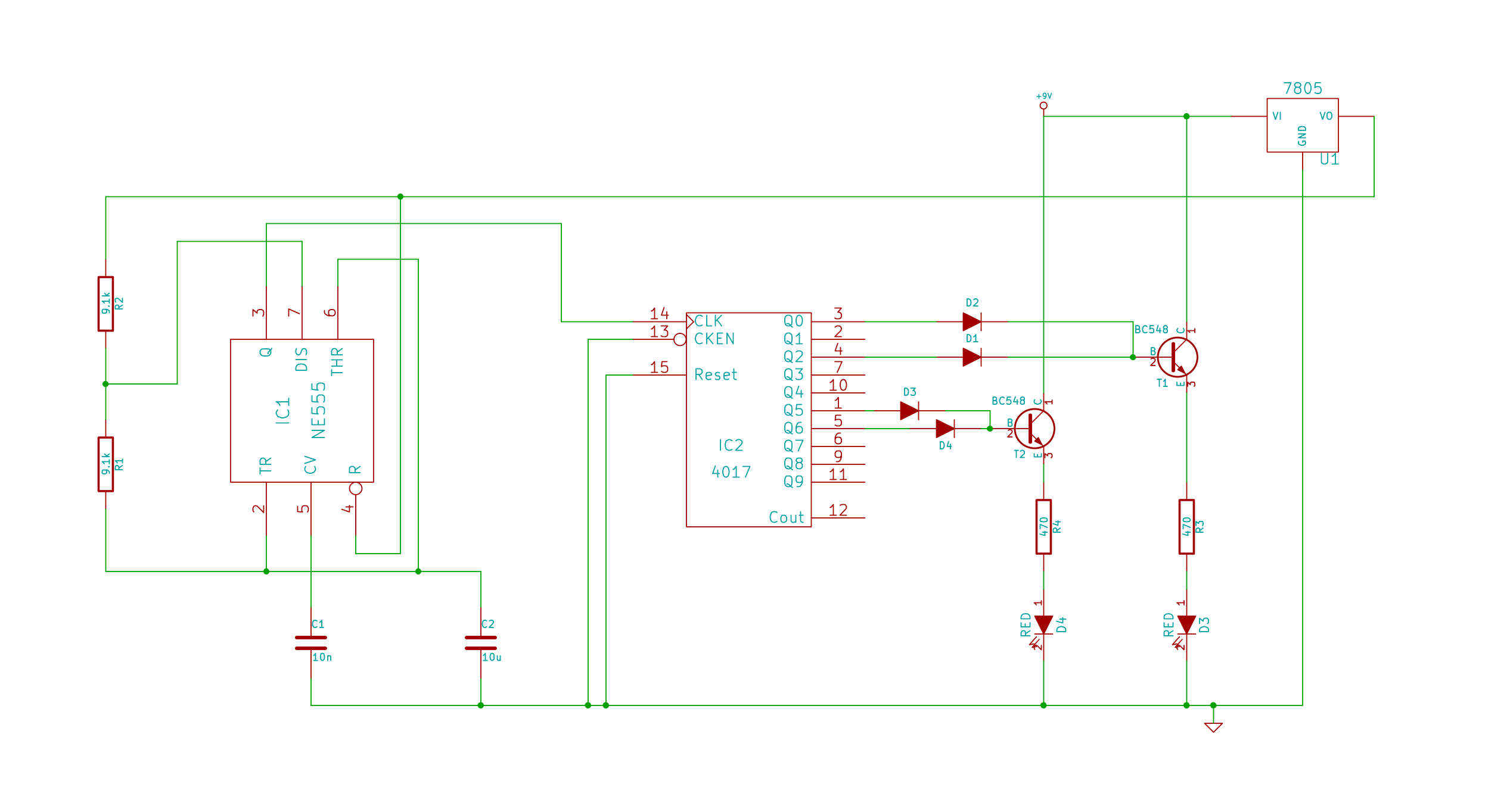

sorry for the lack of updates. There is not too much new to show, but today I got the strobe circuit soldered. And it works! There is just one strange thing with it, when I touch a contact it seems that the ICs are resetted and only one LED blinks. Anyone has an idea why?
Also I got the rest of the parts primed and ready for a layer of silver and white for light blocking. I hope to get a lot done the next weekend.

Post the circuit & I'll take a look.
It's this one here, almost the same as the previous versions but with the 5V voltage regulator in between:
The resistor-LED-packs are of course not directly soldered into the circuit.
Not shown are:
555:
Pin 1 connected with GND
Pin 8 connected with 7805 VO (5V)
What's strange is that even a touch at the 7805's cooling plate makes only LED D4 blinking.
Thank you for helping!

No prob.
Are there filtering caps on the 7805? There should be a 0.1uf at vO & Gnd, & a 0.33uf-0.100uf at vI & Gnd.
What is the current draw of each led array(Led D3 & D4) & where do the 4017's vCC(pin 16) & Gnd(pin 8) land?
Are you running on batteries, or DC power?
The filtering caps are not yet in, didn't have enough of them yesterday. But they are on the list.
The final current draw is not yet determined, but there will be either one or two white LEDs on each, so it would be about 20mA or 40mA each. From all what I read in the data sheet I think the transistors should be able to handle these without a problem!?
4017
pin 16 goes to 7805 VO (5V),
pin 8 is... disconnected. Ok this might be the error. Shame on me... I really shouldn't use these circuit diagram symbols with the basic pins hidden...
The test was done with battery power but I'll switch to a power supply when the components come together (to prevent the voltage drop which was discussed some time ago).
Thank you once again, OD!
Update: The ground connection of 4017's pin 8 solved the problem. Thank you so much, Orbital Drydock!
