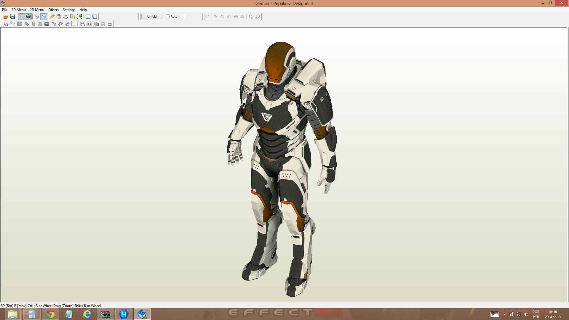

Here's what I meant by the face count and the resolution of the .objs without the textures/material files. They are a great starting point, beats the heck out of scratch-modeling for sure.
GEMINI unedited .OBJ:
Re: [Iron Man 3] 3D models Resource Thread (For reference or Foundation)
The models with textures make for quite an accurate base to model/modify the suits, but yeah, people can't expect to just import these and pep them. They're largely merged into one object, so you can't easily split them to build each piece without work anyway. And a lot of the details just aren't there in anything but texture.

Completely agreed, Blob. FYI, I did also check on the scaling in Pepakura, and they would not need to be rescaled outside of Pepakura to fit a normal person. (The Gemini suit works out in Pepakura to something like 1000 scale to fit a 6' person, unless I goofed the math in my noggin. Not needing to recale in Blender/3DSMAX/etc is kind of a moot point though if you want to make a wearable suit, because as Blob said you'd still have to separate the pieces in your modeling software.
When I import them into 3DS Max scaled to 100x, they work out to 180 units, which if you take it as centimeters, is right on 6ft. That might be complete coincidence, but regardless, it should make for a pretty close starting point.

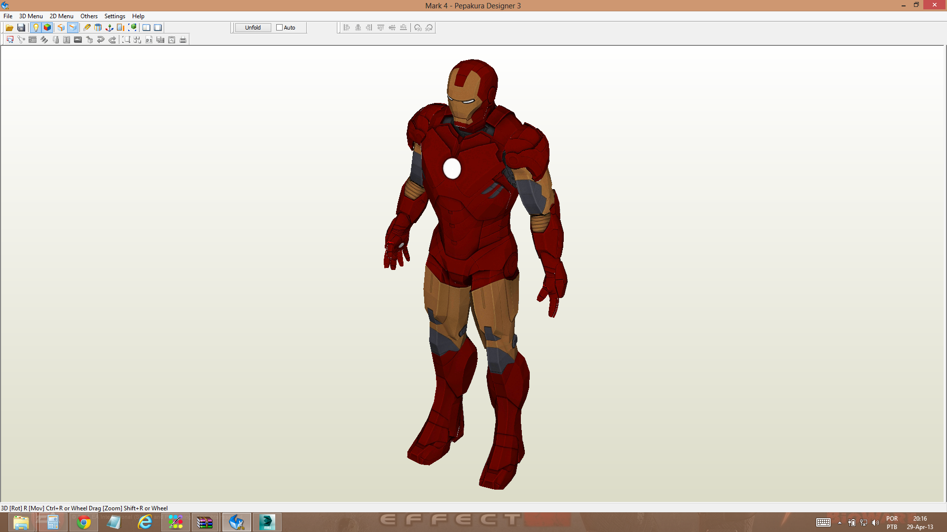

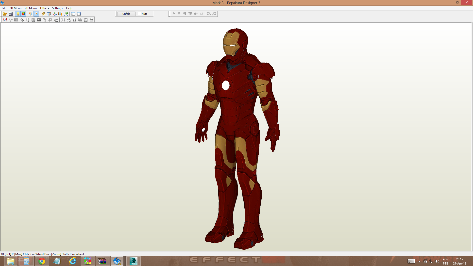

This weekend I was trying to extract models of mobile game iron man 3, I finally managed to extract them.
The models are low-poly but may be useful as a reference or foundation for 3d/Clay modellers, or for those who just want an 1:1 papercraft Iron man:

Personally I think it's just lazy model work on the part of the game's production staff. Even the Mark 3 is lazily textured. But hey, it's still better than nothing at all, right?
