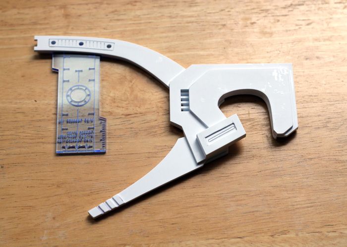

This is my second costume build and the first one I've gotten the courage to document and post. I made a foam Shepard costume for halloween last year and I wanted to add a visor to it before I take it out to the Fan Expo next week (I can't believe it's next week already, I need to stop doing this stuff last minute).
After looking at all the different visors, I decided to do my own interpretation that's sort of a combination of the Kuwashii and sentry visors.

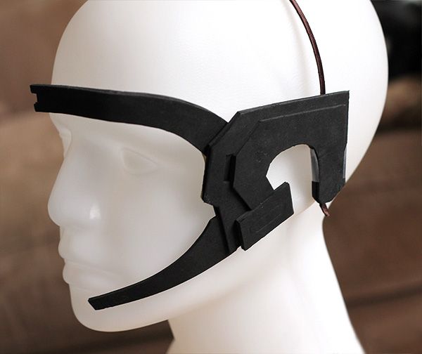

I started with a foam mockup
I've never worked with styrene before, but I thought stacking layers of it would be a good way to tackle this build. This is mostly laser cut 2mm styrene and some thinner bits I cut by hand. I also laser cut the acrylic for the eye piece.. this blue edge glow stuff looks pretty sweet (just not in this photo)
Next up is to heat form the styrene and get the electronics in there. More progress coming soon. Really soon since I have less than a week left :(

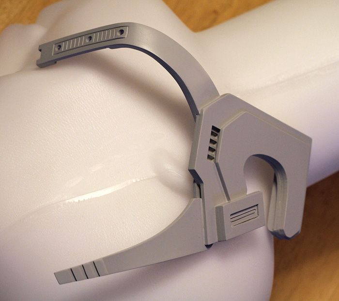

I spent the day heat forming and sanding and sanding some more and finally priming. The harsh curve of the top bit looks nothing like the reference, but that was the only way to get the eye piece to sit parallel to my face and not hit me in the eye. I'd make some adjustments to the shape if I was doing it again...

This looks great! For the acrylic, did you laser etch the details? What did you use to make them blue?
Re: Mass Effect Visor
@Iron Giant Yes, the details are laser etched. The acrylic is fluorescent blue so the etching and edges show up blue
https://www.inventables.com/technologies/fluorescent-blue-acrylic-sheet

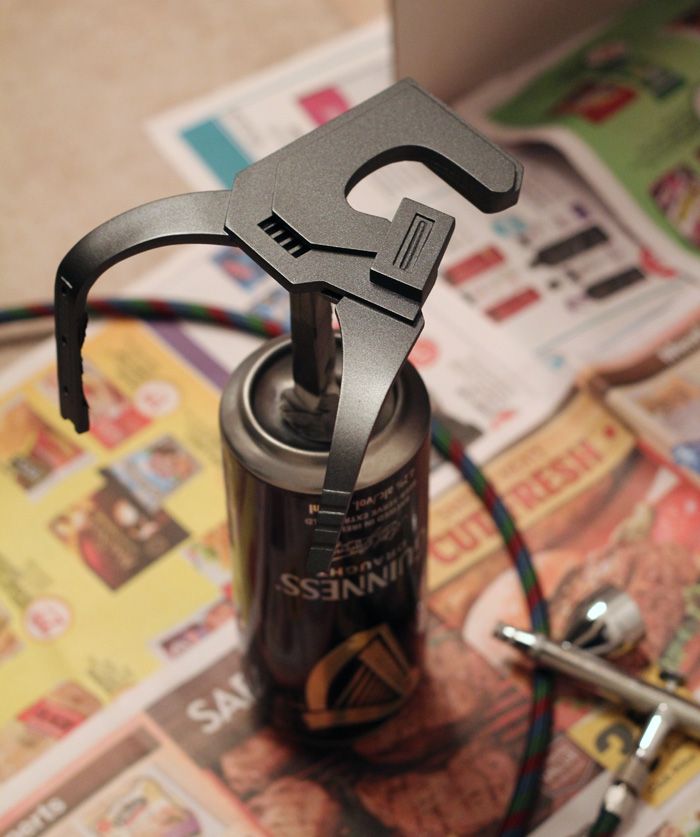

The paint finish turned out rougher than I'd hoped, kind of speckled... still trying to get the hang of the airbrush. The bad news is the acrylic scrapes off the lacquer primer really easily, despite the shop telling me this was the right thing to use. The good news is I can use this to do some weathering and hopefully a clear coat will give it enough protection. As long as I don't headbutt any krogans.

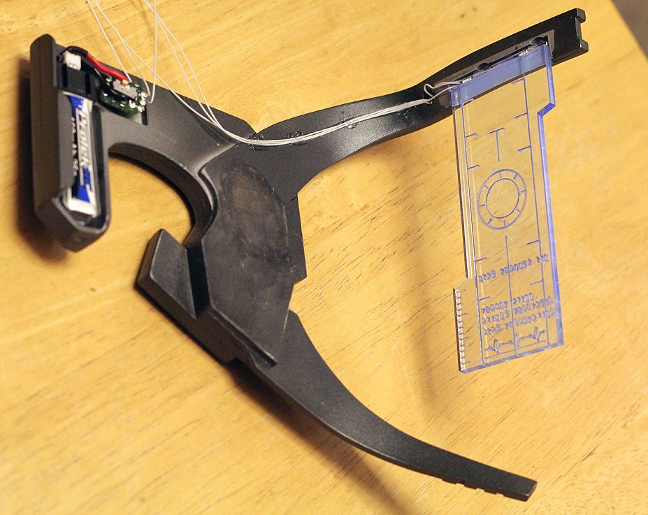

Nearly there! The LEDs are installed, just need to trim the wires down to size. here's a photo before I cover up the LEDs with a thin piece of styrene.

Finished!! I am in love with this acrylic, I just want to make everything out of acrylic and LEDs now.
