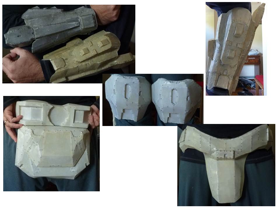

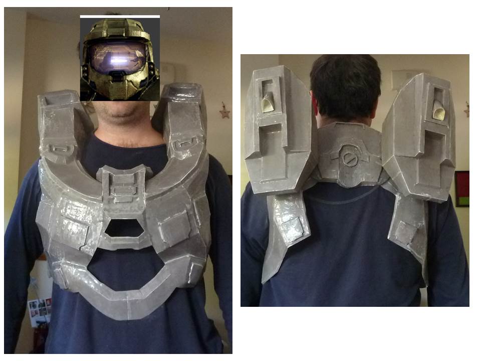

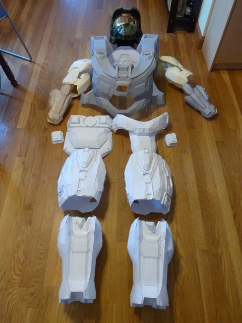

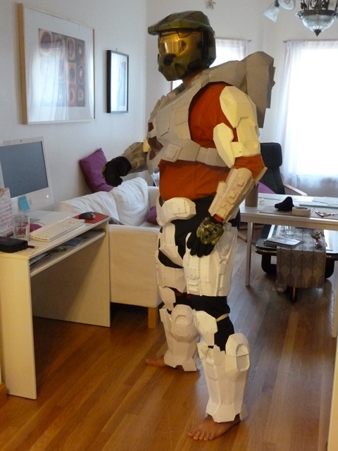

...and also the thighs are done....

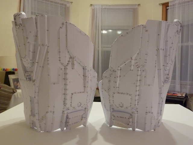

Wow! That's some really nice Pep' work. The detail on the thighs is to die for.
Have you had those pieces finished in card stock long? I pep'd a helmet a week ago, and I keep hearing about how the card stock warps/absorbs water over time, but I haven't seen that happen (It probably helps I'm in SoCal where the weather is generally dry). Are you seeing any warping after leaving your parts un-resined?

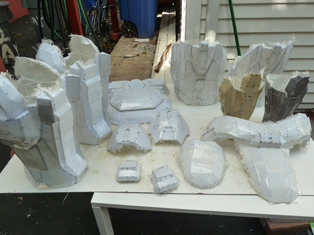

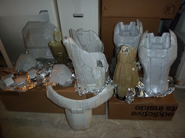

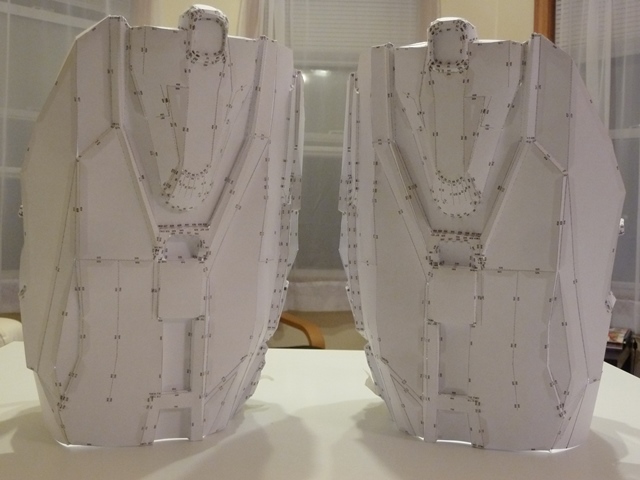

Thanks a lot! I've used the "card stock" paper....and I've just applied the resin, so I can't say now..I'll let you know

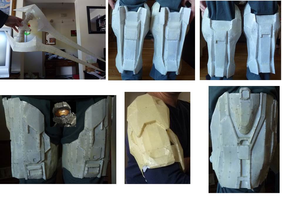

Re: Halo costume
In the meanwhile that I play with resin, fiberglass and bondo, I've also prepared the sword!

Re: Halo costume

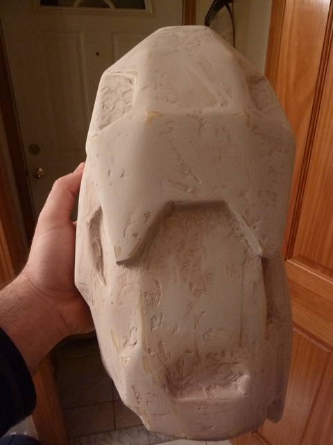

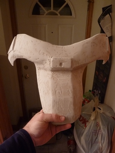

These are two pieces at which I've applied the first coat of bondo, and sand it. This is the result. The question is: since this is my first time, is this a normal, bad, or good result? Are all the holes and imperfections normal or I've applied the bondo wrongly?
Other questions:
I need another coat of bondo, right?
Is there a quicker way? Halloween is coming....
If the armor will not be ready for Halloween (thing that look very likely), is it possible to paint the "not-bondoed" pieces with just the color (no primer), wear it for Halloween, and the bondo the armor over the painting?
Thanks for your help!!!!
