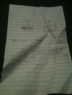

I started with careful planning and drawing up some meticulous blueprints.
I then bought a cheap glue gun, some of that 1cm thick foam floor stuff, drew up some paper templates and got to work.

I started by making a 1 inch high headband from the foam, on which I glued 4 triangles with convex edges that came together to form the dome of the helmet. My measuremnts/planning was not great, so I ended up with a gap at the front where the triangles didn't quite meet (dealt with later) and the dome was a little too big.
WARNING: When you curve thick foam, its interior measurements shrink as the foam on the inside of the curve compresses. You have to allow for this or else you will face an issue I have with my helmet. Its too tight! (I can get my head into it, but it's not comfortable to wear)
