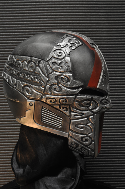

This is the stage I am at currently. I fibreglassed the inside and smoothed (prestoflex polyester fine filler) the outside.
Thank you for any advice!

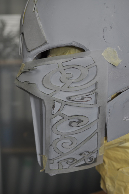

I decided to cover the surface with an individual ornament.

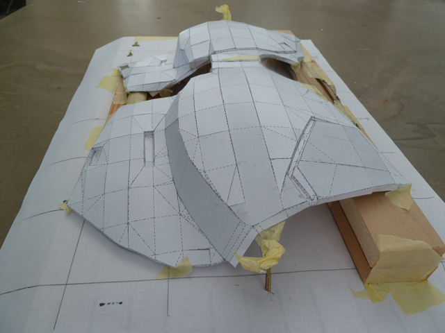

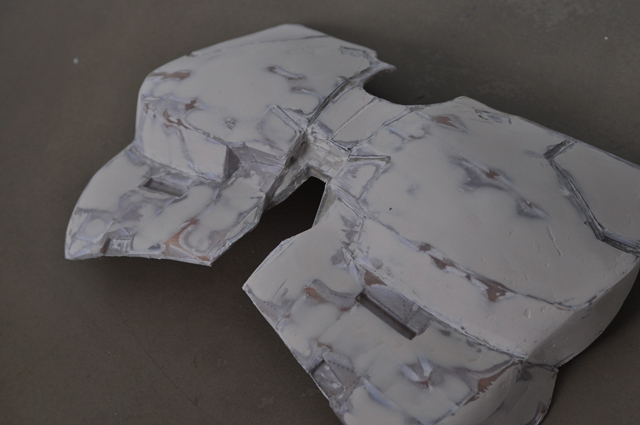

My children helped me so much, because I had to do the chest piece twice. The first version was too wide. Handling the lightsaber with both hands was uncomfortable.
The glueing is done now. It took a bit of time getting the piece fixed, symmetrical and fitting close to my chest.
Somehow I have problems to manage the scaling. How do you get the parts fit well?
Once I have finished the helmet, I became a bit acquainted with the different materials and the working steps: resin, smooth cast, sanding and detail sanding ...

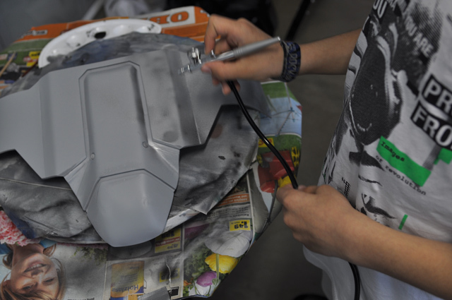

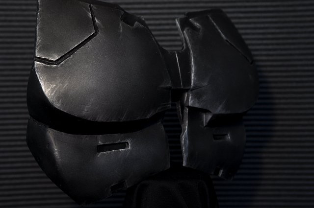

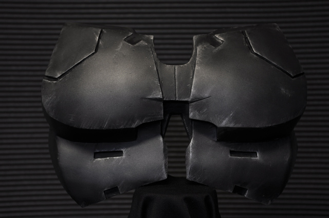

When I tested the color scheme for painting the helmet, I took pleasure in dark colors. Furthermore I like some metallic glowing. Therefore I airbrushed the breast plate in a ferric color at first...
... and made a second, third, fourth layer in flat black. I added several scratches and weathered the plate.
Only a test ...

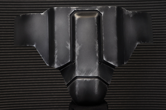

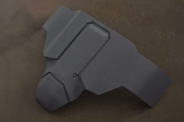

I started building fierfeks Sith-Cod. But then I decided not to resin and fiberglas the piece; the abdomen should be more flexible. So I used the paper model just as a pattern.
I made the whole cod piece out of PVC foam (it is called Guttagliss hobbycolor, grey, 3mm; I can get the plastic sheets from our local hardware store in different sizes).

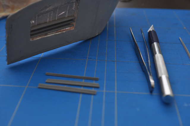

After cutting all the pieces out of the sheet I began to glue and thermoform them.
Next up sanding and filling:
My son gave the cod piece a primer coat in steel (just learning by doing ...).

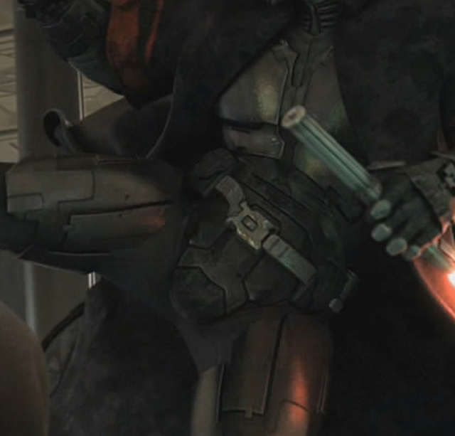

We used this frame from the SWTOR Trailer as reference.
Then I completed the painting with flat black, added several scratches and weathered the cod piece.
WOW! That is AWESOME!!! ABSOLUTELY BEAUTIFUL WORK!!! VERY WELL DONE! The paint job looks GREAT! I CAN'T WAIT to see more! KEEP IT UP!:cool
