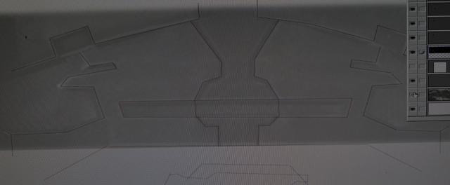

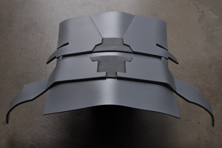

Last week I was able to do just a little bit. I began working out the pattern for the belly plate which is connecting the abdomen with the chest plate. This frame from the SWTOR Trailer again is the best picture I was able to find. I will use it as my reference; I would be pleased if you have any hints for some other pictures!
Some Paintshop work; I only accentuated the contours...

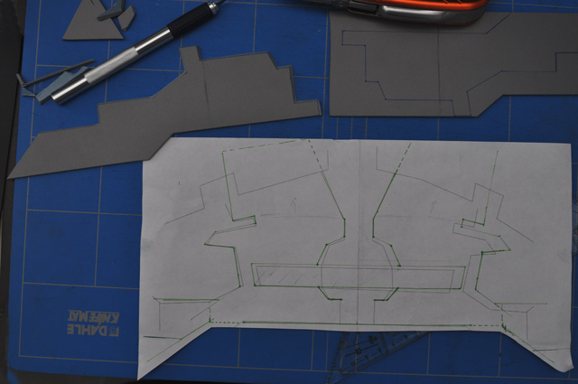

Then I had to adjust the size to my cod piece (green lines)
Somehow I wanted the belly plate to be flexible. I used PVC semi-rigid foam (Guttagliss hobbycolor, grey, 3mm) for the firm parts. I glued them on a pool liner (black, 2mm); it is flexible but it does not slump down (? I hope you can understand what I mean). The small grey parts are flexible, too (1mm foam).

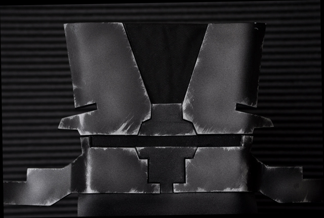

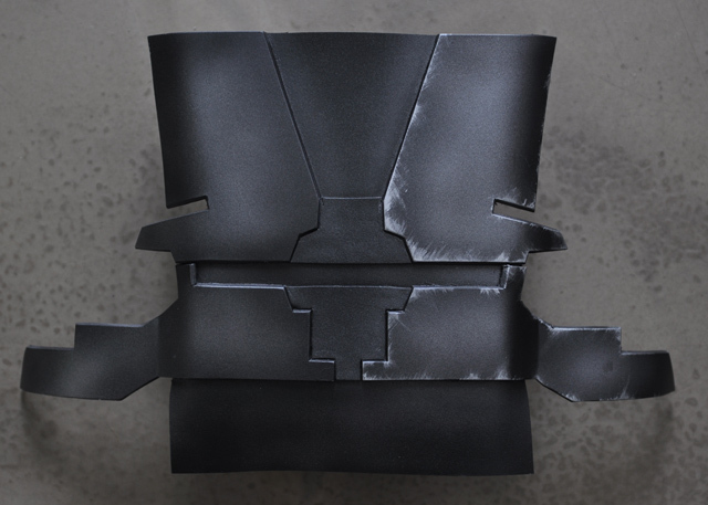

The belly plate is a little bit flexible. I don´t know whether this would be necessary or not; but I have no experience in wearing a suit of armor.
It took some time to get the parts fit closely.

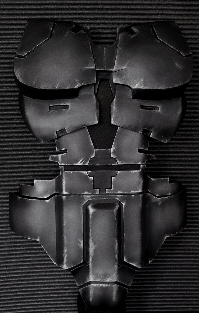

First layer in steel, then several layers air-brushed in flat black and after that the weathering.
Only a test - the fabric between the upper parts.

ABSOLUTELY BEAUTIFUL WORK!!! I LOVE your weathering! VERY WELL DONE!!! The only concern I might have is with the flexibility of the belly plate. Having worn a number of armored costumes myself, flexibility is VERY IMPORTANT with regards to comfort. If you're planning to wear this for prolonged periods of time, at a Convention for example, the ability to bend down, bend over, & even sit is something YOU'RE GOING TO WANT TO CONSIDER! I've got a 501st approved Vader costume that I wear to a lot of events, & the cod piece & armor can often make it EXTREMELY DIFFICULT to bend down to greet a young fan, or even to sit down easily when I need to take a break! It appears that you're armor is made from Sintra, or a similar foam based plastic. Although easy to cut & mold into a lot of different shapes, it's still fairly rigid. You might want to look into some EVA foam matting material or some other similar more flexible material, especially for the belly plate, as your ability to bend in this area is going to be IMPORTANT. Having just said all of that, please don't take what I've just said as a criticism. Your work so far has been SUPERB, & of the HIGHEST QUALITY! I REALLY MEAN THAT! I've been building costumes for a long time, & I'm definitely impressed with the caliber of what you've achieved so far! I can only hope that my own build LOOKS THIS GOOD!!! But, I speak from experience when I say that FLEXIBILITY IS VERY IMPORTANT when it comes to being happy & comfortable while wearing your costume. I think you could make the belly section out of either 1/8" or 1/4" EVA foam, & then coat it with either Plasti-dip or Smooth-On's Smooth Cast 65D. That's what I'm going to use for my build, because it will still give a plastic look, but still be semi-flexible. There's a couple of videos on YouTube you might want to check out. Here they are - XRobots - How To plastic coat foam & expanded polystyrene prop and costume pieces - YouTube and Sith/Jedi Cosplay Armor Tutorial - Chest - YouTube There's also a website that has a written version with pictures of what you'll need if trying the method with the Smooth Cast 65D. Here it is. XRobots.co.uk - Plastic coating your Plastazote / EVA / Polystyrene foam / cardboard props and costumes I believe xrobot even has a thread on here regarding this method. You may be able to do a search to find it if you're interested. There are other options I'm sure besides the 2 I've mentioned that you could use to allow for greater flexibility to the belly plate. Maybe others will have additional suggestions. And what I've said are just that, suggestions. I'm by no means saying that you should redo this section. I almost hate even making that suggestion really. After all, your work thus far is VISUALLY STUNNING, in my opinion! I'm really only thinking of your comfort, or lack there of while wearing the suit! It's all "food for thought" I guess! At any rate, I hope I've given you some HELPFUL suggestions! GOOD LUCK to you! I'm sure whatever you decide to do will be GREAT! Keep up the FANTASTIC WORK, & keep the updates & pics coming! You've really got me PUMPED to get underway on my own build!!!:cool
Upon looking at your pics & descriptions more closely, I see that you actually do have a flexible material behind your belly piece, & part of your chest piece. For some reason, I didn't notice this initially when I read your last post, & looked at your pics. Actually, when I looked back at your post on the previous page, I saw the process you used, which by the way is QUITE CLEVER! That definitely should provide some extra needed flexibility in those areas. You're DEFINITELY going to want flexibility in the belly area. Will what you've done be enough? I don't honestly know. I would test everything out once you get the whole thing done, & make whatever adjustments are needed from there. You actually may not know how restrictive or not everything is until you've worn it at an event. That always works for me when testing out a new costume. It sometimes takes a few wearings to get the "bugs" worked out of a costume. From there, you simply modify the design to make it more comfortable to wear. Unfortunately the designs of some of the characters we love don't work as well in the real world as we'd like. All in all though, you've done an OUTSTANDING JOB so far!!! I CAN'T WAIT TO SEE MORE!!! As Lord Vader would say - "IMPRESSIVE! MOST IMPRESSIVE!!!":cool

Yes, I agree! As I have no experience in wearing such an armored costume, there was just some feeling that flexibility might be relevant. Although the belly plate is relative small and unimposing, I puzzled over the part a long time. As you say:"Unfortunately the designs of some of the characters we love don't work as well in the real world as we'd like." I think after SW CEII (end of July:facepalm) the belly plate will be definitively one thing, I will have to reconstruct. I checked out the YouTube links: Plastic coating foam - that looks absolutely fantastic! I think your armor will be great!! And then we will storm that Jedi temple!

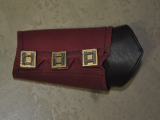

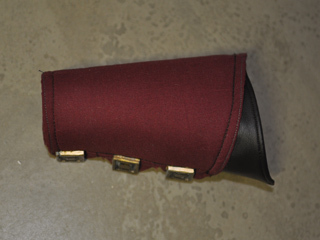

But first I want to make good on a promise, I made to my daughter: She asked me to do her Ahsoka Tano gauntlets at first.
I decided to cover a sheet of EVA foam (2mm) with her dark red fabric. The foam gave some firmness to the gauntlet, even so it is soft enough not to hurt her.

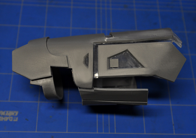

As I made my girls gauntlets, I had got the idea to build the Acolyt gauntlets in the same way: Usinge one material to give the gauntlets their form and then covering it with an other one. Especially I hope this will help me to speed up...

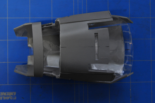

I used fierfek´s pepakura files like a pattern. I decided to use hobbyglas (Guttagliss, 1,5mm), which I can get from my local hardware store.
About two hours later I had the part got sewed out and thermoformed (120°C, heatgun).
Next up I cut out the covering panels and adapted them by heating.
Step by step I glued the covering panels on the hobbyglas layer.
So far, so good...
