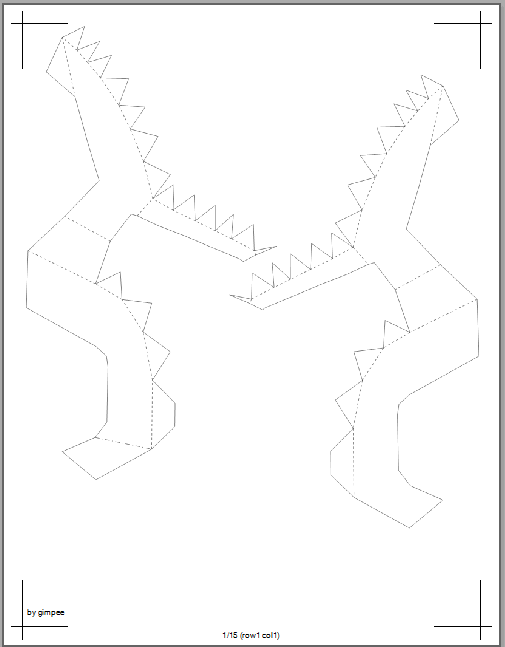

I was starting the mark 42 helmet and was wondering does anyone know what causes these weird edge borders when I printed it?
Any help will be much appreciated!
In the "Print and Paper Settings" option, do you have the "Print alignment marks for multiple pages" checked?

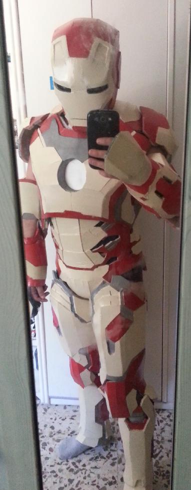

It is my first draft foam thank you for all that you take the trouble to create them ,i am still completing but i hope that they like.
