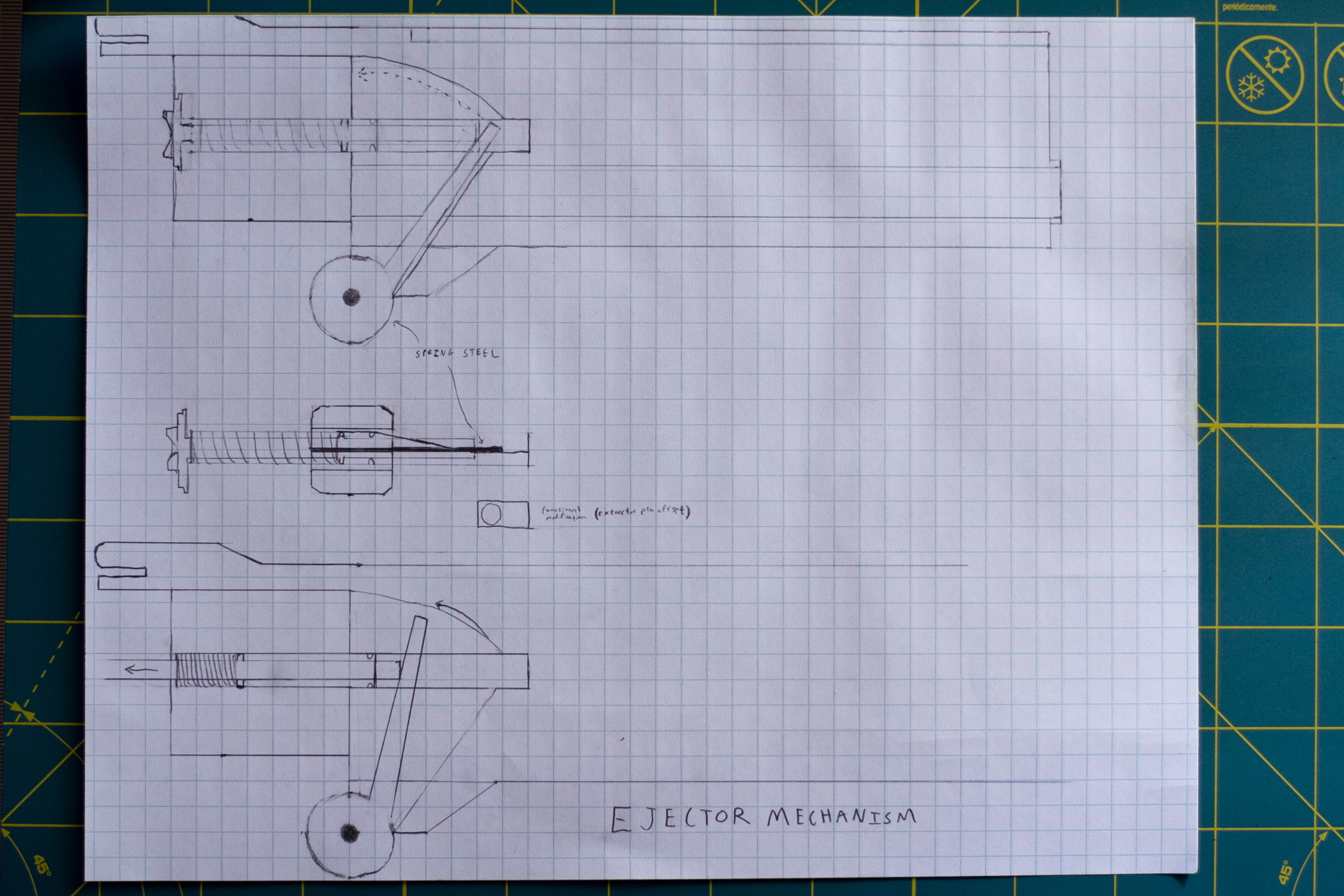

For months, the main thing keeping me from finishing Vash's revolver was figuring out how to incorporate a working auto-ejector to fling out empty cartridges. I originally hoped to use the relatively simple design that every other auto-ejecting gun uses. The problem with putting an auto-ejector in this gun, however, is that due to the barrel being inverted, the center of the cylinder where the ejector pin has to be is a full inch higher than it would be on a normal top-break revolver, which makes the standard design impossible.
So I did some R&D, math, etc. and I finally developed a working auto-ejector:
Basically, it's a spring steel lever that pushes the ejector pin out from the bottom until the pin is fully extended. By this time, the lever has hit the side of the outer tube that holds the ejector pin. The tube is cut at an angle, so it pushes the lever to the side until it is no longer pressing the ejector pin out of the cylinder. The inner spring snaps back to its resting position, and the ejector snaps back into place. When the gun is closed again, a coiled spring at the hinge pulls the spring-steel lever back into its resting position at the end of the ejector pin, where it snaps back into place, resetting the mechanism.
(If you can't tell, I'm kind of proud of it :D )
Anyway, now that this part is designed, all I have to do is find the time and space to start putting the pieces together!

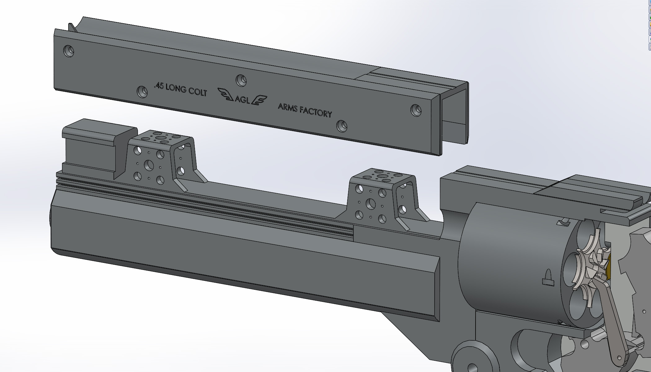

I've been learning solidworks for the past couple months, and I decided it would be far easier (and more repeatable if/when it becomes kit time) to start with a fully detailed 3D assembly and print everything as individual parts that can then be cleaned, molded, and cast.
Let me tell you, I've learned more about CAD software working on this than I'd ever have imagined.

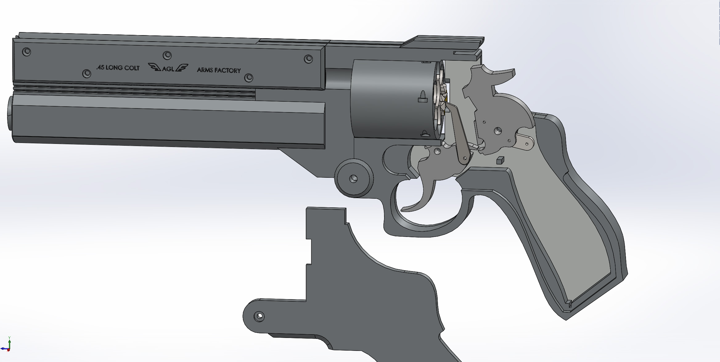

Anywho, the basic frame as I drew in my original schematic is done, and now I'm adding details. I'd say it's about halfway done:
...and with the side panel open:
There's still a lot to go before it's ready for printing (grips, quarter-dome blast guard things, finishing the trigger guard, and misc. details like fixing the placeholder text/ Eagle Arms Factory logo), but I'm excited at how good it looks already.

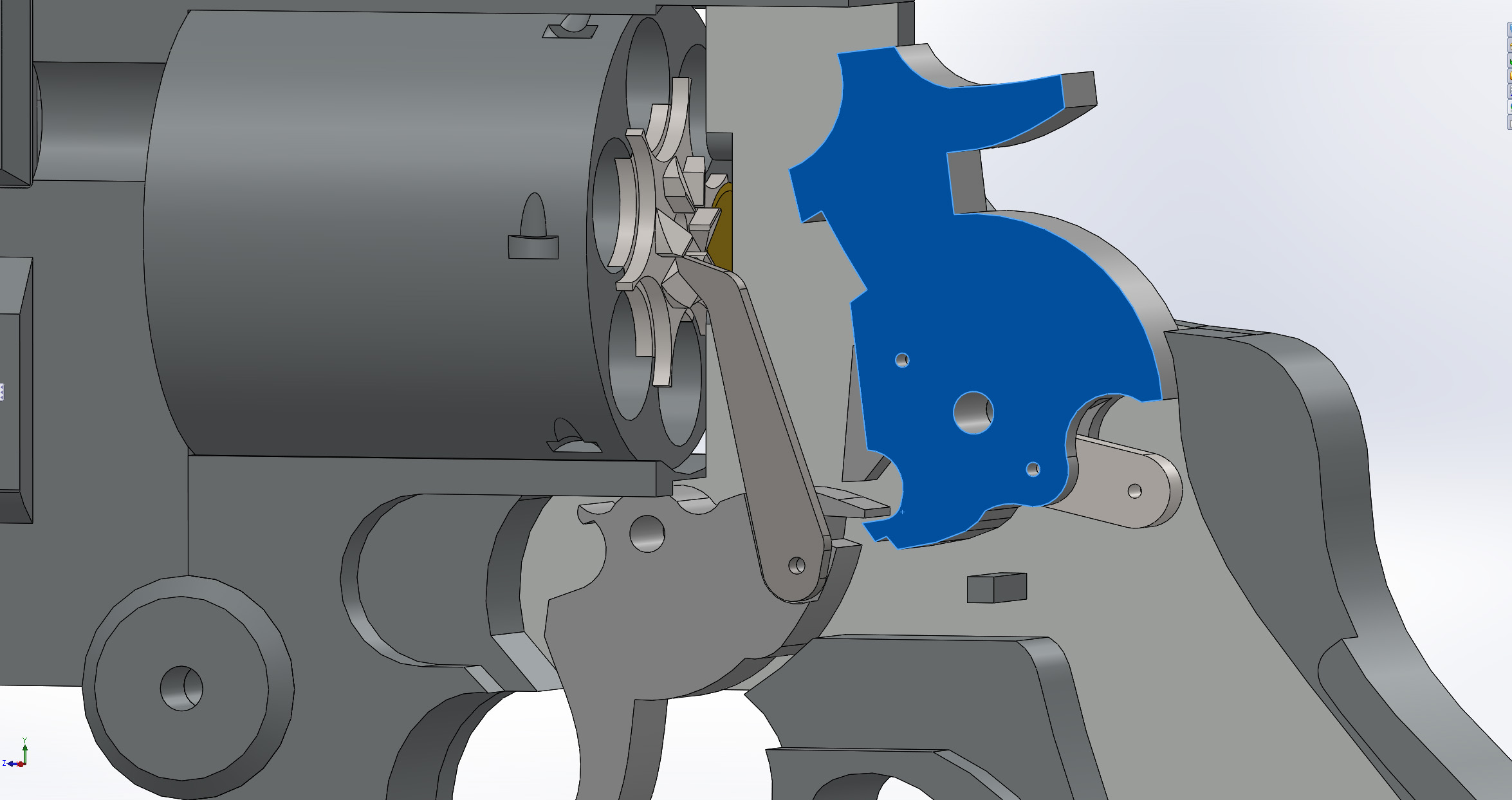

Plus, I figured out how to do motion simulation, so I finally got this working:
..which means the trigger will actually do what it's supposed to and turn the cylinder as it cocks, which can be done either with the hammer or double-action style by just pulling hard on the trigger. It sure beats having to use an old airsoft gun like the Japanese kits did. (Even the 'official' kit with its own fiddly bits didn't spin the cylinder, IIRC)
There's enough room left over to put in a reversing lever so the hammer could actually trigger a firing pin down at the bottom of the cylinder, but I'm debating whether or not to put it in, since this is primarily going to be a prop for conventions.

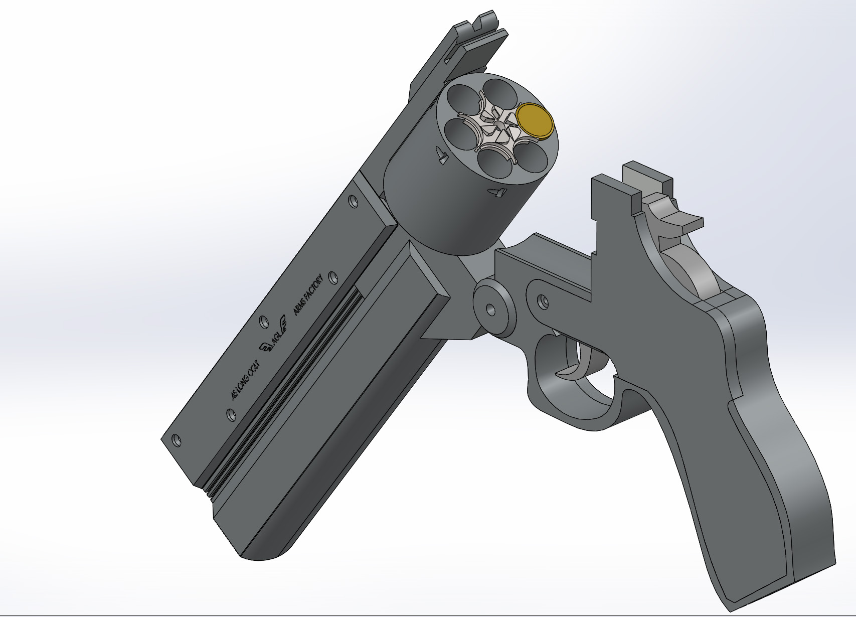

Of course it also has some break-action goodness, and I'm currently designing a more practical auto-ejector system (possibly using a mini actuator):
