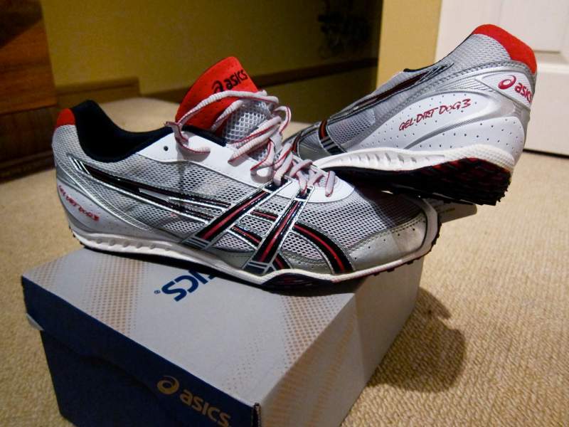

This is awesome, I'm in almost the same situation where I've made a few costumes by collecting pre-made pieces and now I'm tackling the ASM suit. I've got my shoes, and my print should be arriving any time now.
I'm sure you and I will have some of the same questions as we build so I'd love to share questions, ideas, solutions on the topic. I'll be watching!
Re: MrBibou's Amazing Spider-man, with McLean's print - 01/16 starting with the shoes
