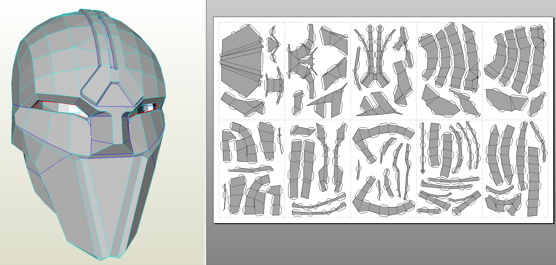

I have been working on a sith acolyte model. (Download Link below my blah blah)

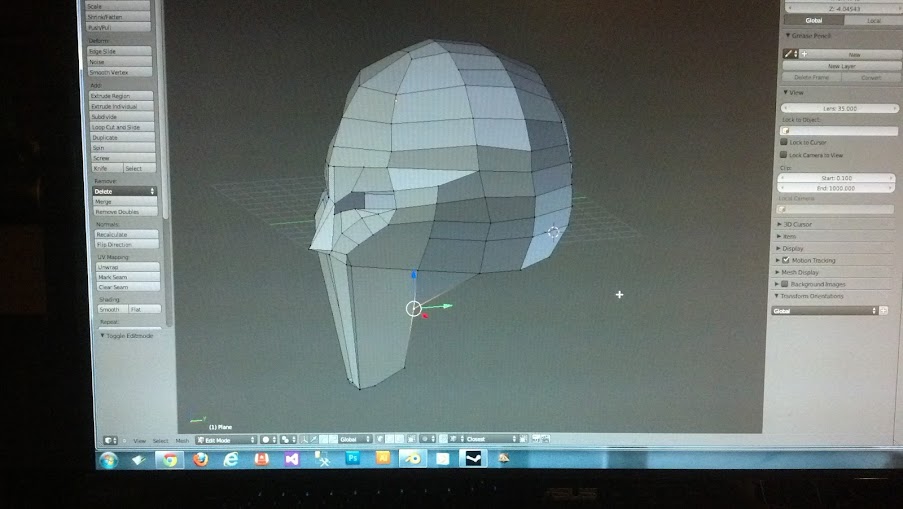

So I started in blender and traced the frontal outline of some others I've seen around..
Then unfolded it...
The only thing I forgot to fix was part of the eyes. Easy enough to glue on after the fact (notice the corners on the outer part of the eye.
Anyways.. process involved two prototypes.. this is the one I'm using...
Download the pdo here

Blend posted on my personal domain at: http://www.clickmatch.com/drop/sith acolyte.blend
Ha, just am realizing my folds are all backwards.. need to invert it, but I've already printed.. so looks like my lines will be on the inside.. lol
Boo I guess I can't flip the folds unless I undo unfold and re-org.. so looks like it's staying this way... lines and numbers on the inside...
