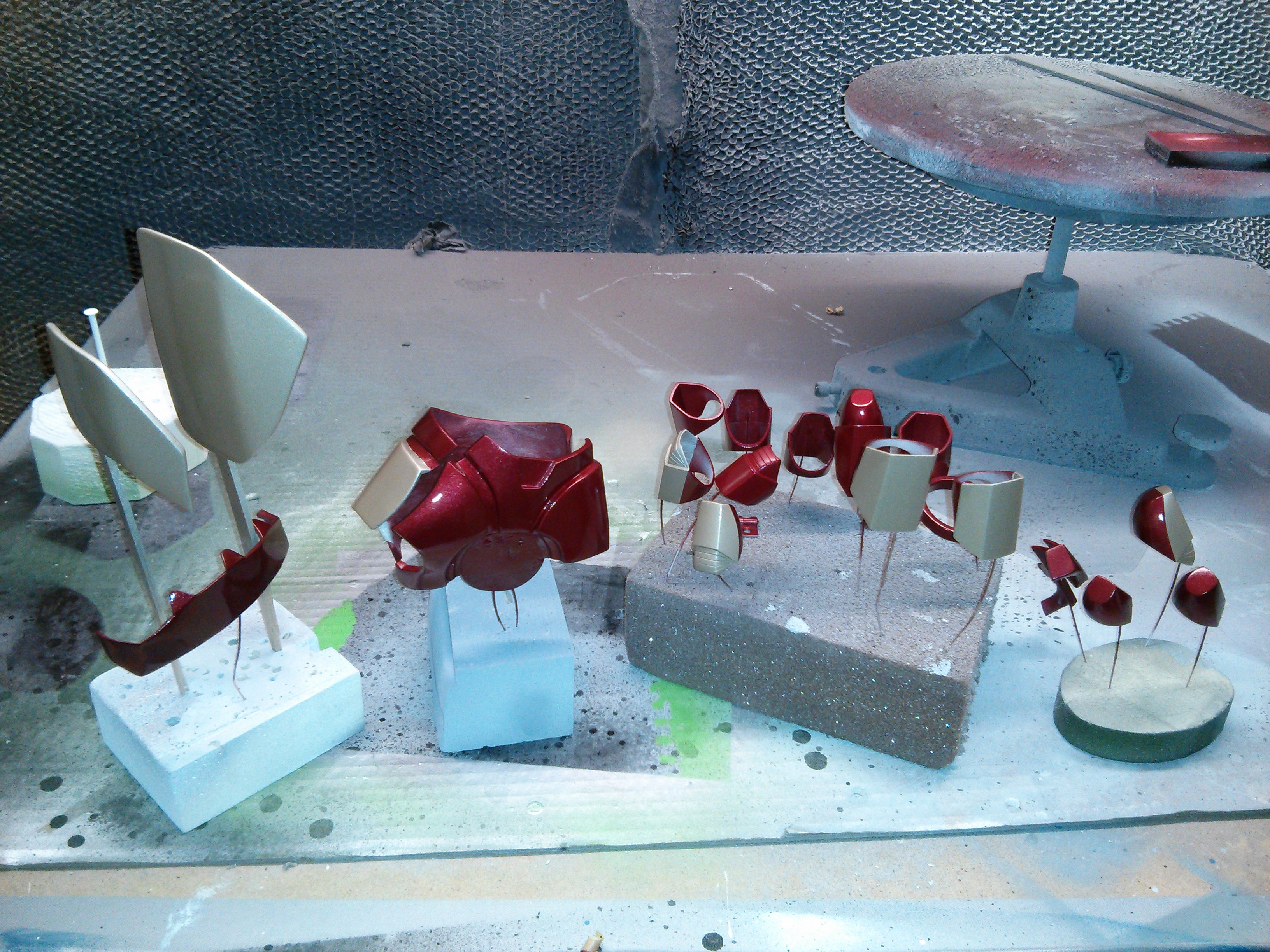

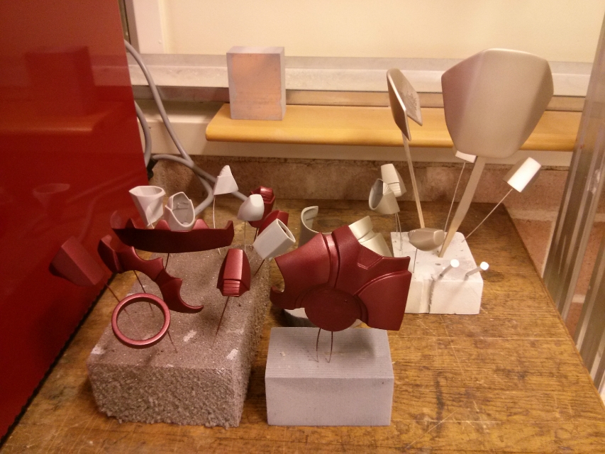

Some progress;
The gold and most of the red has been painted. Hopefully I'll finish the rest tomorrow.
I've also found a suitable inner glove material. A thin sheet of Dragon Skin 10 brushed onto a ribbed plate as a mold and then sewn onto a regular glove.
Works a lot better than my previous ones which were way too thick to fit inside the fingers, or even move the fingers freely. And it doesn't look too shabby either...

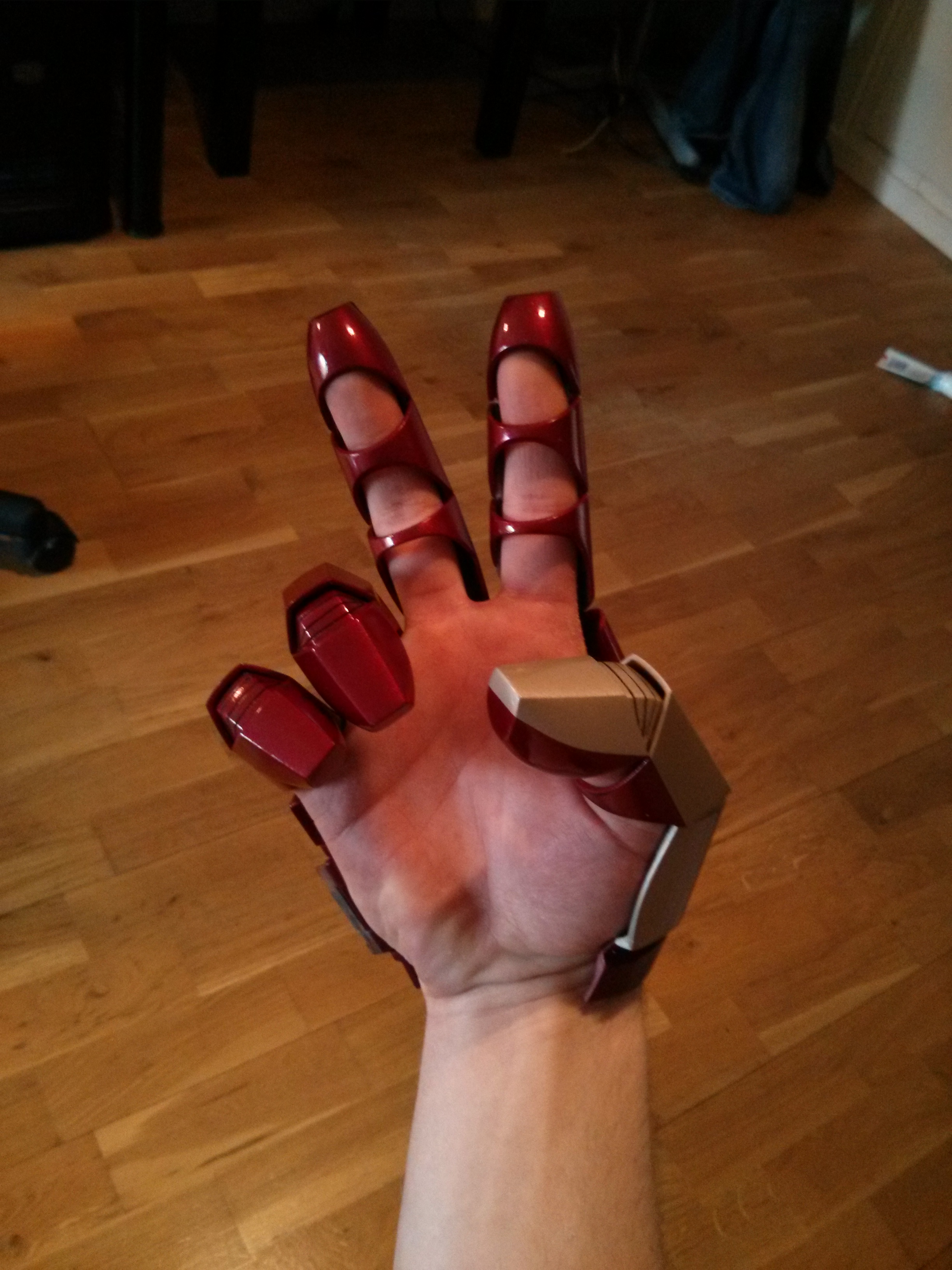

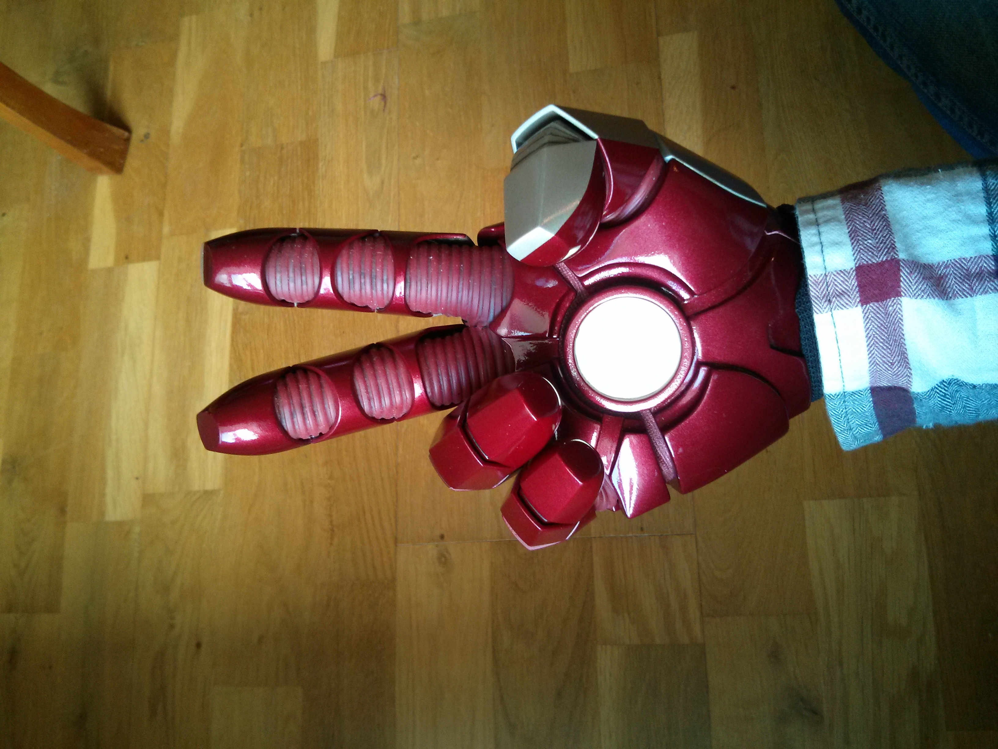

Fingers assembled using fishing cord and epoxy. And some black wash on the joint panels to give it some contrast.
IMG_20130424_013452.jpgIMG_20130424_013700.jpgIMG_20130424_145303.jpgIMG_20130424_013524.jpg

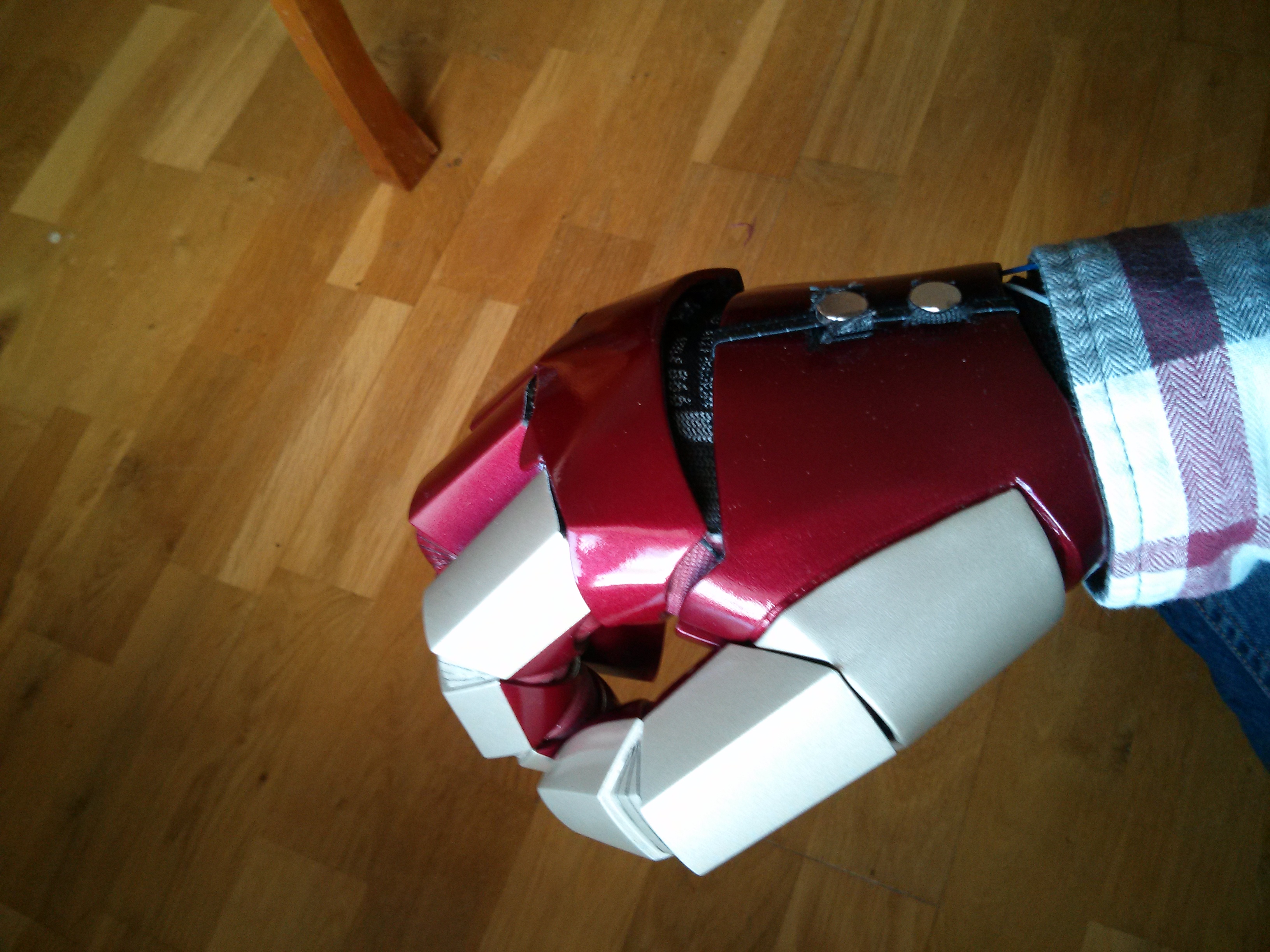

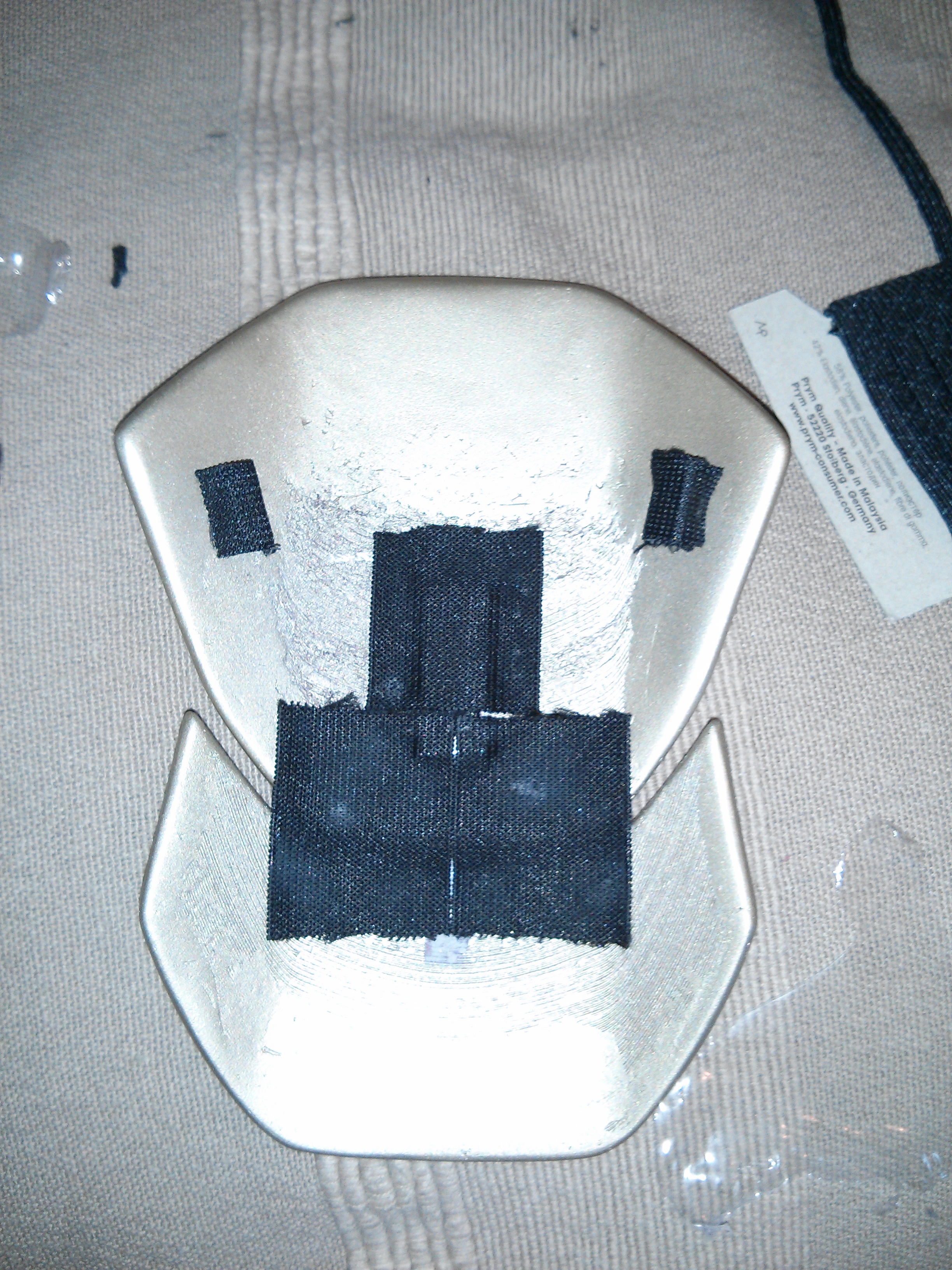

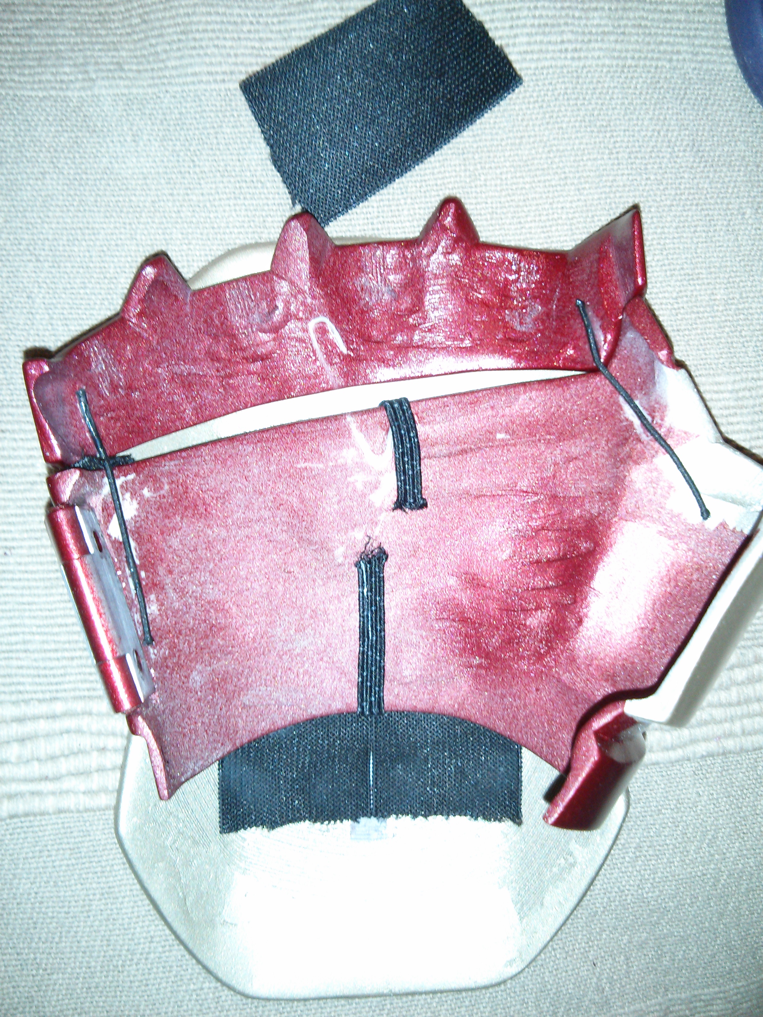

To mount the cover plates, I glued a couple of magnets on a piece of elastic and wrapped it around the top part of the glove. As it's glued on the inside I can remove it without damaging the paint. The plates are connected to each other using elastics (I have way too much elastics lying around and will be using it a lot, you have been warned) and the top one also have a steel plate glued to it for attaching it to the glove.
Fingers attached using... Can you guess?? :p

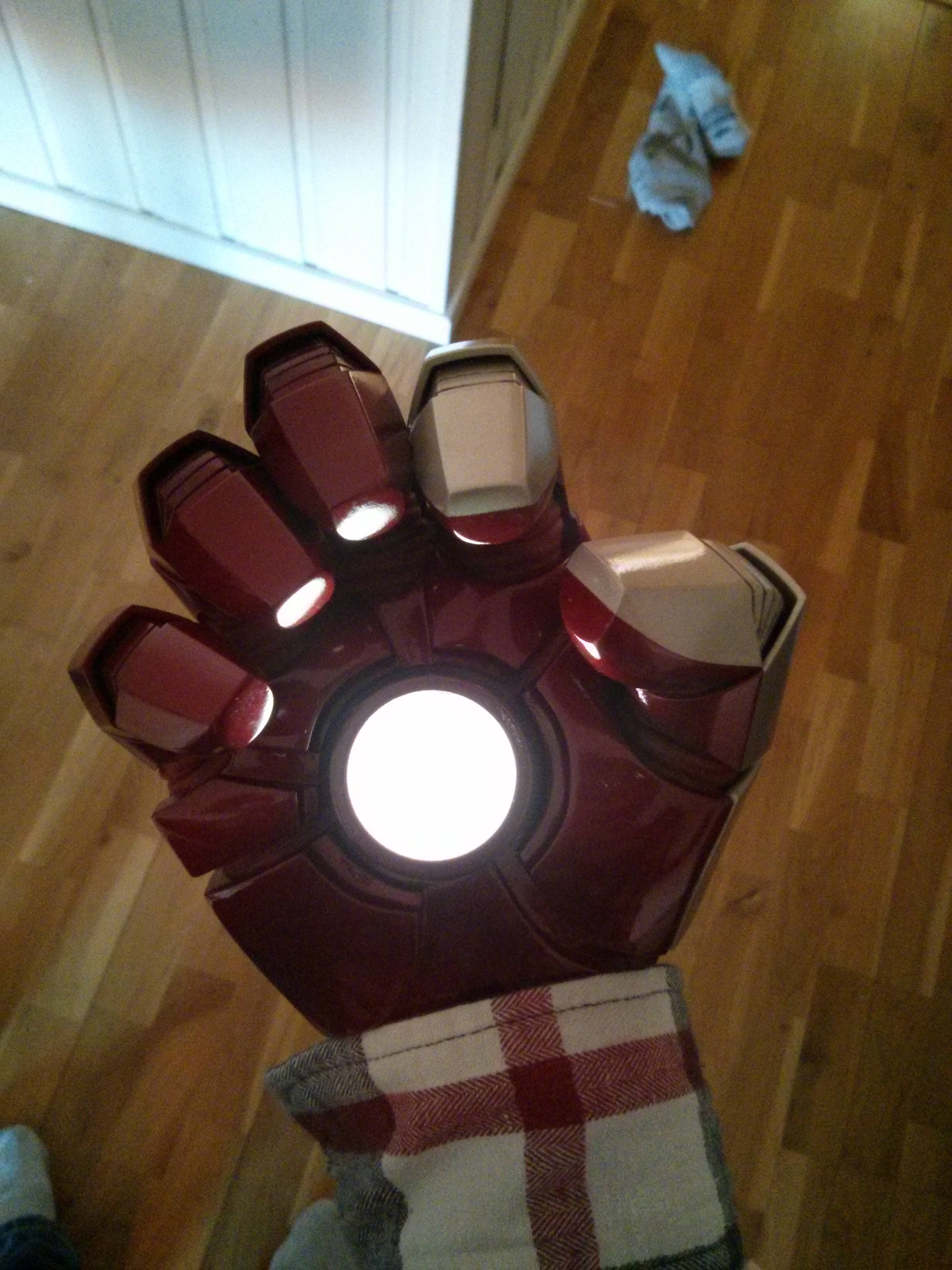

There we go!

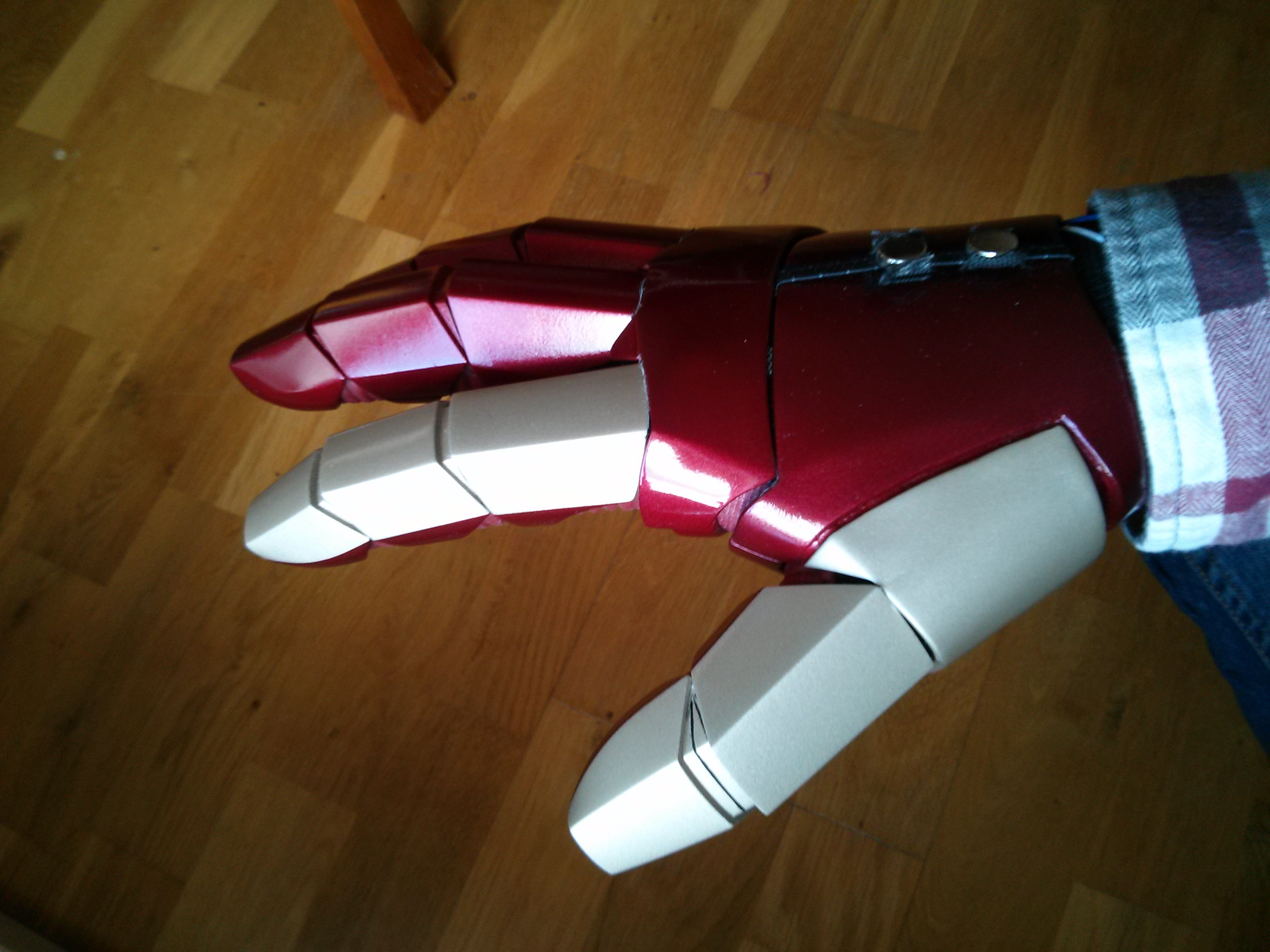

Finished the last details less than an hour before before I had to go, but it's done :D

They are joined by a hinge on the pinky side of the hand, much like the prop gloves. The lock on the other side is a strap with a magnet attached to it that just snaps on to a steel plate when you close it up.
