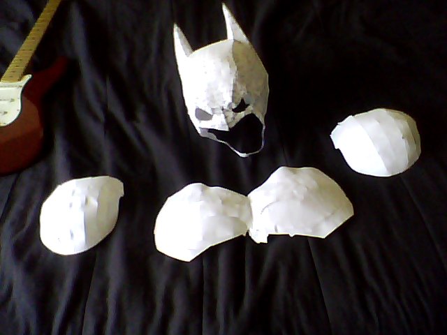

I´m making a DK suit for halloween 2013, all pepakura and foam, just an undersuit below the armor. This is the process since 2 weeks ago. Full Progress.JPG

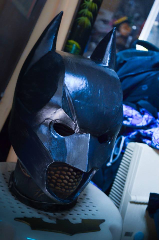

Here's what I got so far..
I used 5mm thick Foam and Coat it with Wood glue to hide the Cuts and Lines
Thank you very much again! :D

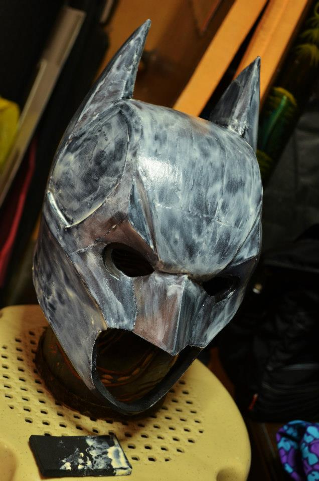

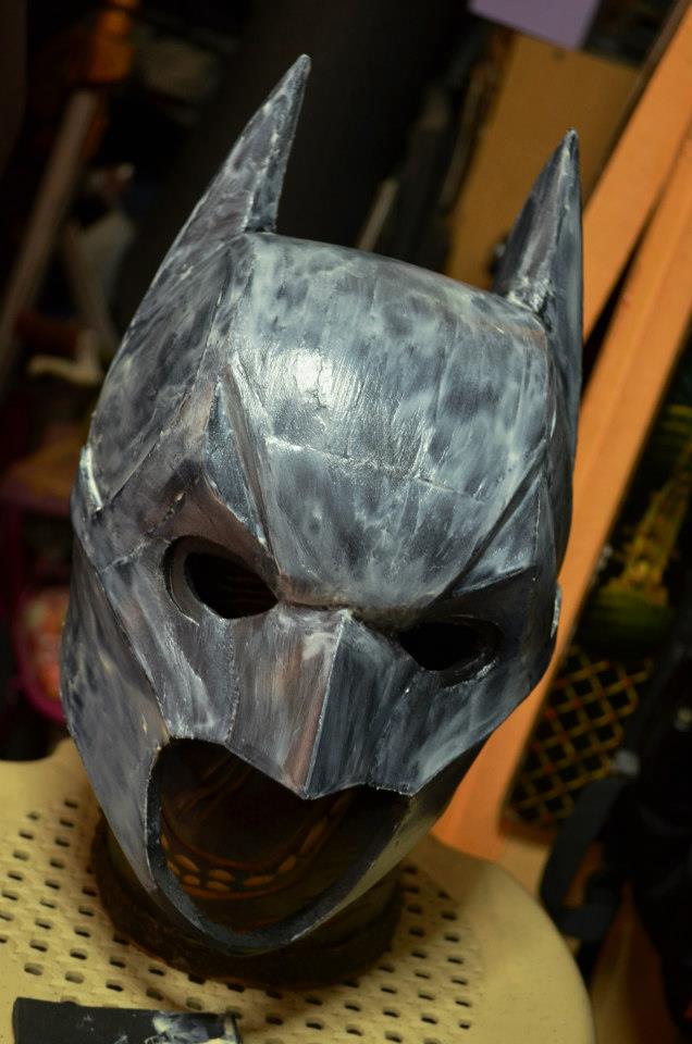

Anyways... Here's what I got so far...
Just plain black base paint.. Will definitely go to our local hardware store to buy some Spray Paints this weekend..

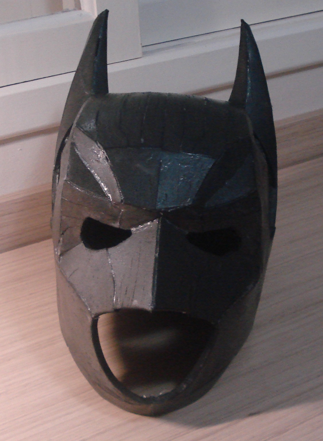

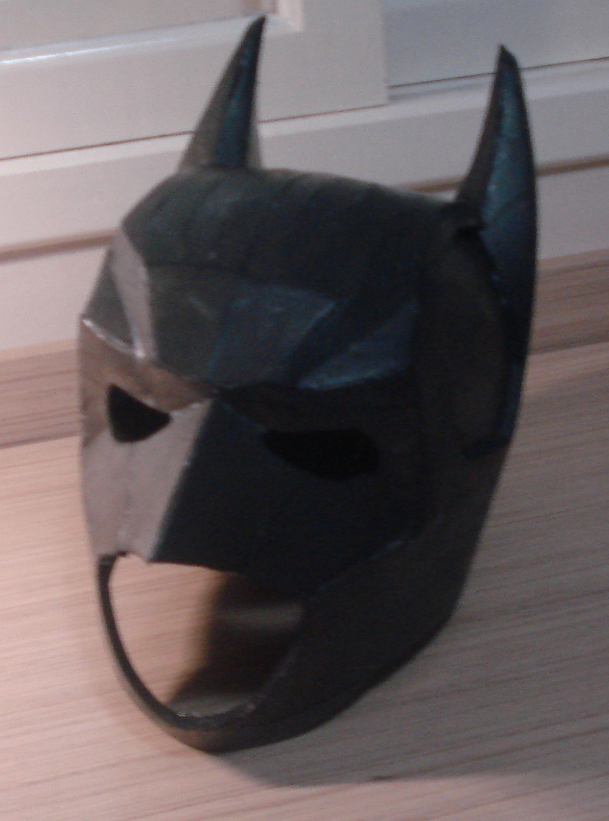

Hi! I just tried my build, heavily inspired by the work of Random490 and Celtic0130. My WIP pics are below, one coat of PVA until now.
Thanks to ruze789 (model) and EyeofSauron (foam unfold) for helping a dream come true!

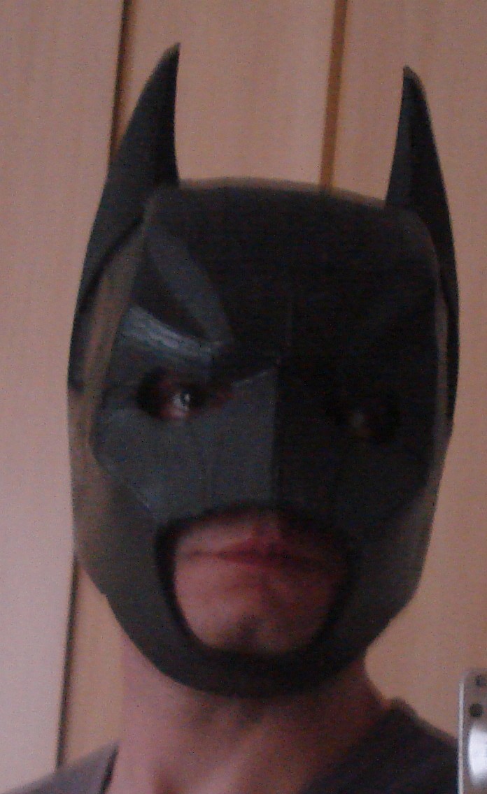

Some notes about this build which were important to me:
- After building, adjust in the eyes area were needed;
- I found a way to let the back part with a more round shape. Do a triangular cut, as shown below. How much you will cut depends on you. I've cut more or less as much as shown. I started with a narrow cut, and then I was cutting wider pieces until be satisfied with the result;
- no velcro, no nothing. The build is somewhat tight to put, and even then there was some gaps inside. I glued some pieces of foam in the gaps and ta-da! It's firm in the place;
- a very important thing. May be the most important. The piece under the nose. That one which covers your nostrils. I've put it. And it gives quite an enhancement in the look! In some days I'll post pics wearing it. Make it harder to breath? Not that much. And as bonus, it's easier to make that "Where's the trigger?!!? WHERE IS IT??" voice.
