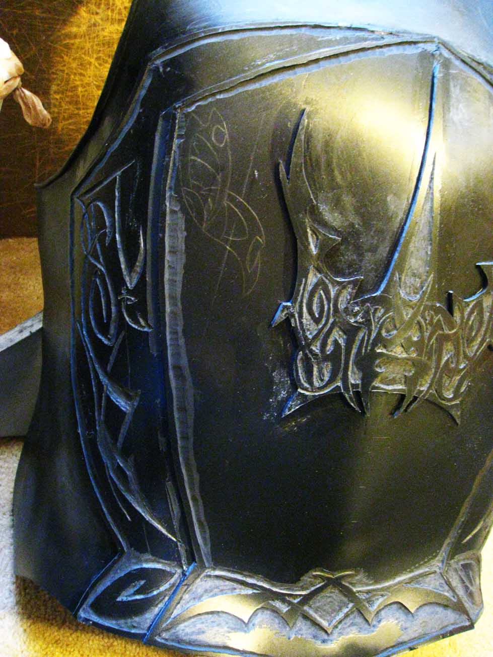

1) Carving the designs into the PVC – I’m assuming you used wood carving tools? It’s been several years since I’ve touch wood carving – what types did you find the most useful for those white designs?

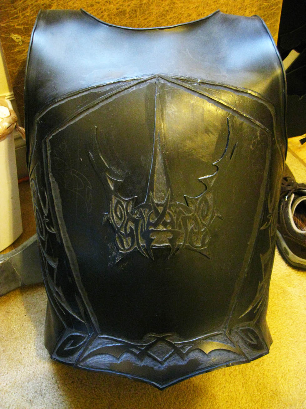

2) How exactly did you mold the chestplate? Did you use a body cast? The portion in particular that I’m most interested in is the bottom lip of the chest plat – the bottom few inches that creases in towards the body and back out…I’ve read PVC board doesn’t do to well with those types of curves, so I’m curious to see how you handled it (and if there’s a method you think would help make the crease more defined). I’m wondering if modeling the chestplate in foam or clay – and then vacu-forming over it with sintra would be ideal.

1. I actually mostly use my rotary tool or Dremel(brand name). Dremel has bits that are made for carving, sanding and etching. It will say on the package. If you want me to list their numbers I can. I would at some point like to use wood carving tools.. but I did ok with the rotary tool. It can get a little unwieldy if you don't have a steady hand. I generally us my thumb as my guide when moving it around. Just remember to create a pattern for the etching and get it the correct size to fit before drawing it on the plastic. You can use a lead pencil and eraser, but like any lead pencil when you rub you hand over something repeatedly can can smear it or rub it off. Not as much as chalk, but you may have to go back an touch it up as you are carving.
There is a bit by Dremel they make in 4 different sizes so you can carve from big to tiny etchings. Just realize you have to go back and use sand paper to smooth out the inside of the carving. Some times the dremel can leave it rough. I use a brush attachment that Dremel makes for polishing and then go back with sandpaper.

2. I used a mannequin I have as an anvil.. just like metal smiths use anvils. Now since I've had enough experience with messing with the pvc I can gauge how much pressure to put where. But I recently made a pieces with a hard edge in the center to lay on the mannequin to help with the roundness of the front of the chest. It's not quite right but it is getting there. I really need to make a wooden buck in the shape of the chest to get a more specifically defined shape. Wooden bucks or bucks made of other materials are used in vacuum forming.. but my vacuum former will not work with something that big.
I generally like to cut out a pattern for the chest plate then cut the pvc from it and then heat and form onto the chest. Again since I have a mannequin that muscles in it.. I don't press down in the muscles since that is not what this time of armor is. I mostly get it to curve around the the chest. With pvc forming that size you worry about the center first. The edges can be done with a heat gun. I prefer my oven for the largest porting.. then heat gun for the edges.
Now you have treat the plastic like you are folding paper when you do curves like the neck and shoulder holes and forms like the shoulder and breast. Paper crumples when you try to wrap it around something like a curve. Plastic acts the same way unless you leave space and push it with your hand. If you are vacuum forming or thermo-forming.. you don't have to worry about this because it's pressure and stretching. But when doing by hand… you sometimes have to leave excess and mold the form first, then remove it or add in a cut in. (removal of a small piece to help with pushing the curving.)

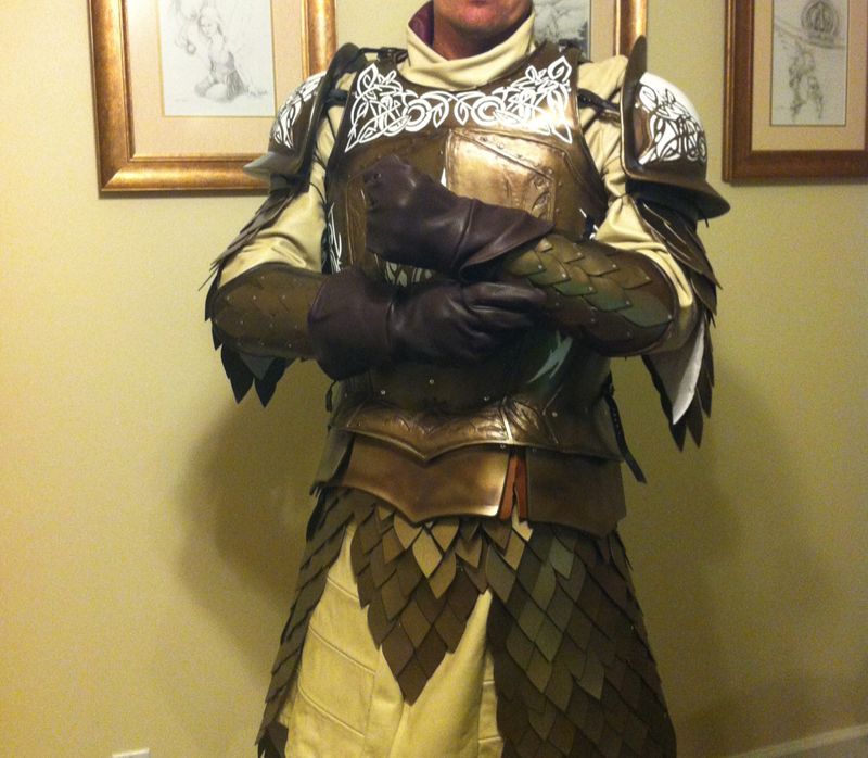

I forgot to post some pics of a few people who've gotten Kings Guard armor from me. Well.. here they are.
Lucas is in Hawaii and hopes to get a photo shoot soon with the armor.
He likes looking at the armor in his office. =)
Brian opted to get the scales from theringlord , but it still came out great. I know my paint jobs are getting good when they almost match up with the actual metal. =) And yes these were at Dragoncon.

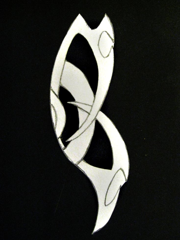

Here are a couple updates I did on patterns. There is light detail on the chest piece I forgot to post those on here. A friend helped me tweak it thankfully. I know my center piece isn't exact… but I am fixing that. I have one with a little more curve to it and fixing a swirly connection.

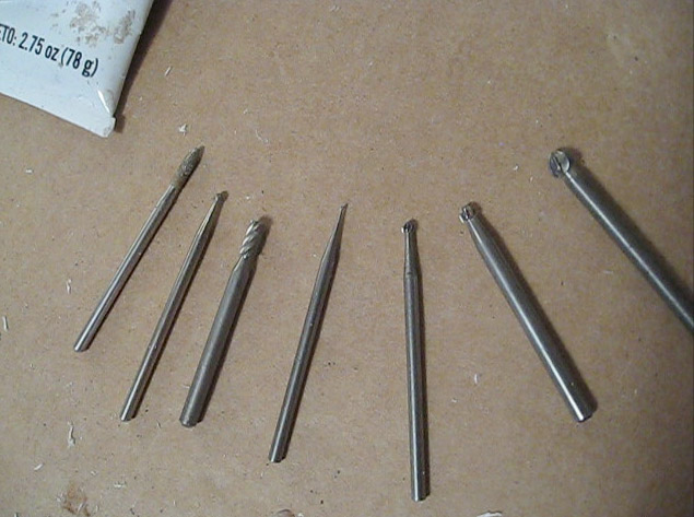

And FuzzyDrawings asked me bits I use for carving my detail with my rotary tool. I don't have the booklets with the numbers on them.. but here is a pic.
