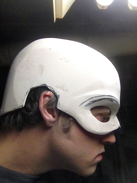

I too have just started foam fabrication, and this was my first attempt. One thing I found is that the helmet was a little tight. I then realized since I have a very average head size that something must be off. It dawned on me that I traced the pattern on the exterior of the 1/2" foam mat, thus subtracting 1" of space inside. I did a lot of grinding to get it to fit, but it's good now. As far as finishing it, I filled all the gaps with paintable caulk, then uses a makeup sponge to apply a light coat of caulk to the entire helmet and primed it while it was curing. It had dried to the touch but not fully cured. I let the primer dry overnight, the started with a pretty thick Layer of spray paint to really cover the grain. The next day I color sanded it with a foam sanding block (180 grit) the started doing 2 thin coats, followed by color sanding, and the repeated. It has a really awesome plastic feel to it, and is pretty durable. Lots of flex with no cracking. One more note I used rust oleum 2x safe for plastic paint. It is not quite finished, but here is a picture of what it looks like so far.
