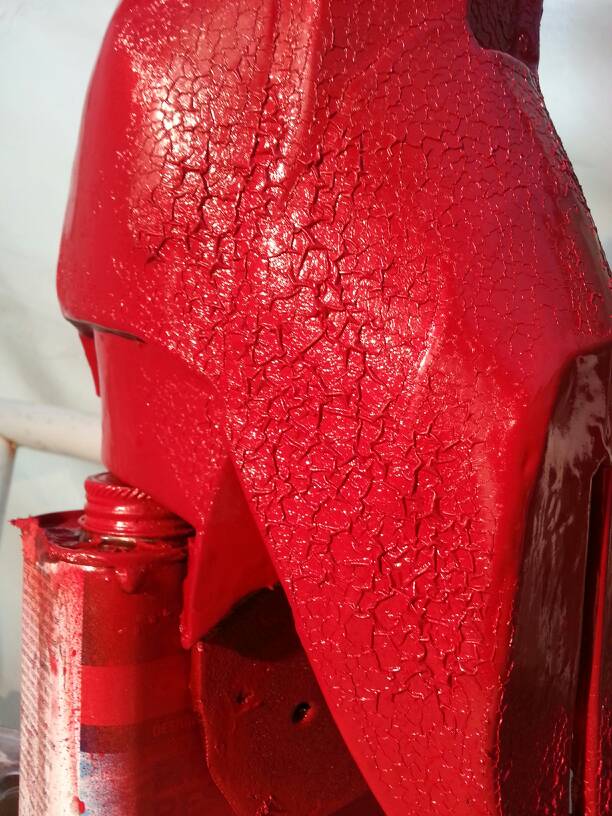

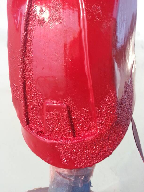

Need help: im using duplicolor toreador red but something its happening, can someone tell me why and how I can fix it,look pics
uploadfromtaptalk1400019791029.jpguploadfromtaptalk1400019802810.jpgthank you in advance

What's your base material?
What kind of primer did you use?
Do you paint in thin coat? That seems like a prettyn heavy coat to me ...
You can see runs of paint on the supporting bottle .. that's never good by the way ... is that your first time painting something?
As to how you can fix it .. you can't. Sand that back to the primer, or to the base material, reprime in thin coats and reshoot in thin coats.
Well I paint it first with rostokeum protective red enamel first, that's when I saw this thread in the morning so I paint it on top of that id did wipe it off with soap and water before tho
Sent from my SPH-L710 using Tapatalk
Rustoleum paint and Duplicolor paints do not mix well at all, i've had similar effects using a Rustoleum aluminum base with a Dupicolor red on top. What resulted was really similar but more subtle and tinier.
Needless to say, avoid mixing those two brands.

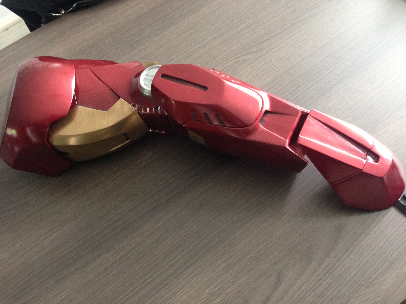

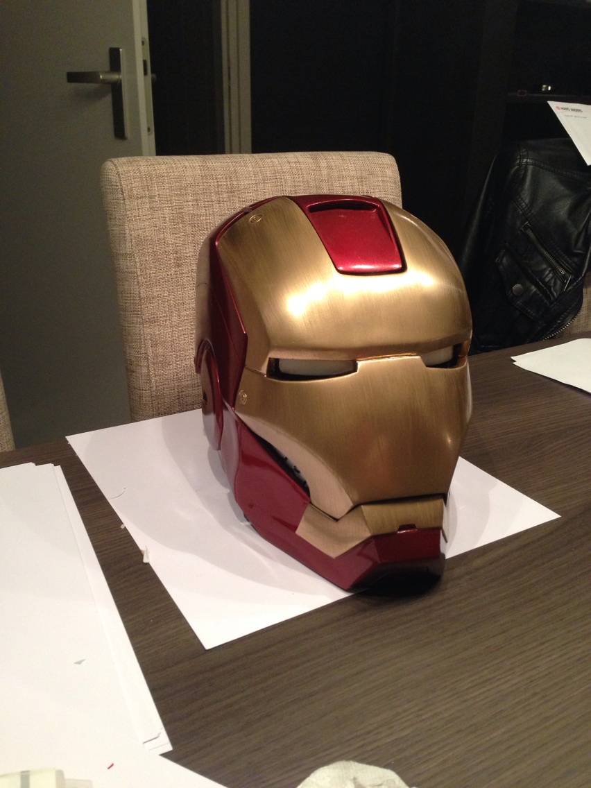

Is used a darker Cherry-like mettalic as first coat.. let it dry for an few minutes and than highlight it with a brighter red metallic.
This effect will cause the red to look fairly dark in de shade, but will really light up as soon a light shines on it!
For the gold metal is used gold chrome spray, let it dry for a few days and then gently sand it in one direction with a sanding block.
