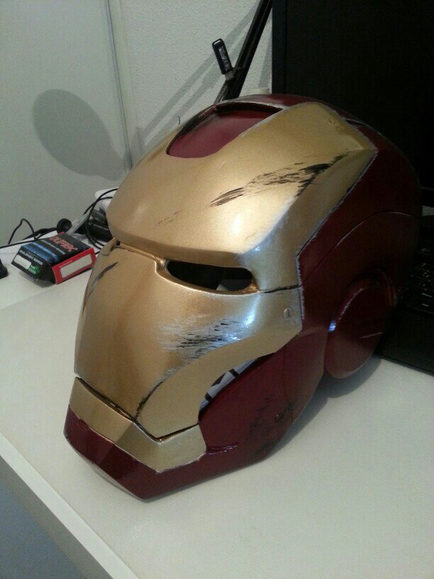

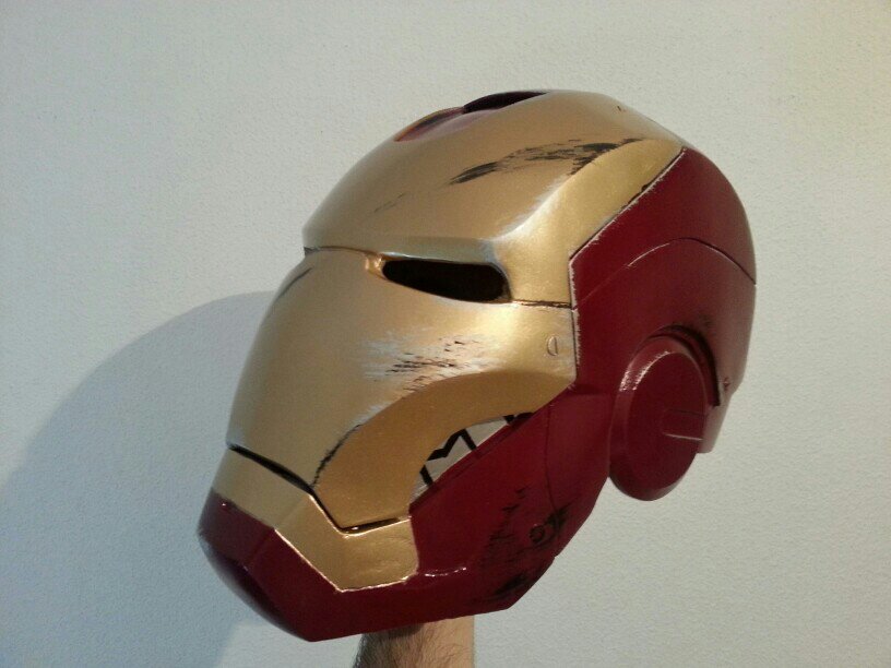

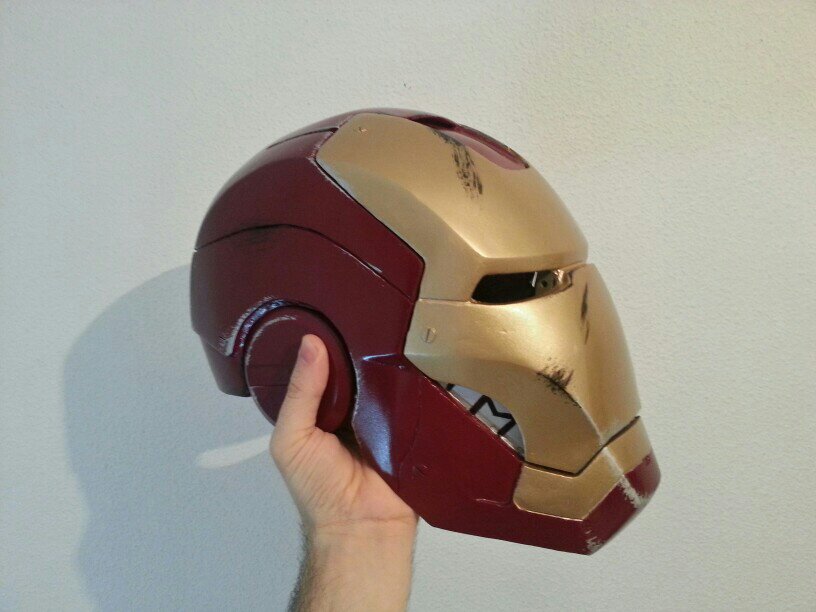

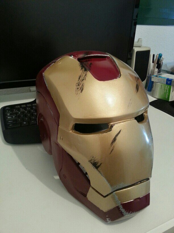

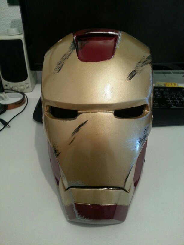

I just went with the popular choice of "Sunburst Gold Metallic Clearcoat BP/M6924" and "Toreador Red Effect Clearcoat FL" :D
Here are some pics of my helmet I posted in other thread:
uploadfromtaptalk1379919158850.jpg uploadfromtaptalk1379919132627.jpg uploadfromtaptalk1379919102640.jpg
I will try to take some shots in natural lighting if that helps :)
