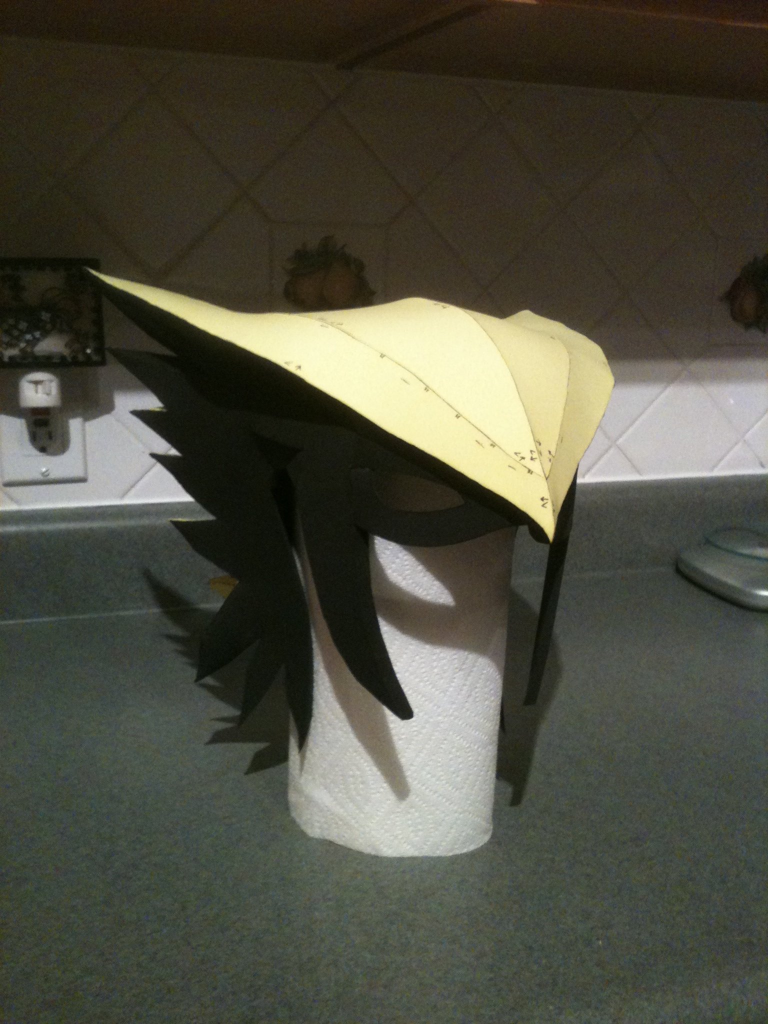

JFcustom - Thanks for having all the great templates on this thread. I used the Hawkgirl template to make a foam helm for my daughter this Halloween. She loved it (see pic). Lots of triangles to trace/cut...I saw them in my sleep.
