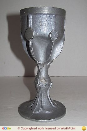

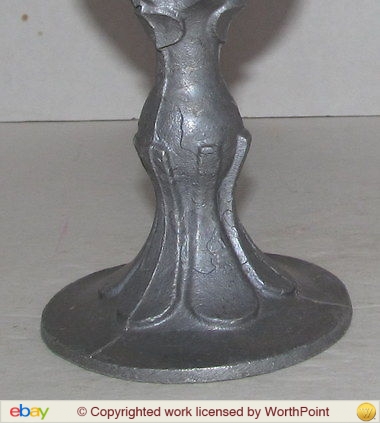

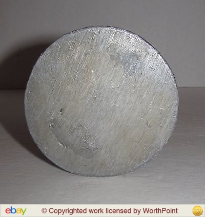

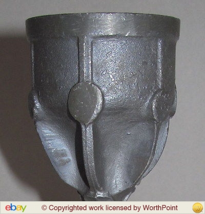

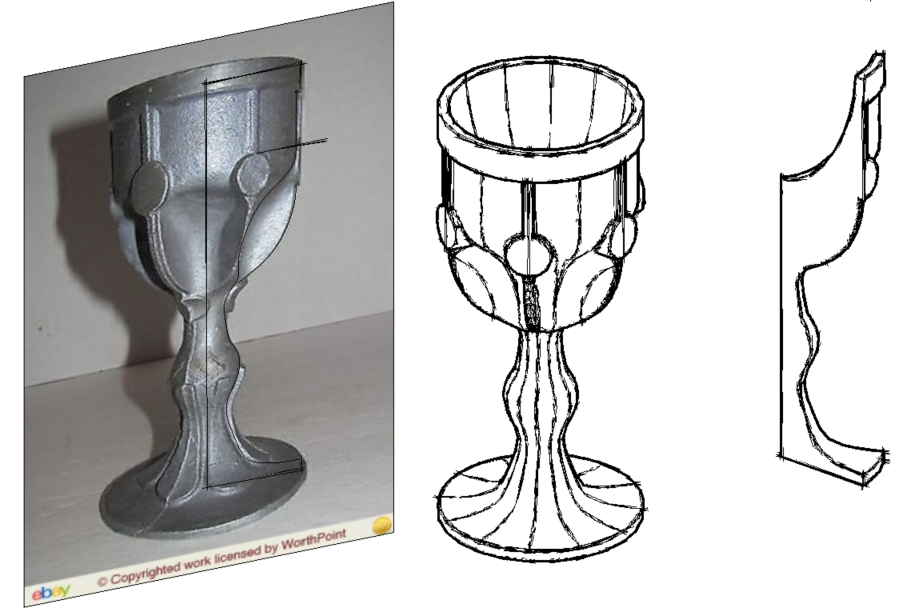

Found another example, Unfortunitly its of another sale from over a year ago. Uploading the pictures for posterity.

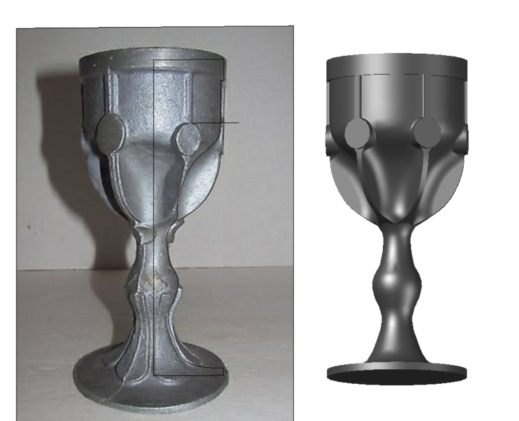

I'm afraid my talents don't lie in the 3d modeling area. If I could find someone that would do it on commission I would be interested in talking. Everything else I think I can handle. The end goal would be to have a model created, then a mold, and finally a pewter version cast. Other then that I am just going to keep watching ebay and hoping.
http://www.worthpoint.com/worthopedia/medieval-pewter-goblet-535301248

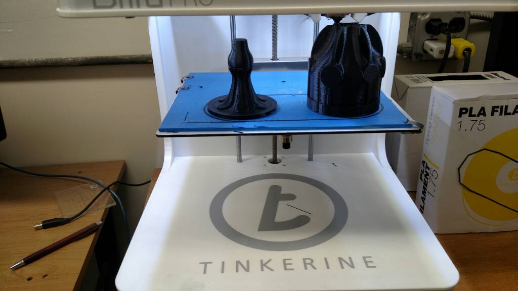

Best of luck on the build!

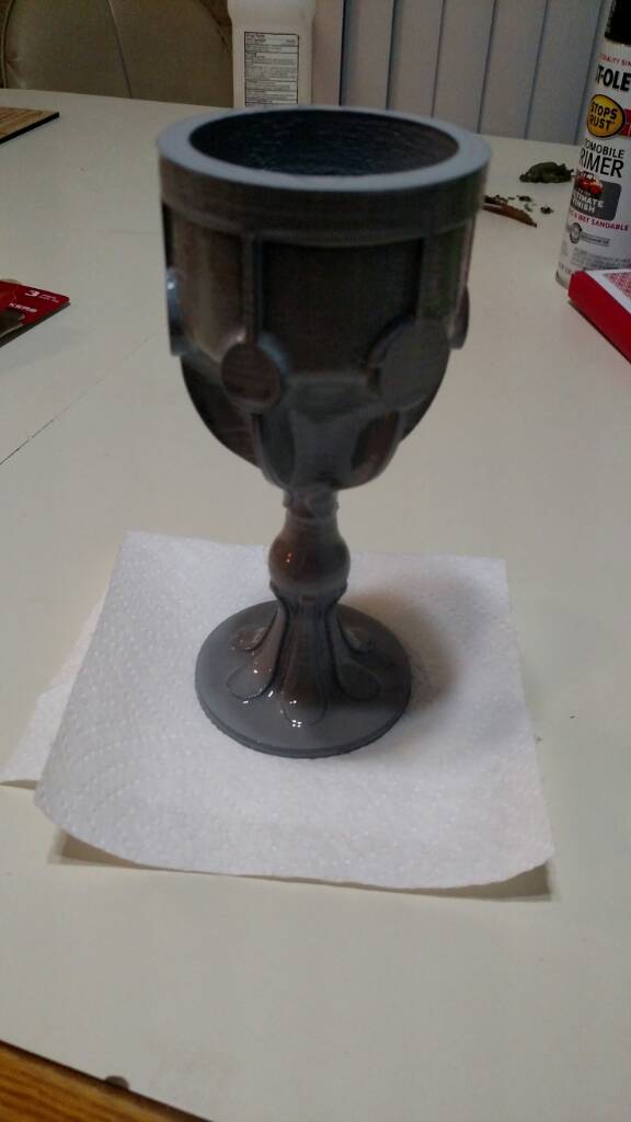

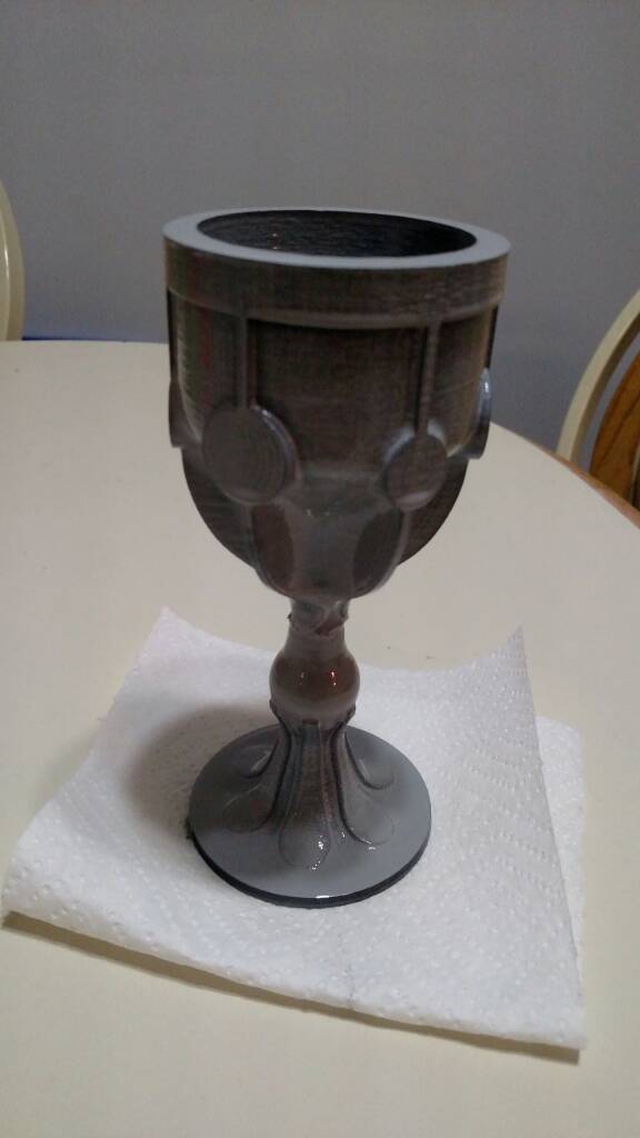

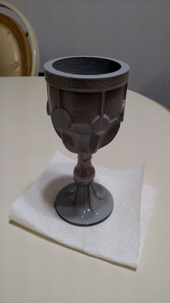

Judging from the can of spray on primer in the background I am guessing this is the 3d printed version with a coat of primer to smooth it out in prep for making a mold to cast the pewter one in.
This isn't an interest thread. I'm not saying I am or am not going to make them for others. I'm just making them and we'll see what happens

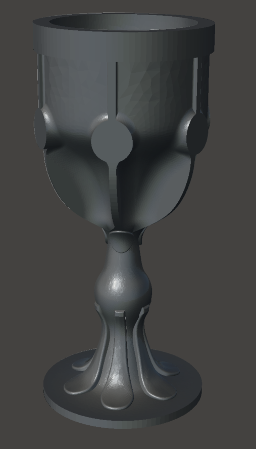

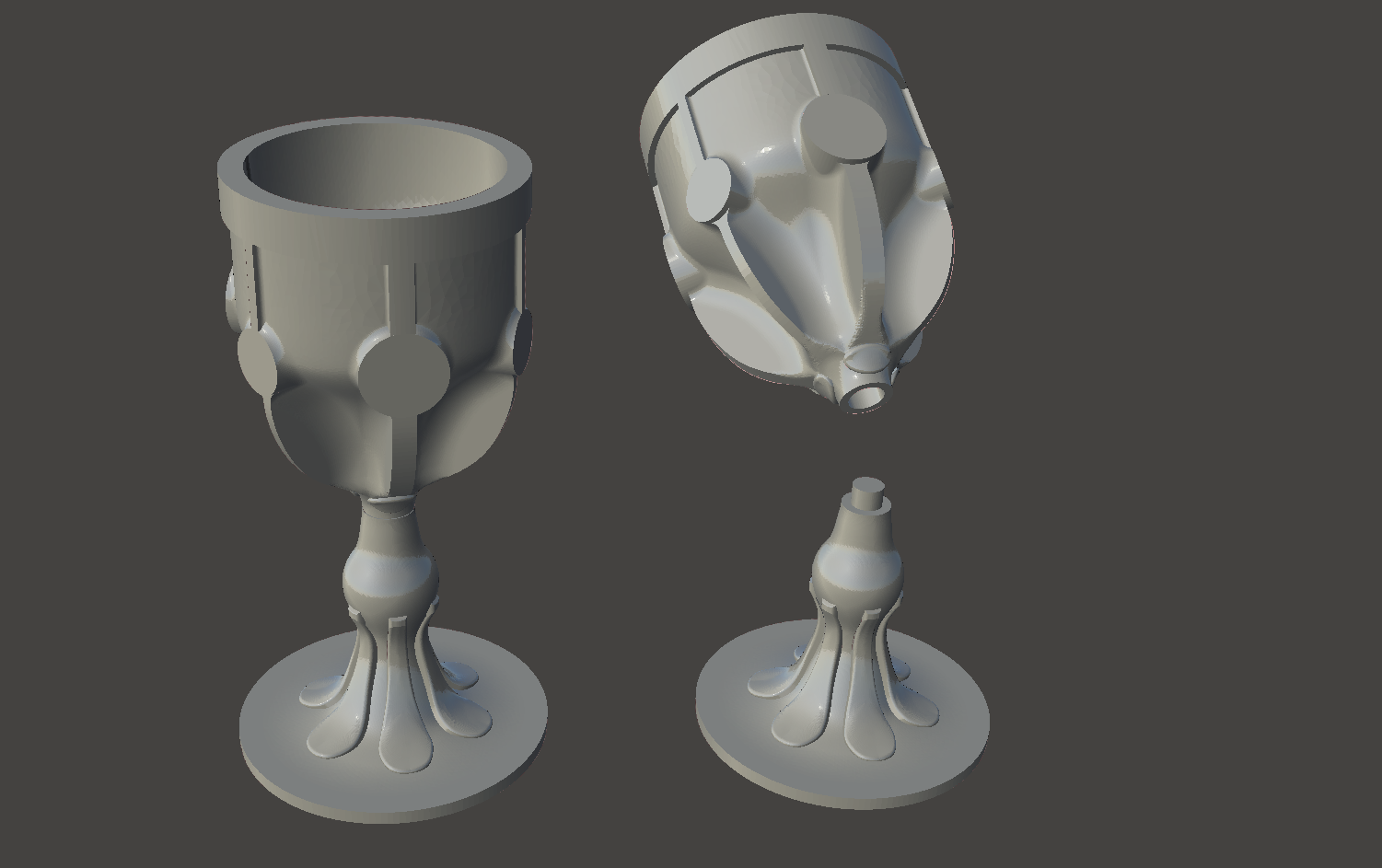

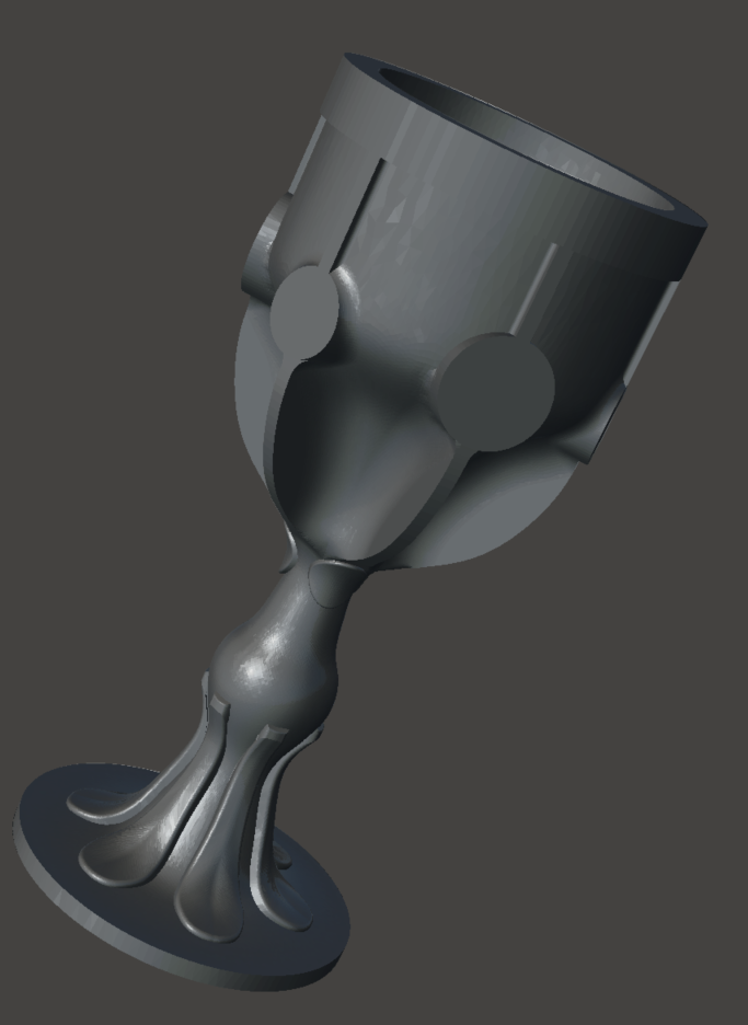

the base on mine is too small by nearly 1/2", and the 3 small circles under the cup are the wrong shape. I'm tweaking that now, as well adding a post and socket internally inside the stem so I can use that structure to line up top and bottom halves. I've got it split into two for easier printability without the need for supports.
