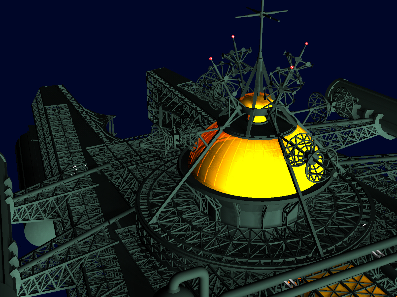

PS - do you meant the mini dome that goes on top? It just slots in between the antenna framing uprights. Turn it sideways and slide it down. I hope...I don't have my frames yet! :p
That's the one. Hmm, that works if the slots are 180 degrees apart but when they are 90 degrees apart there usually isn't wiggle room.

I haven't decided about an interior for the observatory domes. I will probably come up with something, but it will likely be very simple and schematic only. Just some vage lumpy stuff to create an outline viewable through the frosted dome.
Oh who am I kidding. It'll probably end up with workstations, an entire crew of humanoids and maybe Ol Bob to boot. lol.

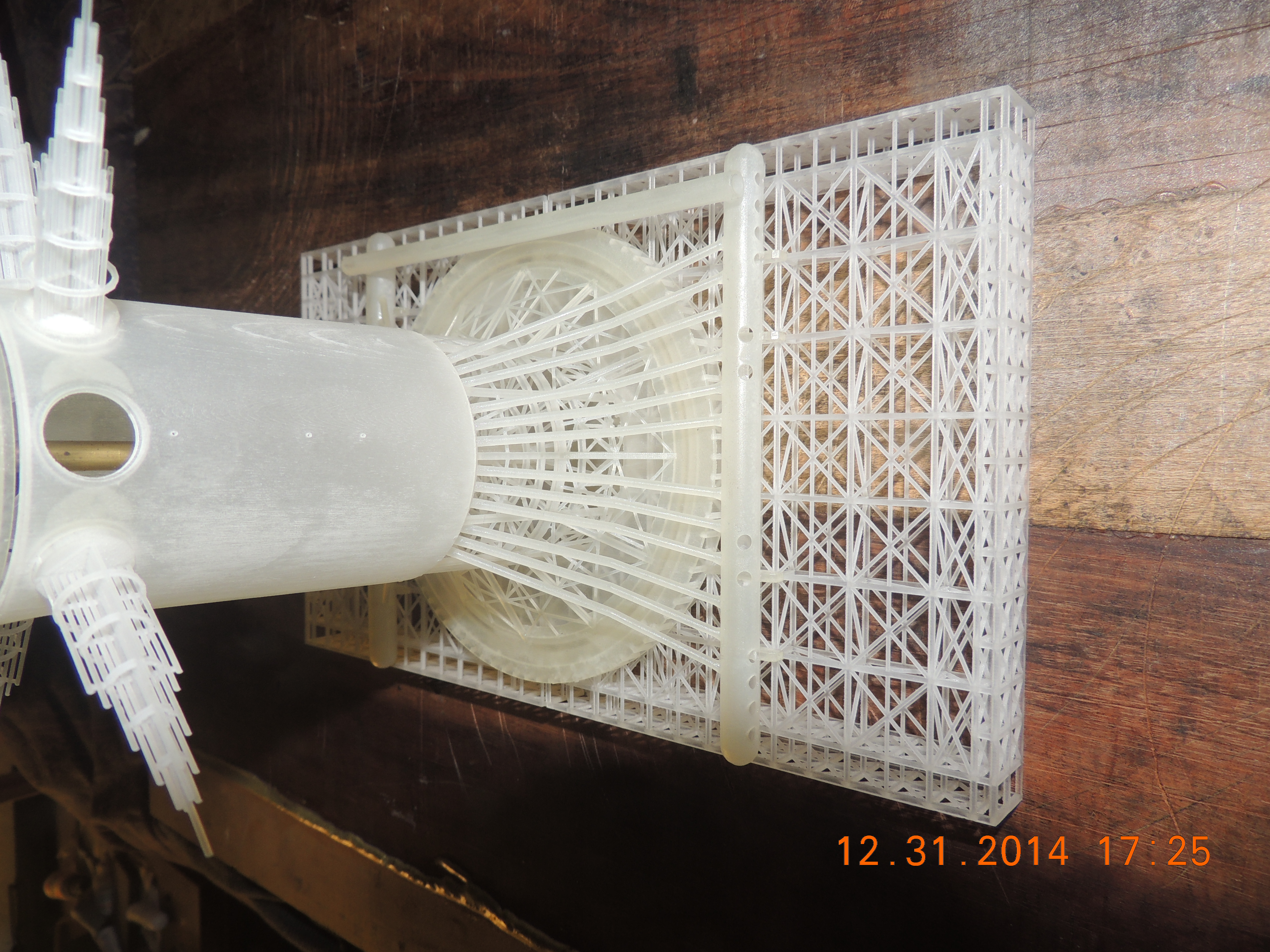

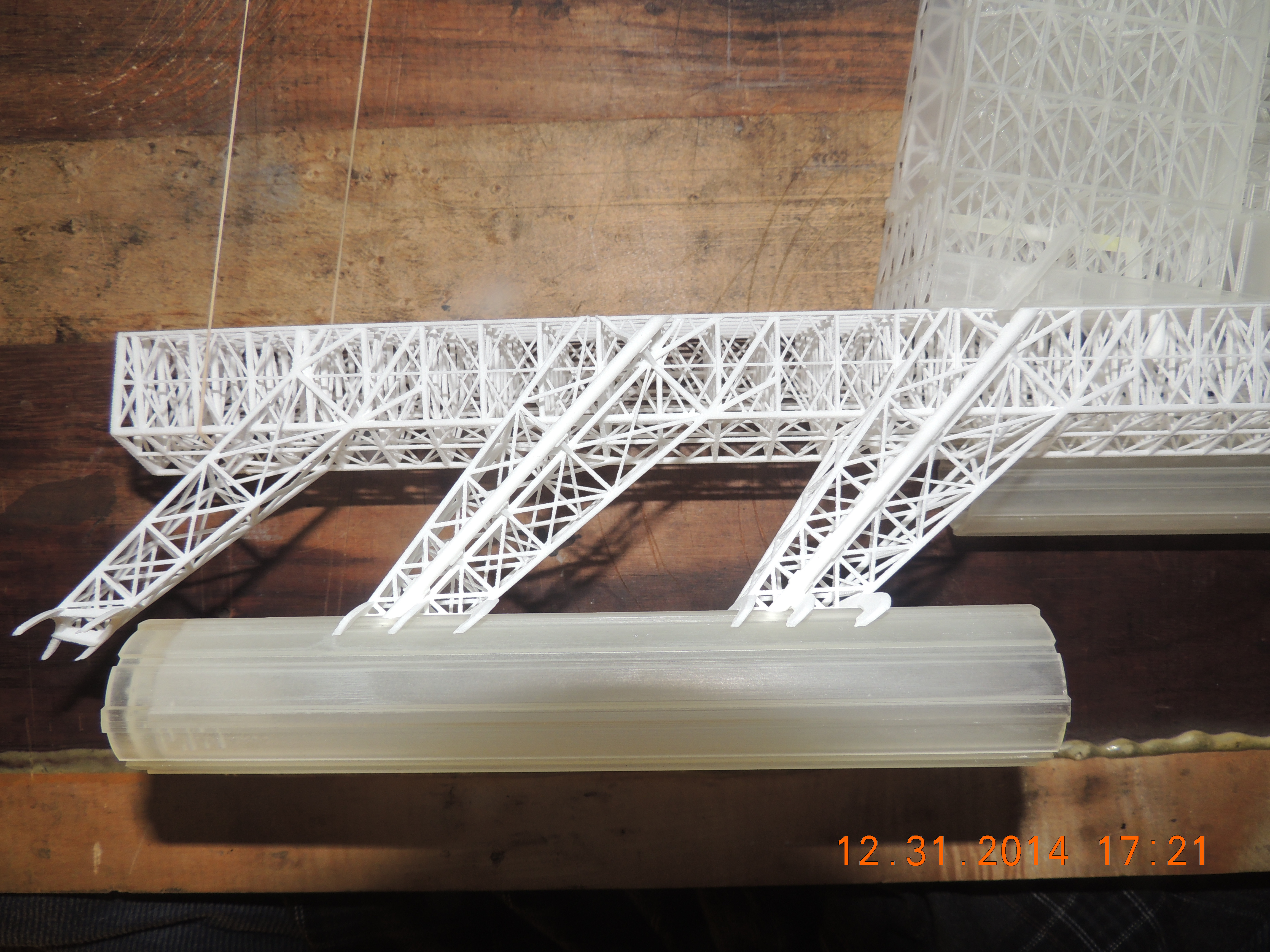

Yeah fit is a problem with the engine mounts. I'm going to have to shave mine a little; unfortunately I didn't get around to working any tolerances into the parts.
The main engine mounts differ slightly in the spacing of the 3 main truss frames. The two which are closer together are the front ones. It is only about a 4mm difference so you'll want to measure.

I had to clean out the fuel holes in the forward engines but then they fit perfect. The reversing engines did slide into the mounts from the back just perfect. Tapping worked better than pushing.
Engine caps are fine AFAIK. I posted that message on everything I enabled during the panic.
Yes the Pinshape mains are good. The heat shields have small sockets which acccept bosses on the inside of the triple truss parts of the engine mounts. With the engines in place it should all become a fairly firm unit which can then be glued directly to the underside of the upper decks.

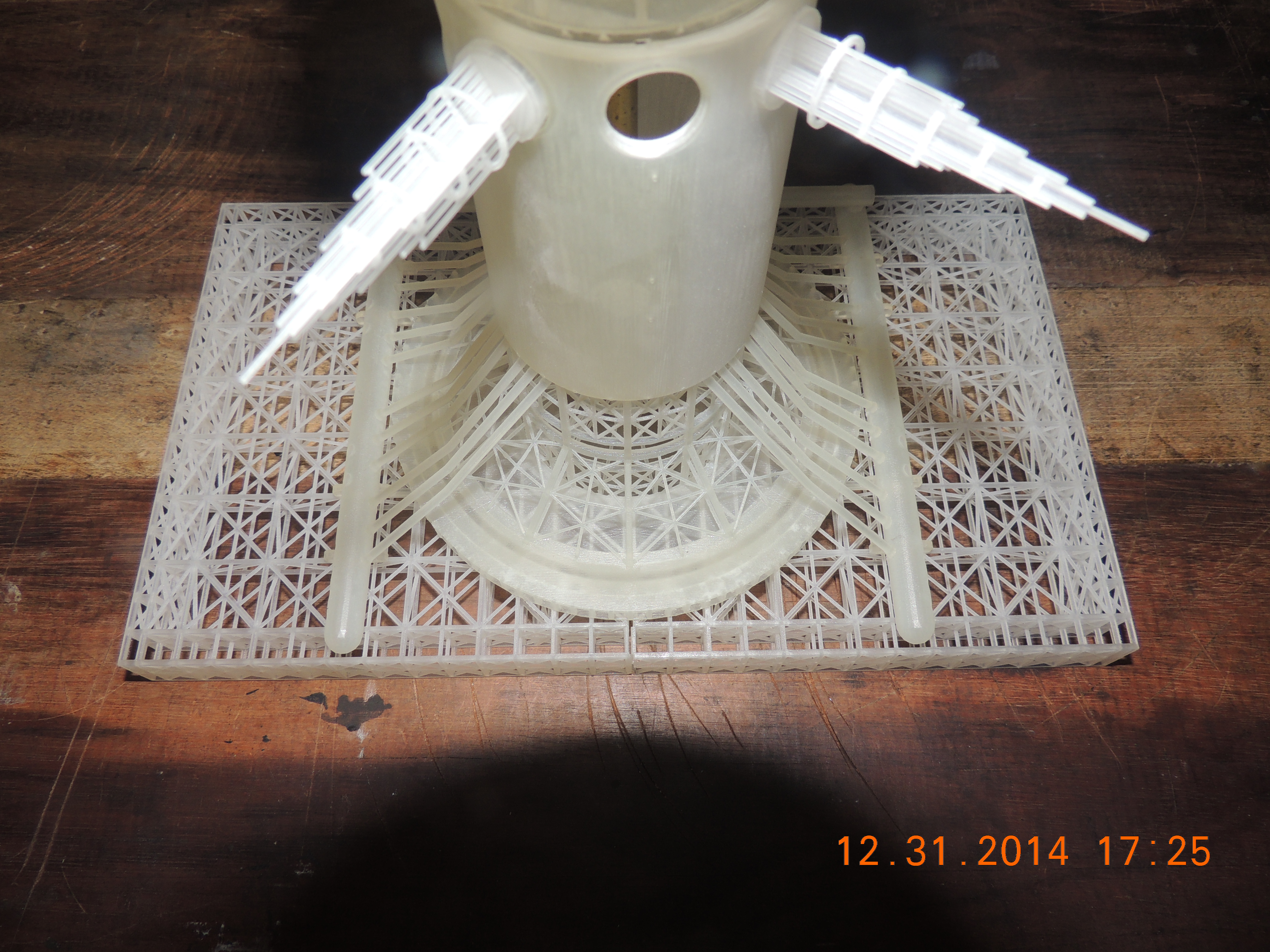

Good to hear re the front engines! Ta for the pics, damn, looks pretty nice in FUD. With the platforms there are some small sprues to remove before joining the halves. I'll post a pic calling them out.
Yes please on the sprue. I don't see it. I see the double braces at the junction but I don't see any difference that says I'm sprue and he's not.

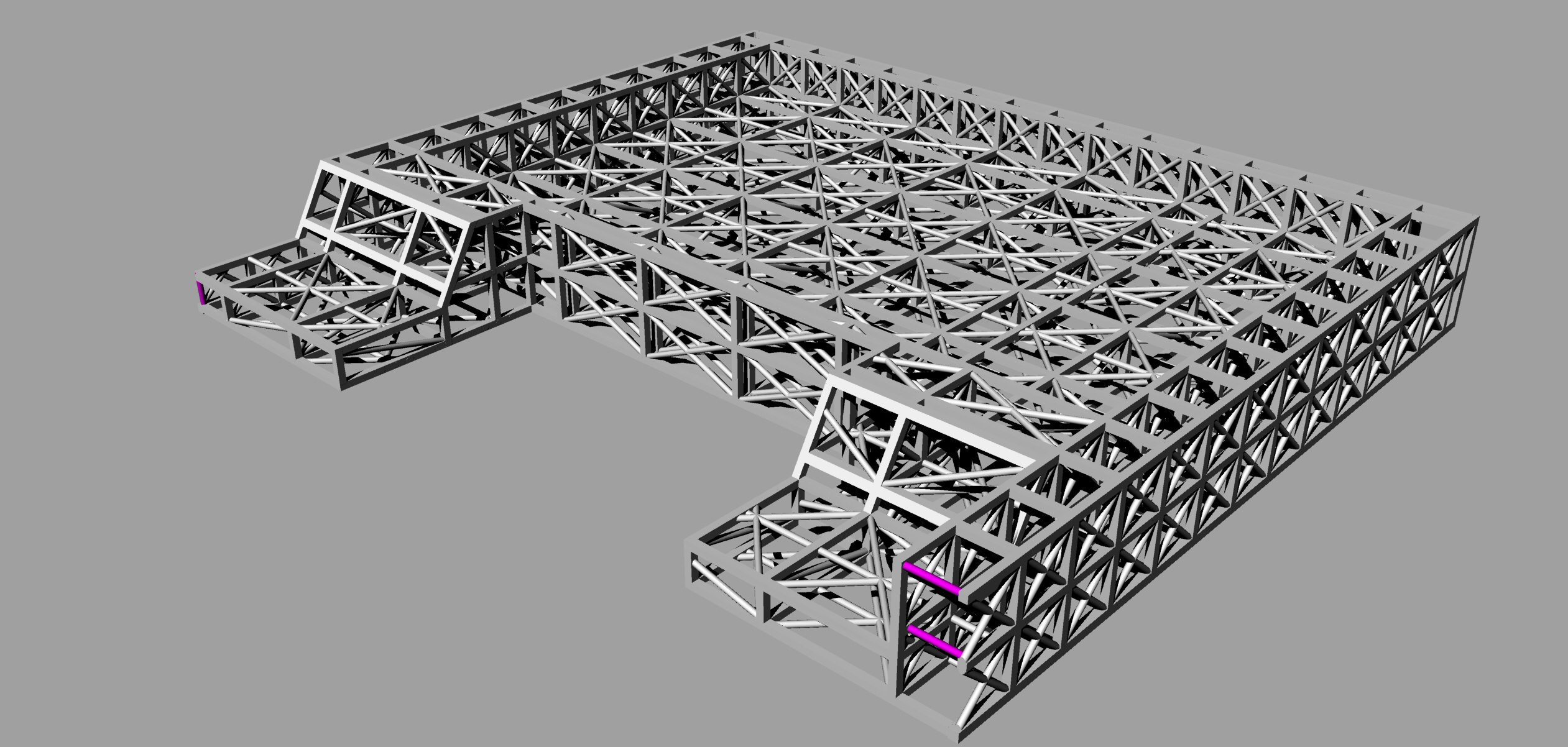

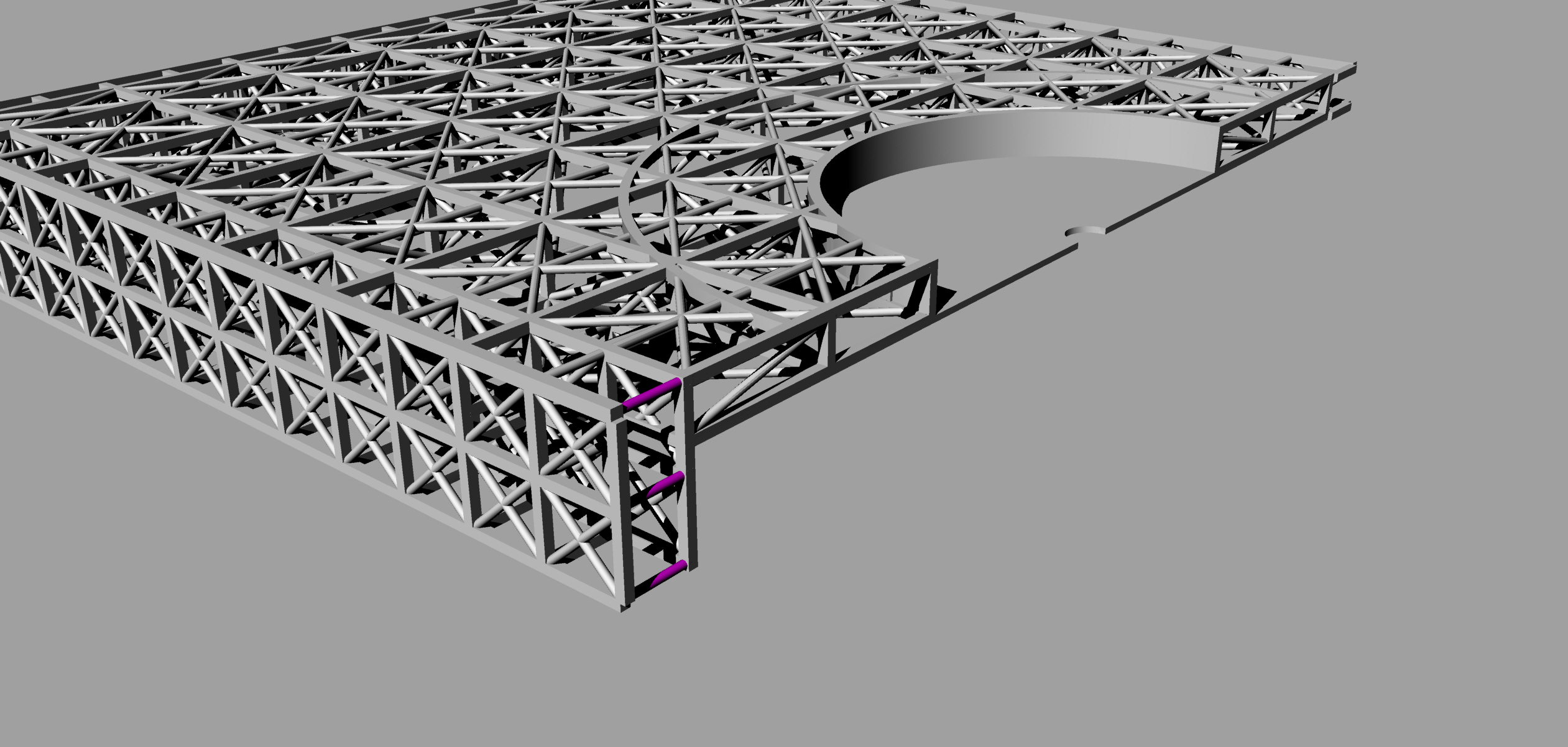

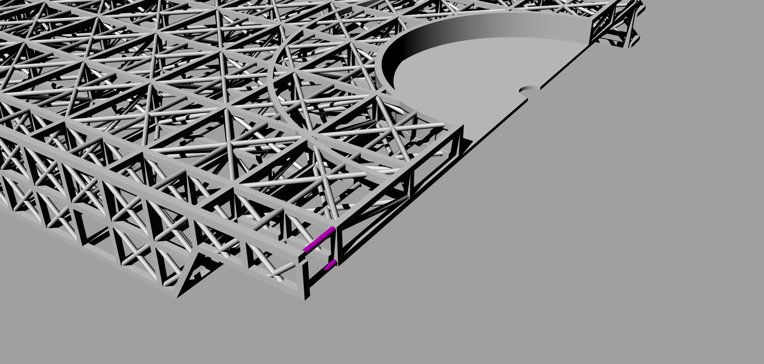

The sprues are all tie rod sized (round .85mm) rather than main girder sized (square 1.1mm), if that's any help, but I'll get a pic up tonight. Sorry, had a big weekend. :)

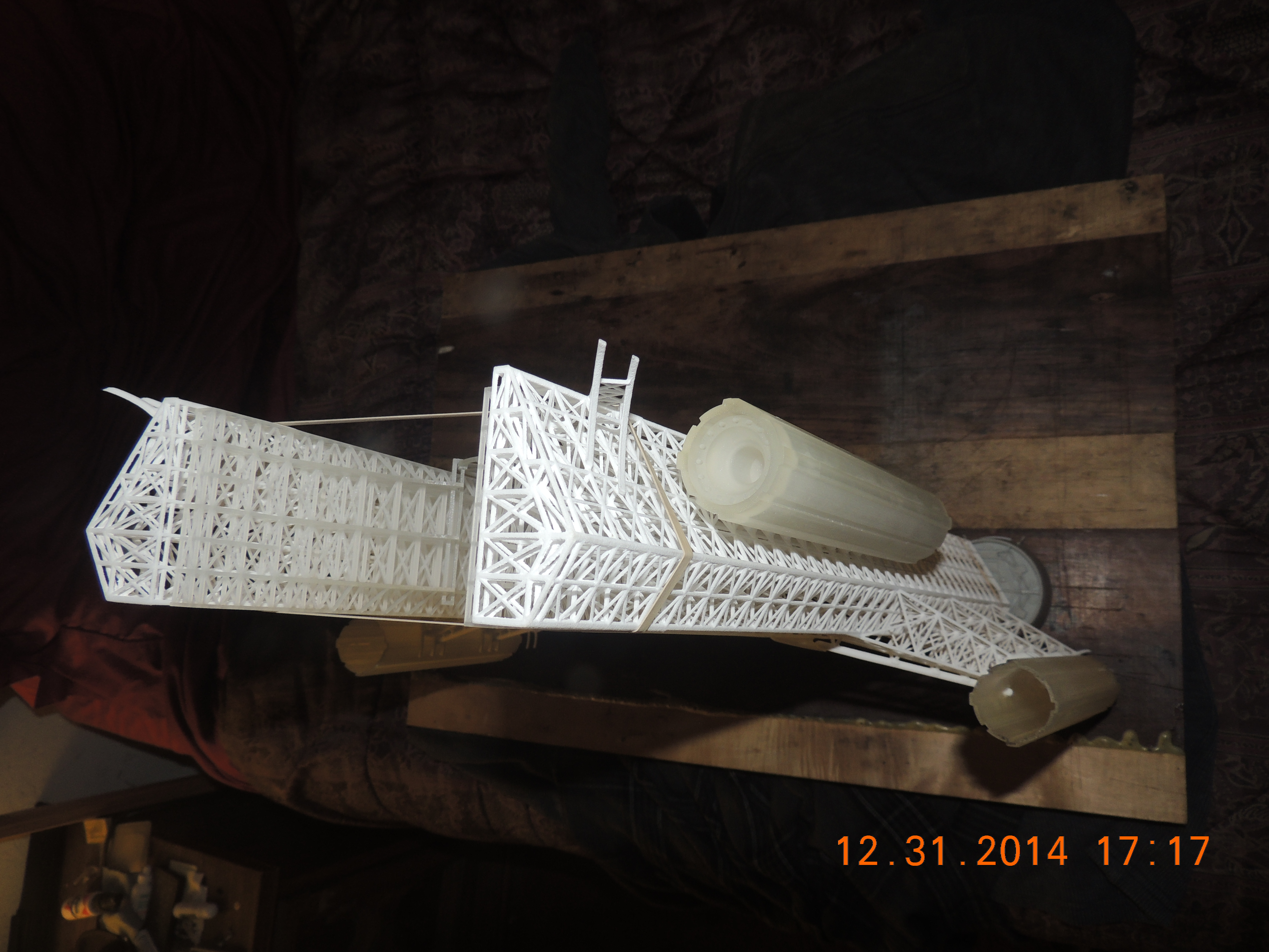

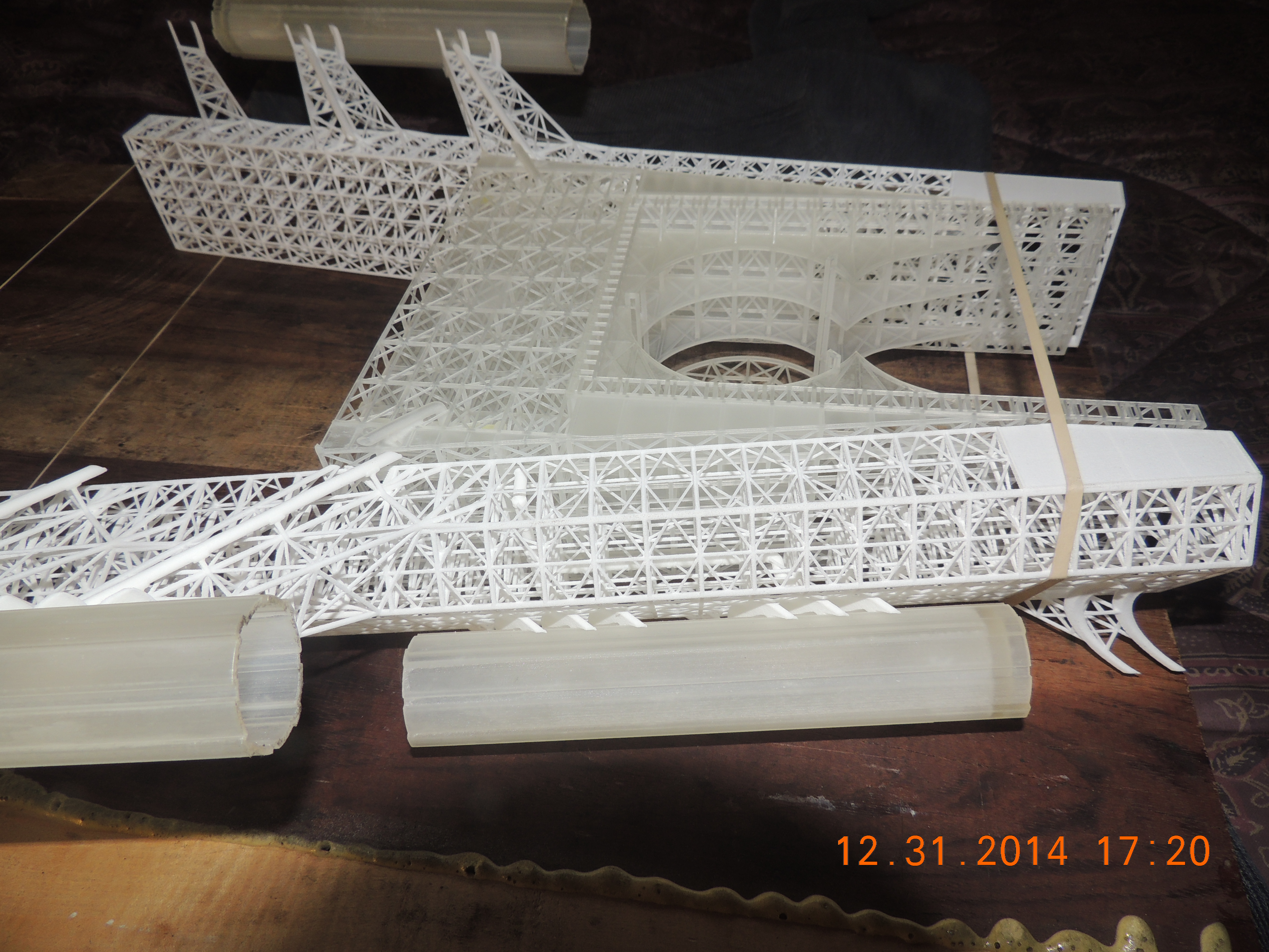

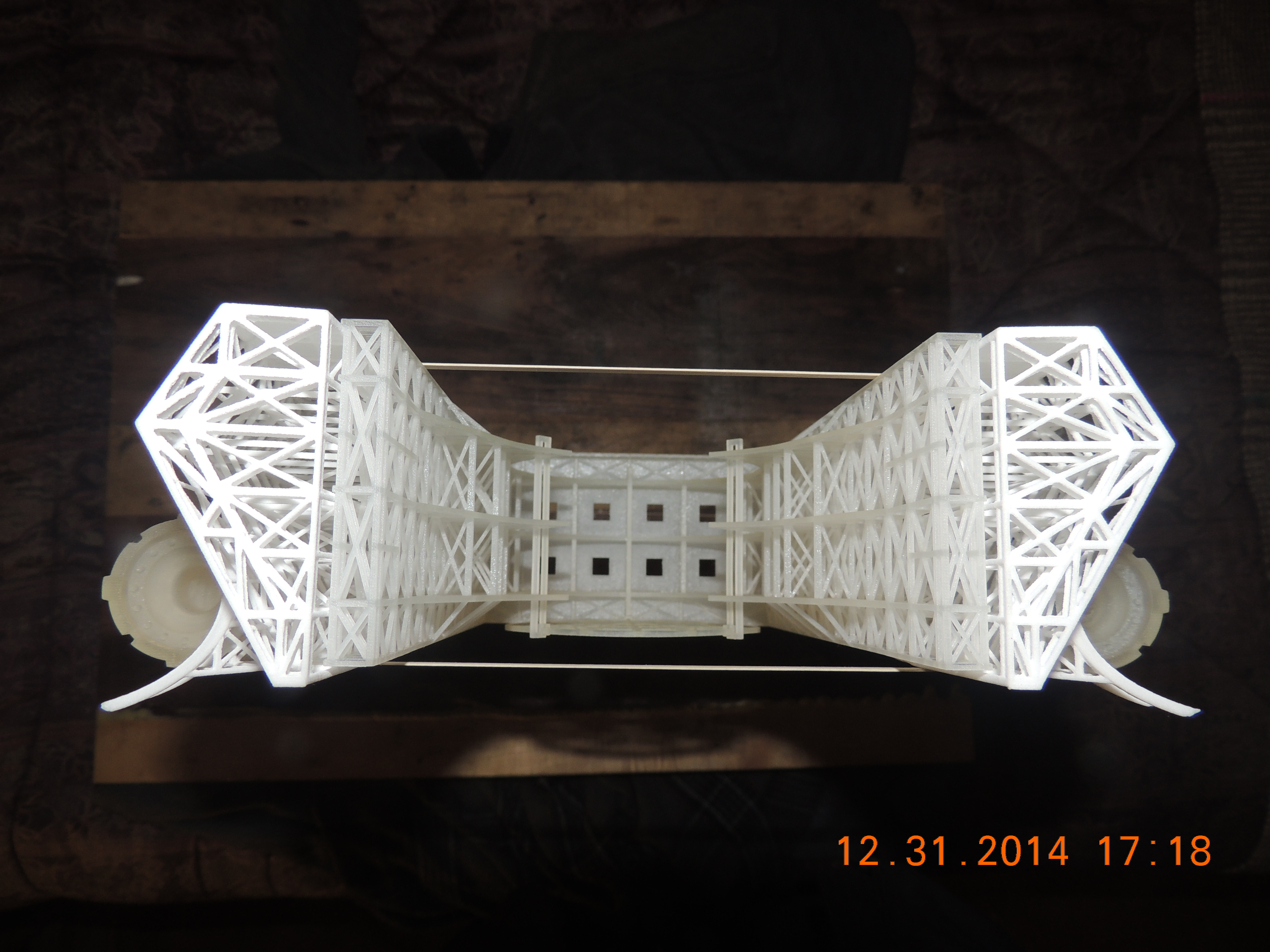

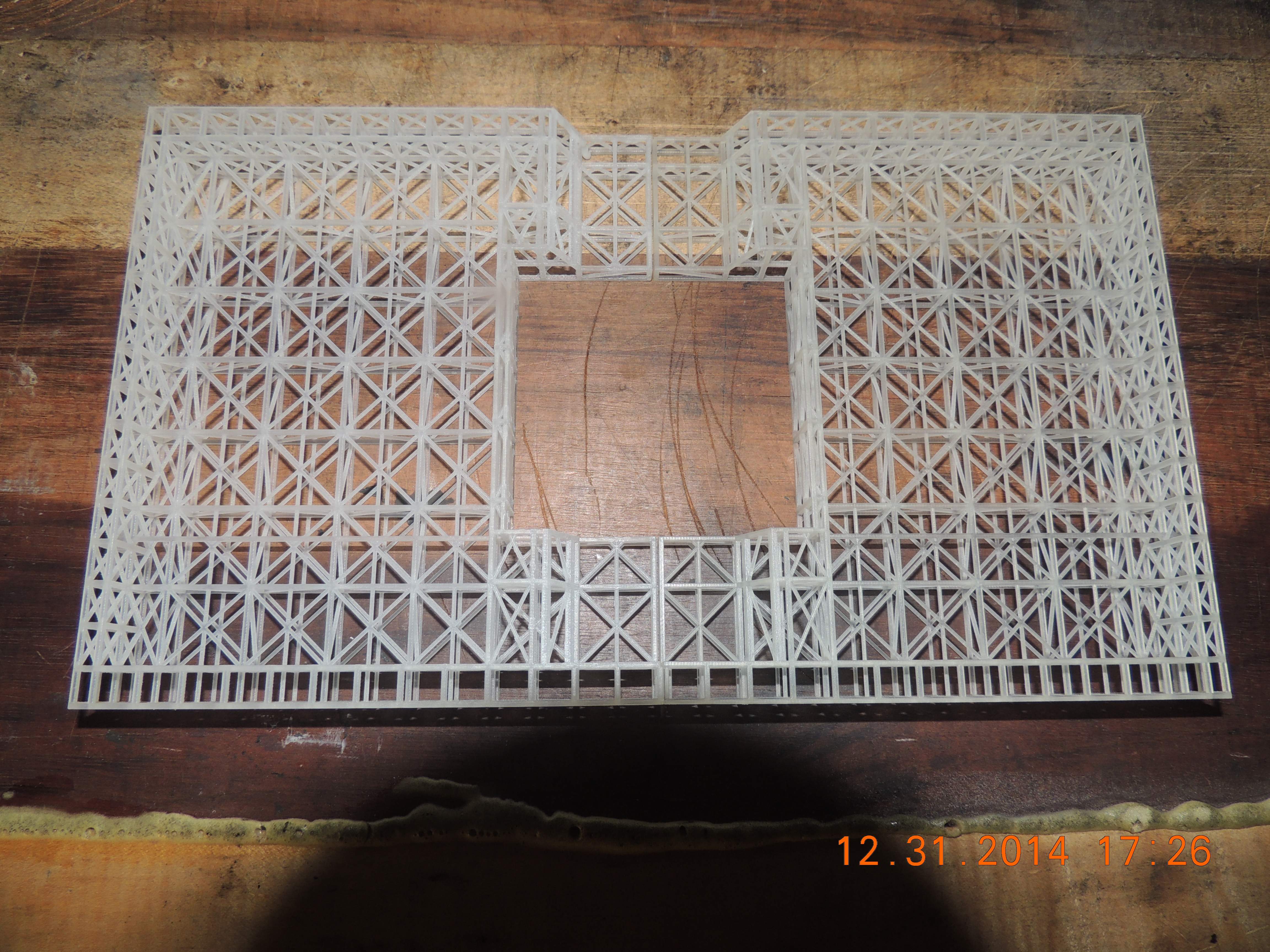

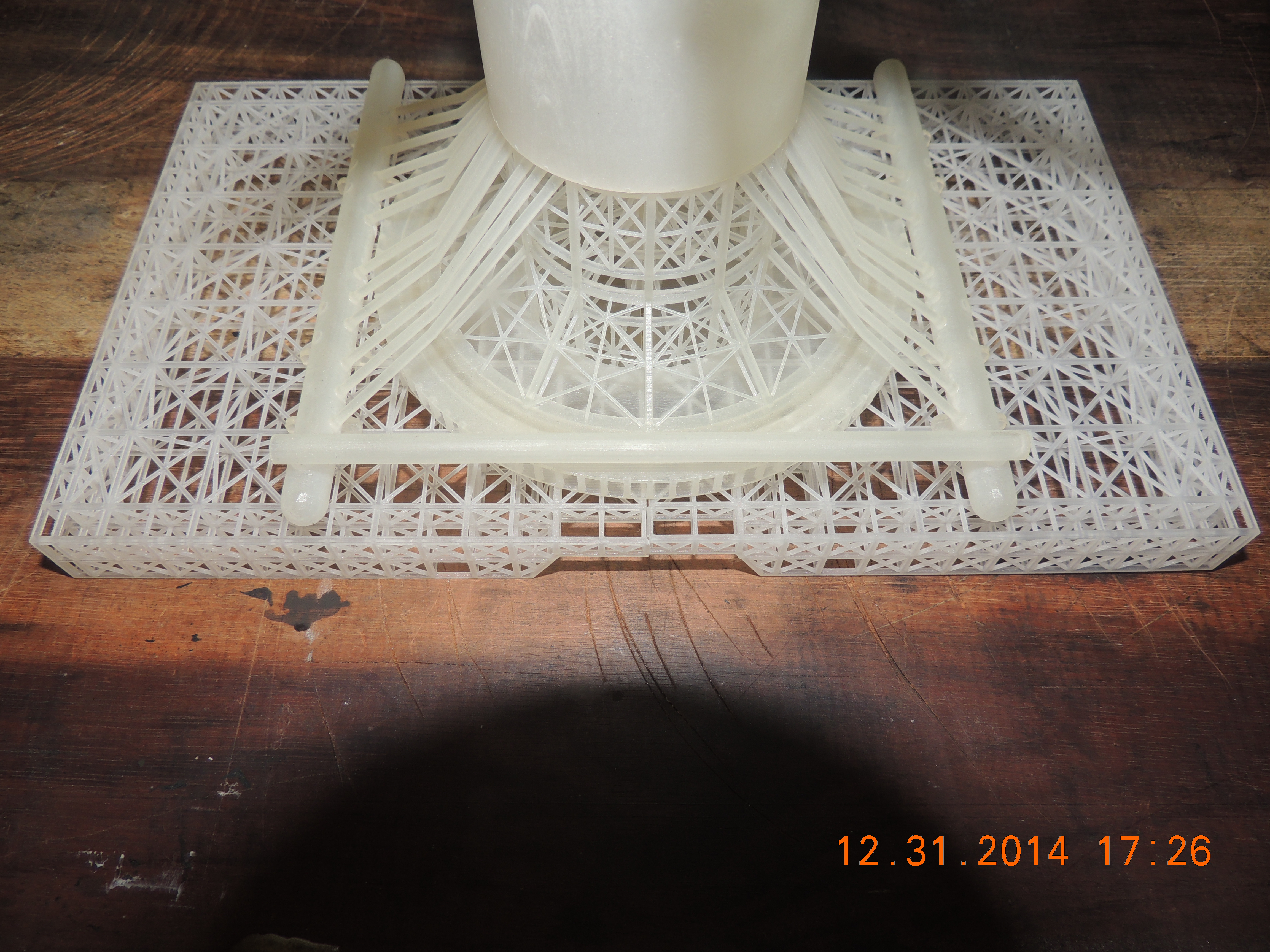

Finally:
Sprues in magenta on lower right, upper right and upper left pieces. There are none on the lower left piece.

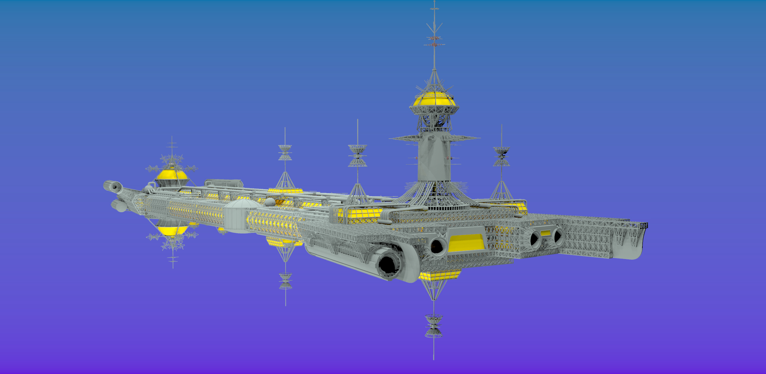

Did I ever post this? Too bad if so, here it is again. :p
Thanks for the sprue info, didn't catch that at all.
That's a great pic of the the whole banana. My new wallpaper.
