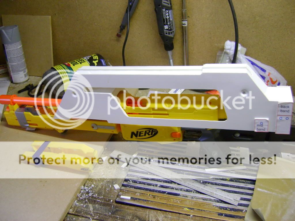

Yeah any tips on relocating the grenade launcher trigger. I have the shroud put together and starting to look at extending the trigger mechanism. I'm having problems visualising how the trigger pull will go.

As for the trigger, i'll try to explain/remember how i did it:
Once you take the trigger/grip out of the front gun, there is a hole in the bottom of the gun that you can run the trigger extender out of. This will eventually be covered by the top portion of the front gun that you reposition to the bottom.
The trigger extender will look like this(using a diagram I whipped out earlier in the thread):
______________==
The "==" part will notch into the existing trigger mechanism of the front gun, the "_____" will run back to the bottom corner of the recon, and the trigger will pop out the bottom of the recon. You will need to cut a little notch to make it all fit into the recon. I laminated 4 pieces of styrene together, once I had the basic dimensions of the trigger extender down, to give it some strngth. The 4 pieces together, go about 3/4 of the way from the front gun to the trigger, then I just carry on with the middle 2 pieces from there, so the trigger isn't too thick. Last but not least, I added a thin strip to the trigger itself, so it was a bit more comfortable to pull.
The trick to getting it all to fit in and have enough range of movement to fire is to pull the trigger mechanism back a bit against the spring, so it doesn't have to travel far to fire. If there is no pressure on the spring, the trigger won't have enough room to move.
Sorry i don't have a template for this part, but I basically eyeballed it when I did it, and never thought other people would want to make the gun, so I didn't bother taking pics :)

Any chance you could draw the path of the trigger extension on the picture.

I went a different route with the grenade launcher trigger. It is a pretty similar setup, but more cut aside on the Recon. I'll take pics tomorrow.

Here's a roughed up version of the trigger. Not precise dimensions by any means. Also note that you will need to hack off the screw peg directly behind the trigger so it has room to move. I also added some supports inside the recon (just few pieces of styrene) to keep the trigger from wiggling.
Just remember to check the length and make sure there is enough travel to fire. When fully pulled back, the new trigger should slightly slot into the angled part of the shroud that covers the magazine, but not go back into the vertical part. When it's fully forward, there should just be enough room to get a finger in betwee nteh trigger and the trigger guard part of the shroud.
And whatever you use to fill your gaps, don't use bondo. It won't stick.
