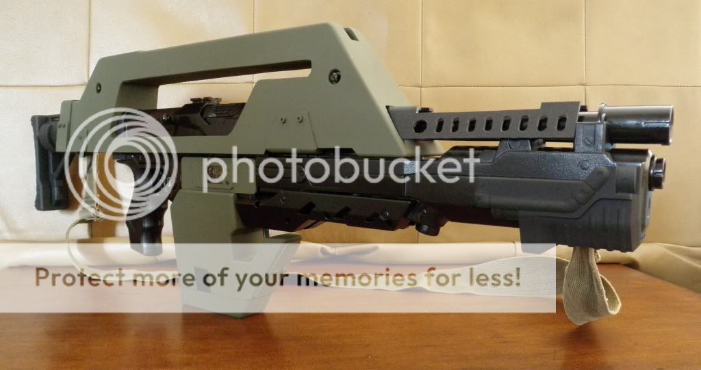

Nerf Aliens Pulse Rifle Build

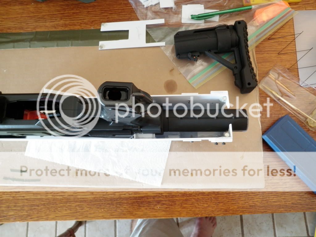

There is a lip on the inside of the buffer spring tube that keeps the shoulder stock from being pulled completely off.
Just remove the screws on the sliding shoulder stock and grind down the lip.
The shoulder stock is then completely removable.

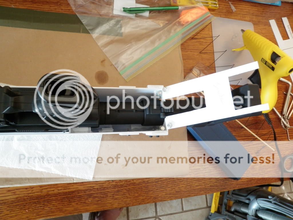

Fully assemble the carrying handle shroud except for the bottom plate.
You should be able to slide the handle over the front of the upper receiver, then insert and click the buffer tube in-place and slide on the shoulder stock.
Finally insert the barrel heat shrouds and barrel.
Kind of Rubix like but it all fits together nicely.

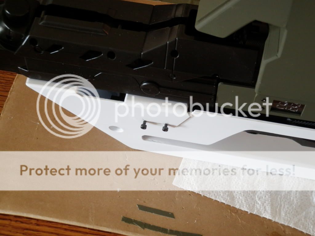

The smaller panel behind the pistol grip is held with magnets and friction.
Sorry for the delay on the photos. Photobucket was being moody.
If you want the magnets here are the locations.
Front of the carrying handle.
A corresponding magnet is inside the top plate on the Longshot.
For the magazine well, each corner received a smaller magnet.
They match up with the magnets placed inside the lower receiver.
The counter doesn't work. It was made with scraps and can be back-lite in the future with a single LED.

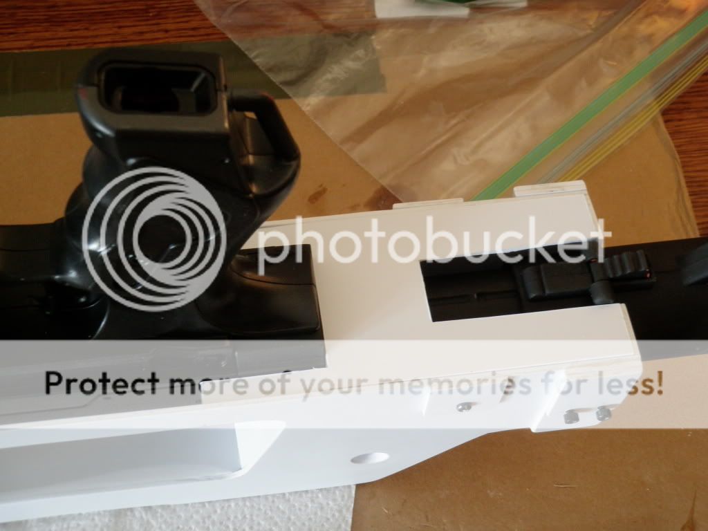

This assumes you have removed the heat guards and barrel.
For removal of the handle. Back out the four set screws in the front.
Open the back bottom panel. Please note the two magnets on either side in the back.
Slide off the removable shoulder stock.
The handle can now slide forward, up and then back. It can be a tight fit. If so you can release the buffer spring tube that was remaining with the removal of the stock.
Hope this helps with how to modify Quest's templates so you can tear down your M41N.
