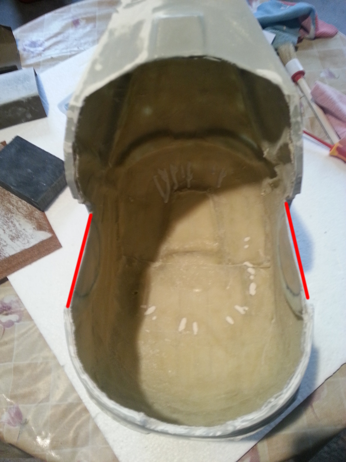

Been building mine, bit disheartened, The thing fitted my head when it was folded in card but when I resined it got it all nice then cut the back off to fit my noggin in was was too tight grrr so so disappointed that I have to have a break, ever get that? spent weeks getting to the point of going to do the hinges to find it a not going to fit on my head. I just love the helmets you guys are doing, really want one but I think I need to regroup my patience and go a scale or two up. ( Is just the ear section, anyone else have this prob? ) anyways heres some pix, this one will be left in the corner of my shed I think :(View attachment 199390View attachment 199391View attachment 199392
If the ear pieces are hollow (the pieces you still have to add), you can simply cut a hole in the helmet to let your ears go inside the circular pieces you haven't attached yet. May add the extra space you need.
Yes, most people do this and I was gonna suggest the same thing.
Yes, I had that same problem. My helmet was so tight that the ear pieces.gave me bruises on my temple. HOWEVER, I knew it had to fit since I already tested it out when it was still in the paper stage and it fit just right. So I got my dremel and ground away at the ear section as much as I could. I got so deep that I basically removed the Fiberglass around the ears. Fortunately since its a very thick section, it remained very sturdy because of the amount of bondo on those parts. But most importantly, it fit my head perfectly. So in short, so long as you were absolutely certain that it fit when in the paper stage, then its likely those ear pieces just became too thick when fiberglassed. ;)
I had to do this to my glove. It was killing my hand right behind my thumb (towards my wrist) but I dremeled out all the fiberglass cloth on that ridge and almost went back down to the paper and it fits perfectly now.
Re: Darkside501st's Iron Man Mk VII pepakura files - New Image pg 124!
thx guys, I had looked at the hole in the ear section trick but i feel its just not gonna work. Im over the shock now lol i could have cried.. so back to biss, have cut out the test helmet file for sizing which I should have done in the first place. The one made in pix is .95 scale Im going to try the 1.0 see how that goes then Ill get back into it. Thx again for the comments guys, ill let yo know how I go.

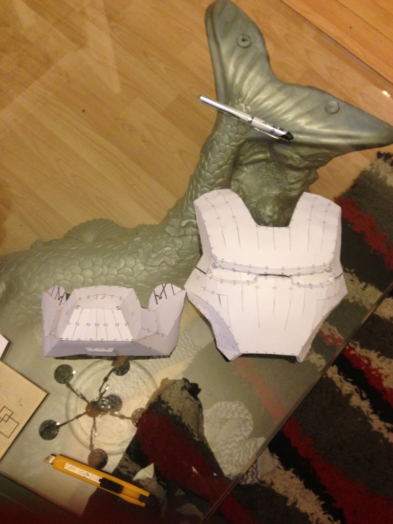

Hey guys just started peping this is my first try at this stuff lemme know what you think
Also mad props to darkside for making the awesome pep files

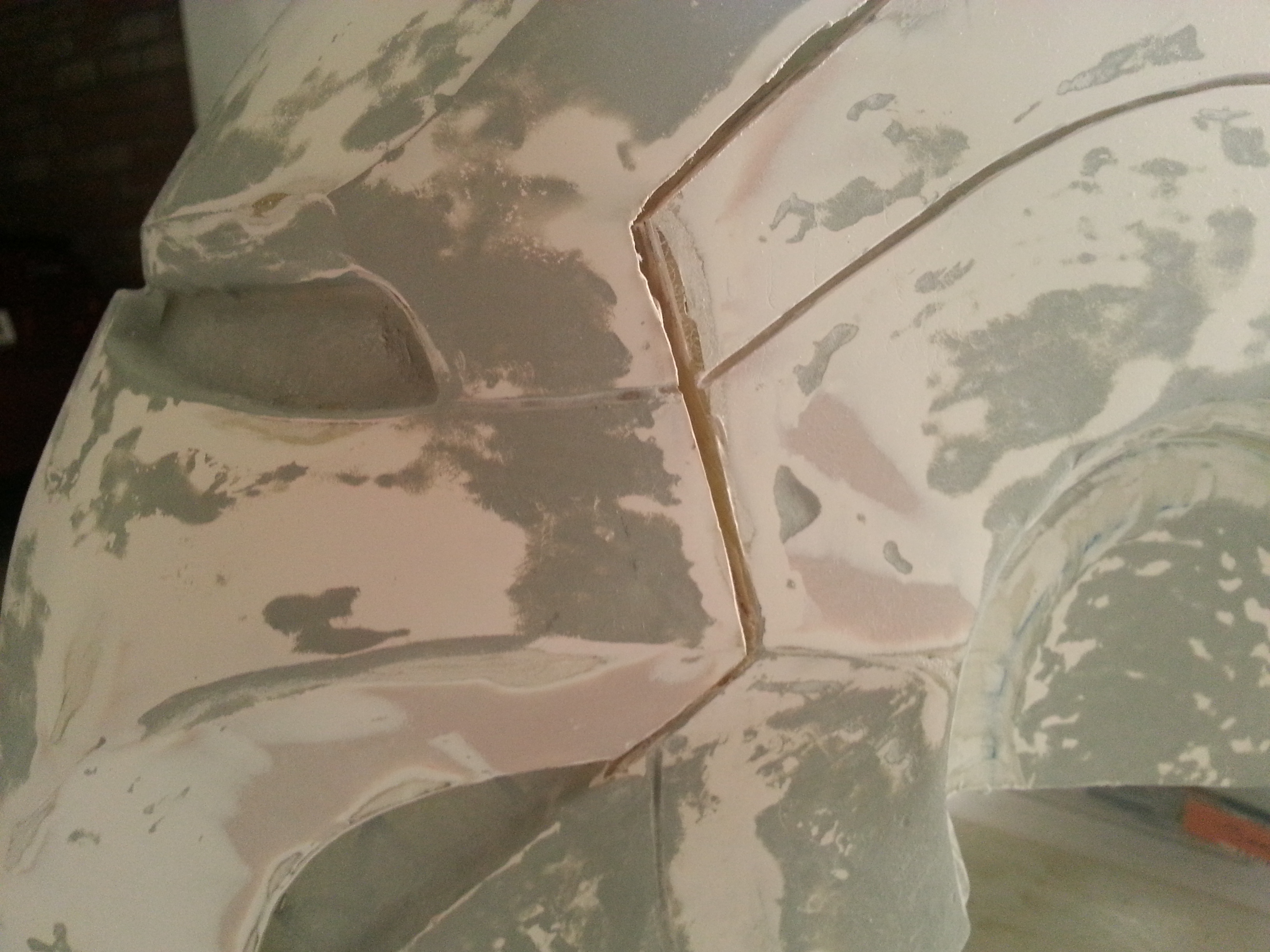

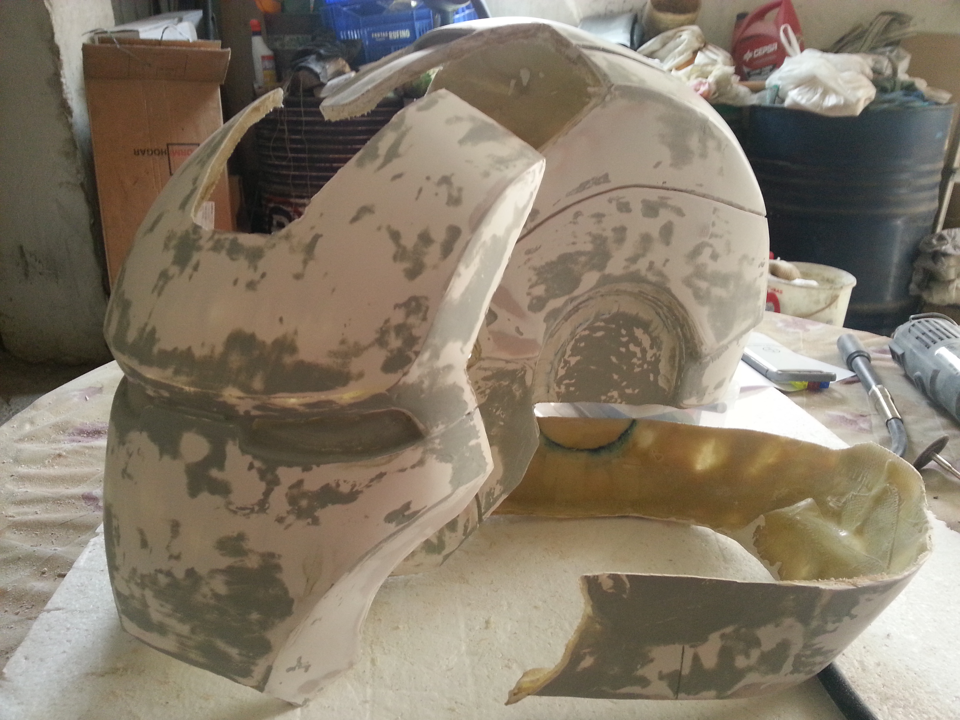

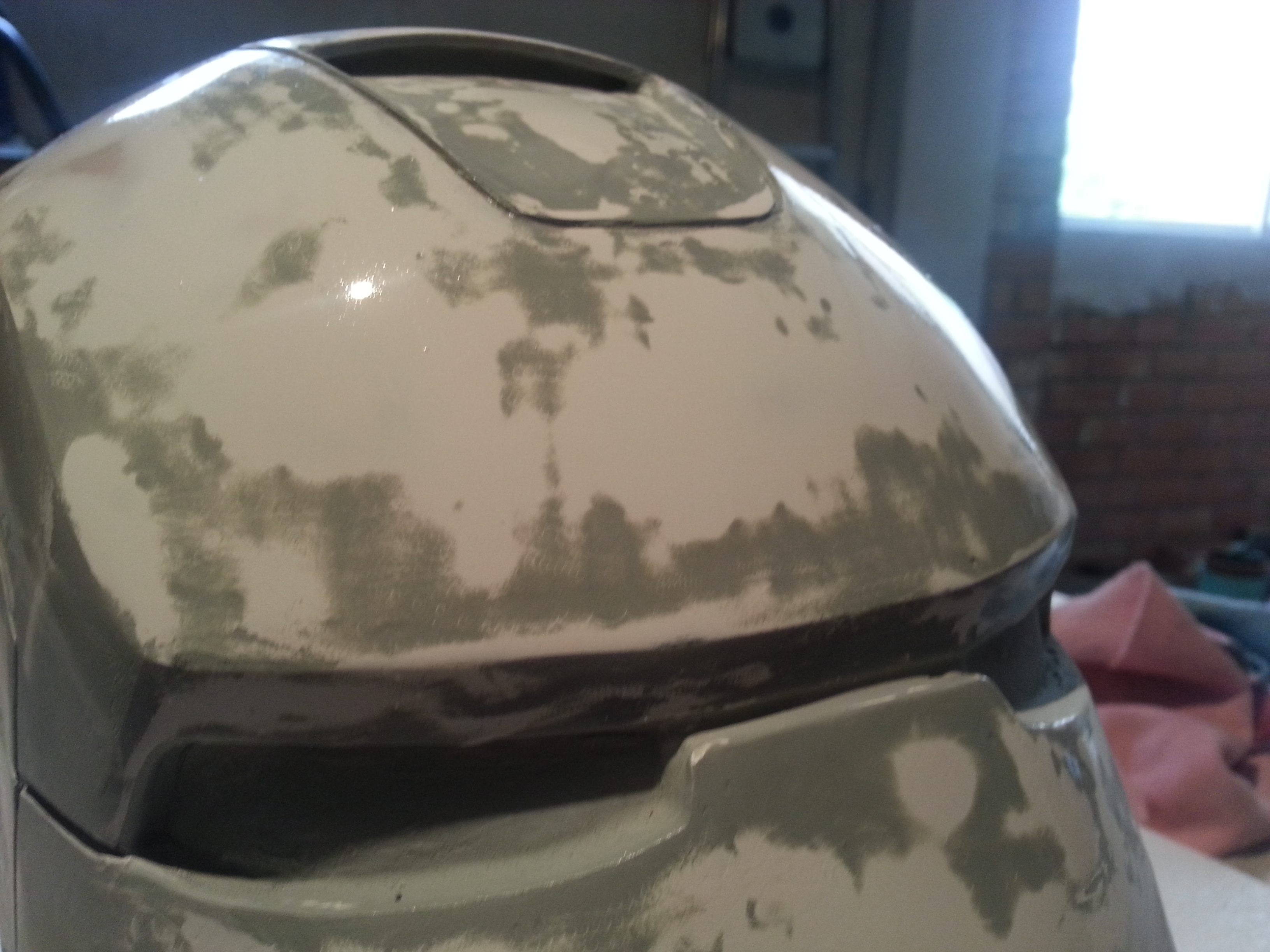

First of all, many thanks to sharkhead7854 for providing the model to Darkside501st!!! without any of you I wouldn't have started my helmet! this is the first I build and without a good model and a good pepakura file I would be lost!
So, this weekend I only could work in the helmet for a few hours, but I think I did a big step, I finally cut the back and the front of the helmet! :)
First I wet-sanded the entire helmet, the picture may look bad, but by hand you can feel it's very smooth. This time i did it by hand instead of using an electric sander:
Then was when I realized that it was foolish to continue sanding and smoothing as probably I would scratch the helmet during the cuts of the pieces, so I began to cut the back of the helmet. Once cut, I saw the deformation which caused the width of the helmet to contract. Probably I did something wrong with the faceplate, the lines I have marked should be parallel and they aren't:
Then, obviously I desperately had to try it to know if it fits! ( I hope you don't mind me being in pijamas :D )
You can see the helmet probably is too big for me... it's scaled to 1.05, probably 1.0 would have been enough, but thanks to the extra space now I don't have problems despite the stretching in the helmet :D
Then I finally cut the faceplate, this wasn't an easy task at all... and I did some cuts a bit wider than I would like... but I will correct this with filler:
So, now I have to fill all the gaps and sand it all again, then I will paint it with primer (and sand again). And I also still have to put the screw details! I hope I don't forget this!!
I'm still not sure if I'm going to cast it or not, it surely does cost a lot to do it. I think the cost of the silicone is about 25-30€/kg ( 15$/lb, or you will never know what I mean :D ). But I just want to be sure that if I drop it or if anyone decides to test it's resistance, I will be able to make a copy :D
Also, once done the mold, which is the usual material to do the copies? polyester resin and fiberglass again? or it's better to do it in polyurethane resin? I think polyurethane resin is cheaper, but is it strong enough?
BTW, I already have the paint, I have 2 spray cans of red and 1 of gold. How much paint does it take to do each coat? will I need more? I also bought 1 can of grey (titanium-like) and 1 can of black to do some details.
