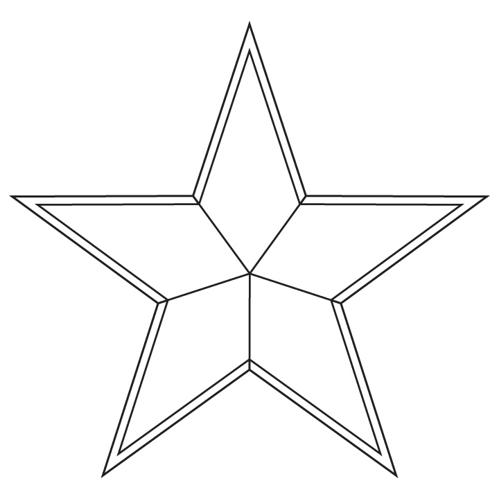

I've gotten some questions about the scoring of the star. First, attached is a template for the star. It's based on a 10" blue circle.
Here's the steps for making the star:
You'll need at least a 10"x10" piece of thin sheet aluminum. I'll get the exact thickness when I run to the store tomorrow. You'll want it thin enough to bend around the curve of the shield.
1) Take your sheet of sheet aluminum and drill a tiny hole in the middle. Tiny because it will remain in the middle of the star so you don't want it to be very noticeable.
2) Take a wood paint stir stick and pound a tiny nail in the middle of it. This will be your spinning arm that you'll use to create the spun lines. Like a propeller!
3) Place a piece of paint stripping pad (something like this Amazon.com: 3M 7413NA Hand Sanding Stripping Pad, 4.375 in x 11 in, Green, Coarse: Home Improvement) and wrap it around the paint stick. Put a nail through the hole in te paint stick and pound it through the hole in the metal sheet onto a piece of board. Now you should have a piece of aluminum with a paint stick "propeller" mail into the middle of it.
4) Now holding the metal in place, spin the paintstick and abrasive pad around in some circles. You're just trying to spin a light texture into the aluminum so don't get carried away.
5) Remove your propeller, and use the centerpoint of the star template to tape the star to the center of the template is directly over the hole in the aluminum.
6) Cut through the star template marking the star onto the sheet aluminum. Remove the paper and you should see the star marked on the aluminum.
7) Now with a sharp utility knife and a straight edge, begin scoring the outlines of the star. Go past the tips of the star. You are not trying to cut through the aluminum, just deeply score it.
8) Once the outlines are made you can hold the aluminum and gently begin to wiggle the aluminum along a score line. Don't force it too quickly. You're not trying to bend it. A little wiggling and you'll feel the scored line starting to give and the metal will snap cleanly along the line. Do this along each edge to break your star free.
9) The additional decorative score lines in the finished star are made with a broken tip of your utility knife and a straight edge. Again, don't go too deep. Drag the blade gently at first to make a mark, then repeat a few times to get the right depth. Start by making the lines from the hole in the middle of your star out to the inside corners. That makes the 5 radiating lines in the middle. The other border lines around the outside are makes with a felt tip pen (not a Sharpie) and etched with the utility knife.
10) I also found some round rivets around the workshop that I glues on the points, but you can omit those if you want.
Re: Metal Movie Cap Shield on a budget
Thank you for being so forthright with your build information, I really appreciate it. Sometimes people try to keep stuff a secret or just don't take the time to share like you are.

Thanks for the template of the star Valor, I redrew/traced my star after finding the center and taping it down. I just finished drawing the inside lines, it looks much sharper than before.
