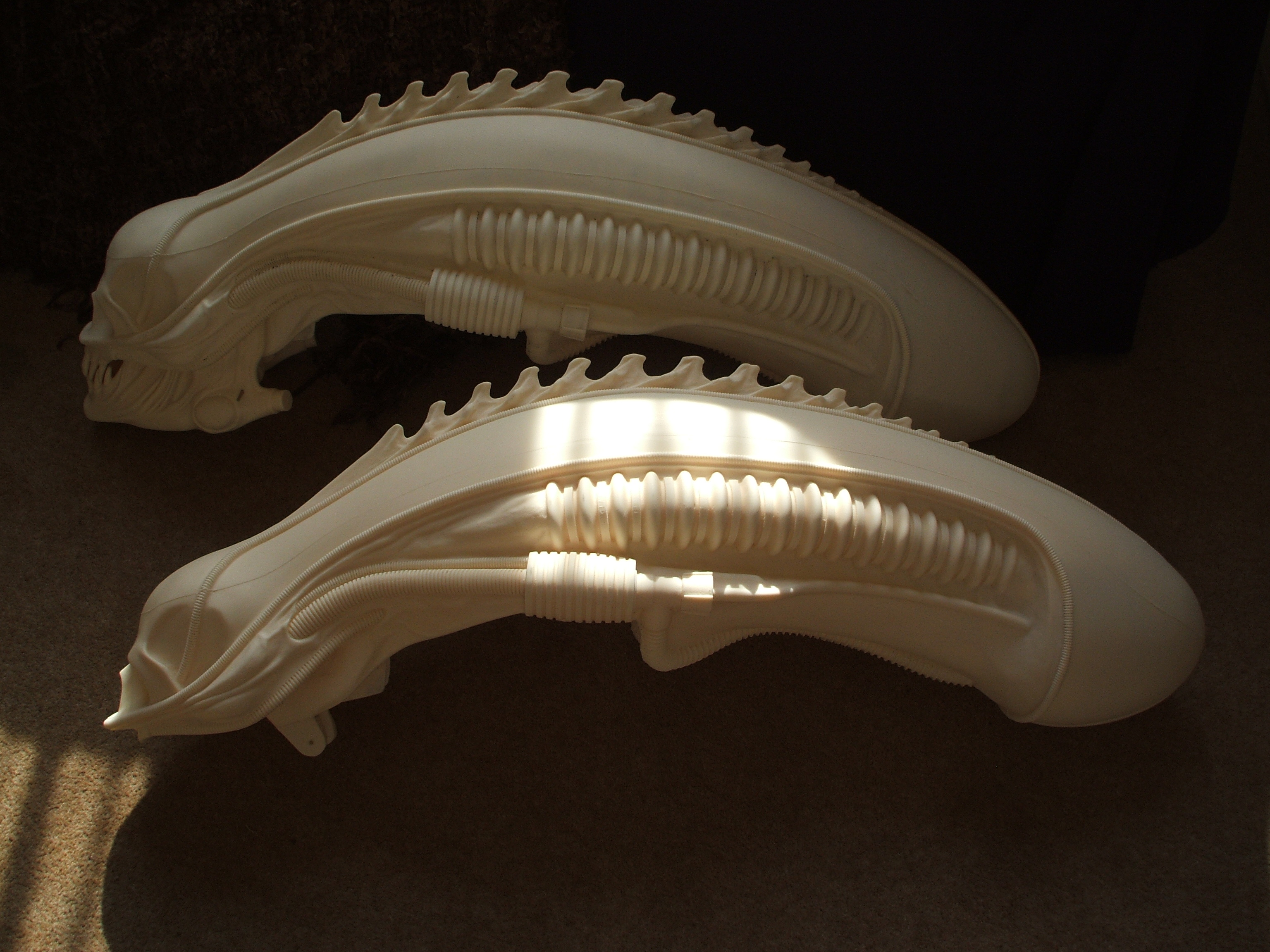

Right, the second cast is out of the mould & I've got some cleaning up to do where the mould leaked, of course its stuck to the fiberglass quite well :facepalm
Ok, I submit... I'll have to fab some help with the rotating! Overall its another great cast but this time the underside has come out a bit thin for my liking.
The thinnest area's are the two tubes on the underside that run from the middle to the back, other than that, its perfectly usable :) At the very least I can definitely use this one to build the buck for vac- forming the dome, the top & both sides are thick enough :)
I'm wondering if it might be wise to do the pour in two stages :unsure ie, I put a kilo of resin in, rotate & leave to cure for 10 mins, then cut the fill spout & pour the other kilo in :unsure ??? what's peoples thoughts on this?
Also, this may seem like a dumb question but... is it best to pour the foam before or after de-mould?? I'm thinking after so that the cast can be inspected for evenness first. But then that could cause distortion through the pressure of the foam expanding?? :unsure I've not used the A+B foam yet...

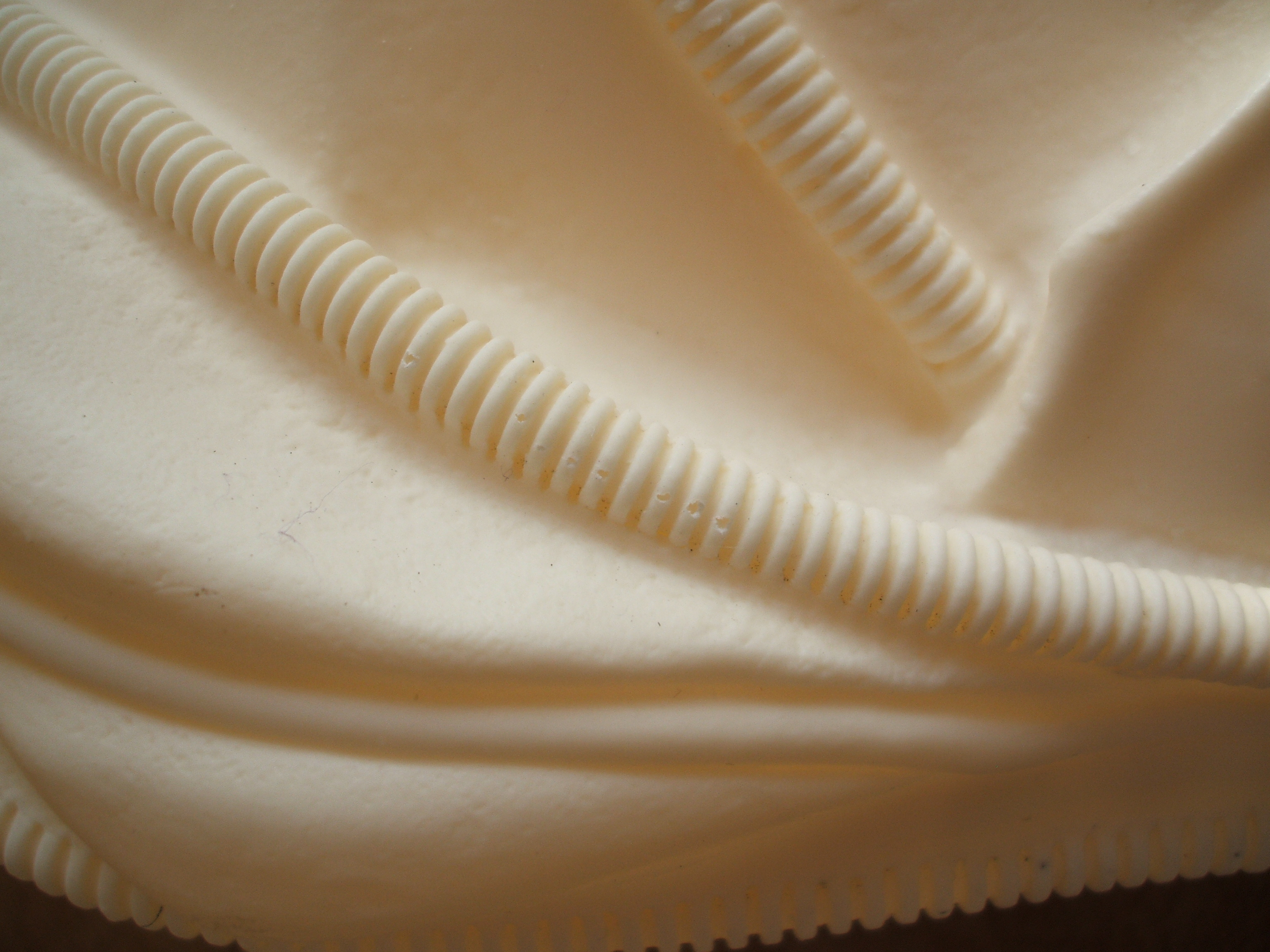

Anyhoo, heres a couple of pic's :
As you can see in the second pic, I need to dust the mould a little better next time! these are the only bubbles I've found so far :)

Leigh, some urethanes don't adhere well to themselves, but I have castings done in layers as you propose where this is the case...and it doesn't matter. The second layer can't really separate even if it doesn't stick perfectly, and does add strength. If you then fill with foam, you should be fine.
That said, I take back what I said earlier about re-seating the first cast in the mould. I forgot about all that ribbed-for-her-pleasure tubing. :lol It would be easy to crush some of that detail - silicone can crush, and once done there is no fixing it.
Astonishingly bubble-free work. :thumbsup
