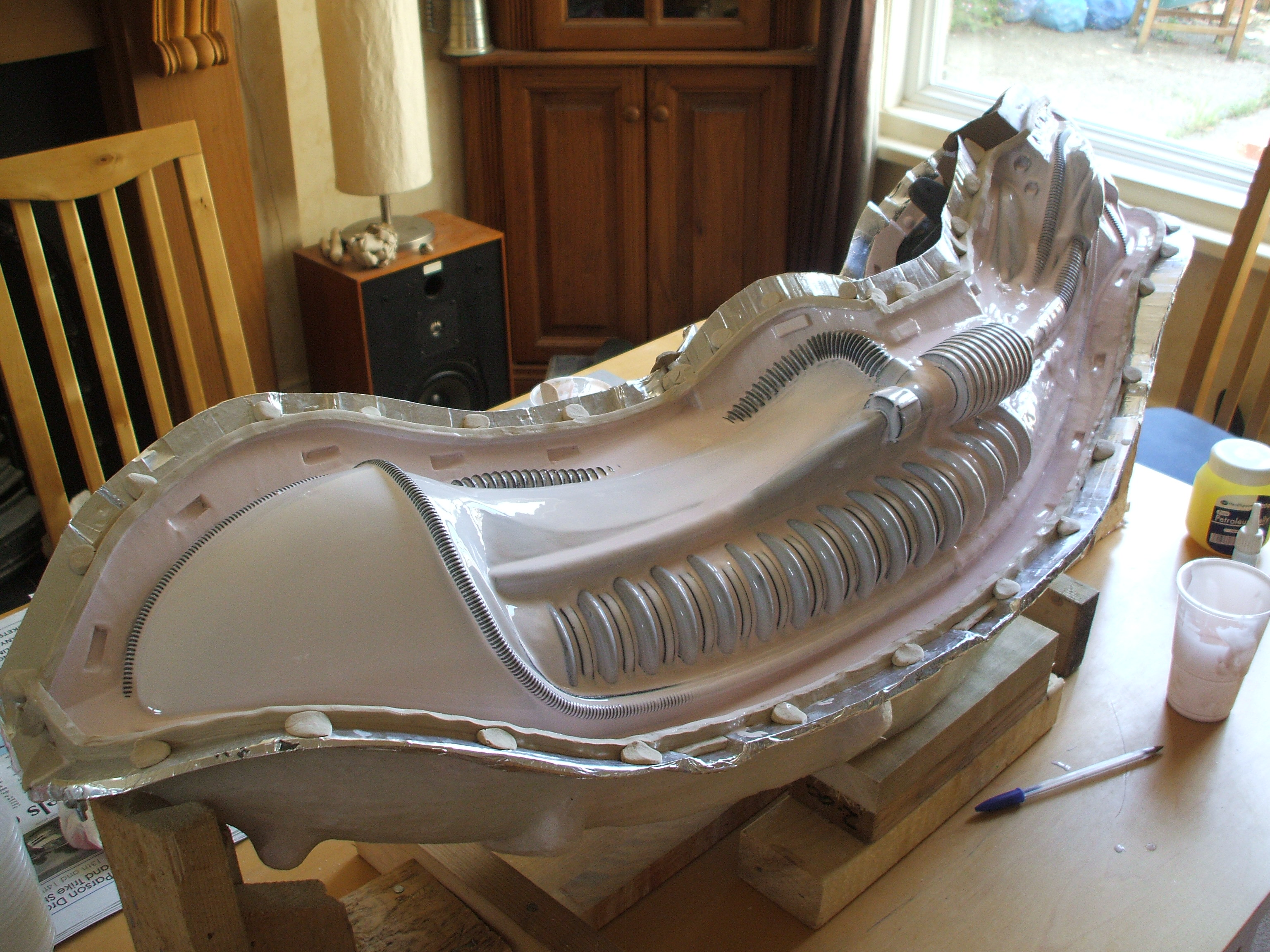

Yeah, that 4th piece is all about mould longevity. You can see the hinge points for the jaw & the tongue (sticking up) there are also some quite deep area's either side to clear the jaw as it closes into the head. If I had built the mould in two half's I would have had to try to pull the mould over & out of that lot from the side, I can only see that leading to rip's & damage to the mould.
The way I've done this is in an effort to reduce as much ware as possible, by having as many of the undercuts as possible pull directly away without trapping.
It is alot more work I expect. As I understand it, addition cure silicone it tougher & longer lasting but more expensive. I'm using condensation cure, so I'm being as cautious as I know how :)
The other advantage to me is, if I choose at any point to make a GRP head I can close the 3 main parts up & lay glass & resin through the large hole left open by leaving the 4th part out. I can then lay up the front area of the 4th part & bond it in afterwards :)
Well, that's all the theory anyway :lol

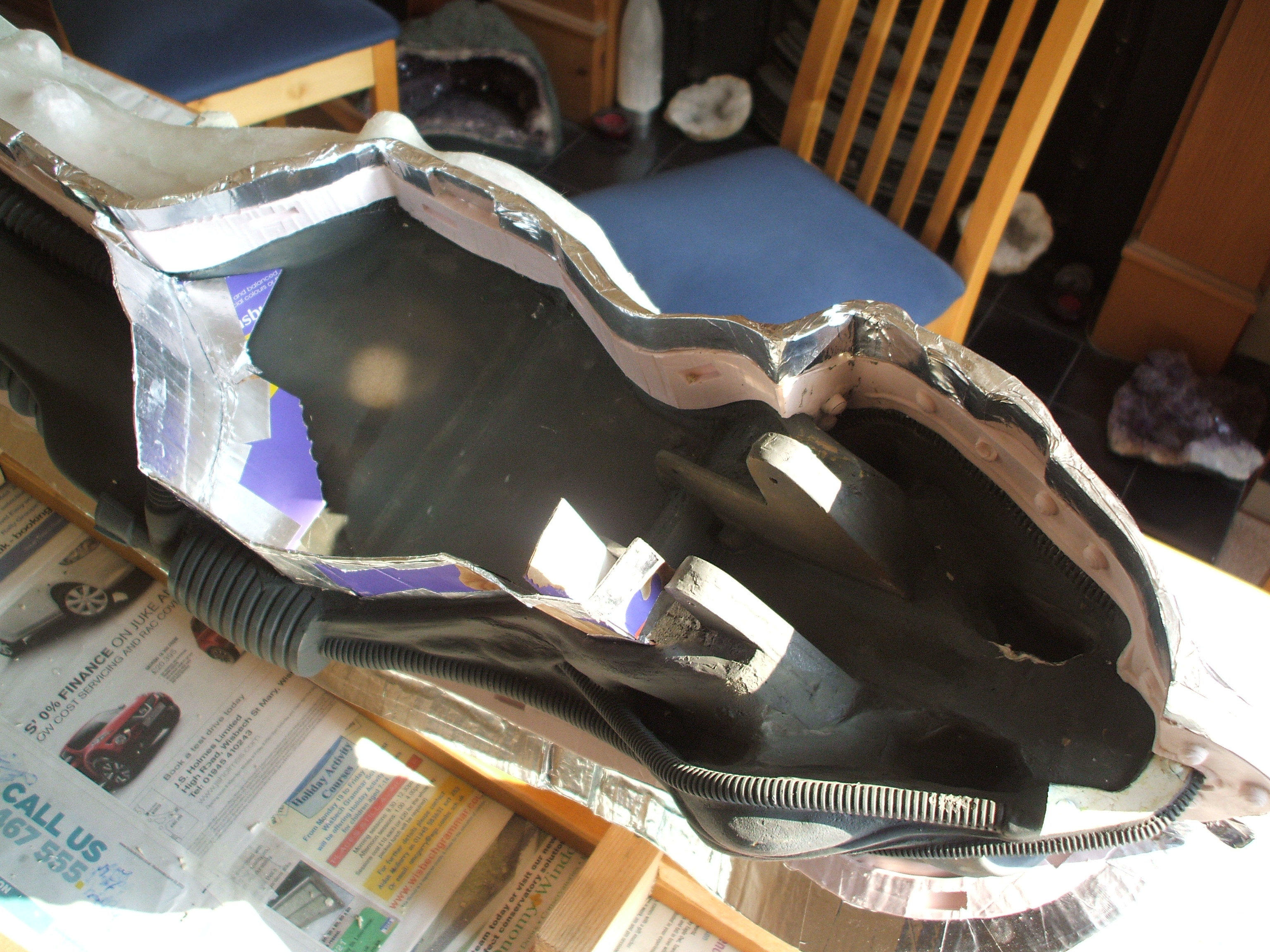

Started on the other side today. In this heat the rubber's going off much quicker! I'm having to knock up only 100-150 grams at a time rather than 200 grams.
Its gonna take me all day again :)
That's the first skin coat, got another one of those & then I can start applying the thixo coats :)

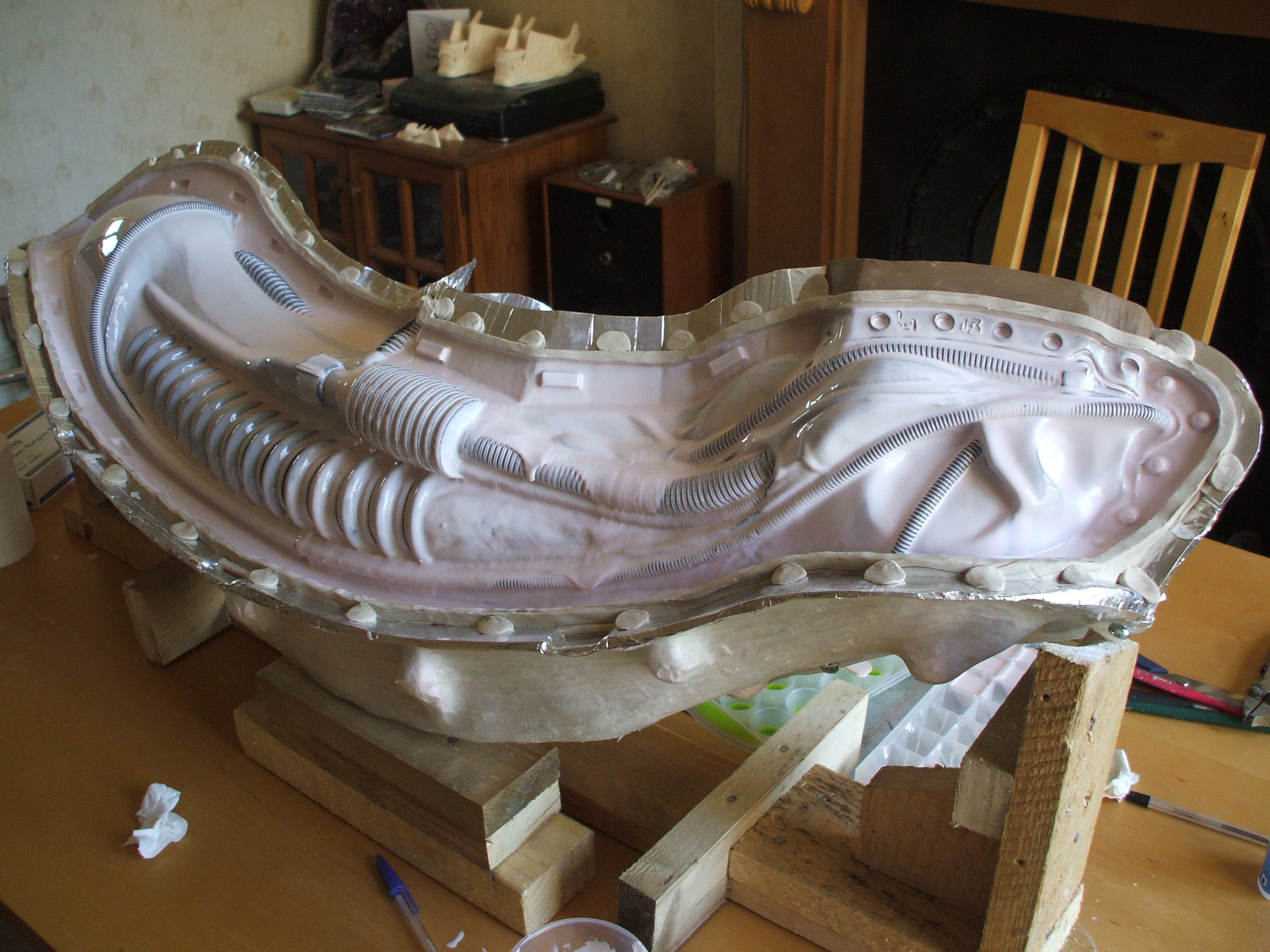

I'm still at it :sleep Just finished bulking it out with the thixo, got another 2-3 thixo's & then one non-thixo & I'm done :)

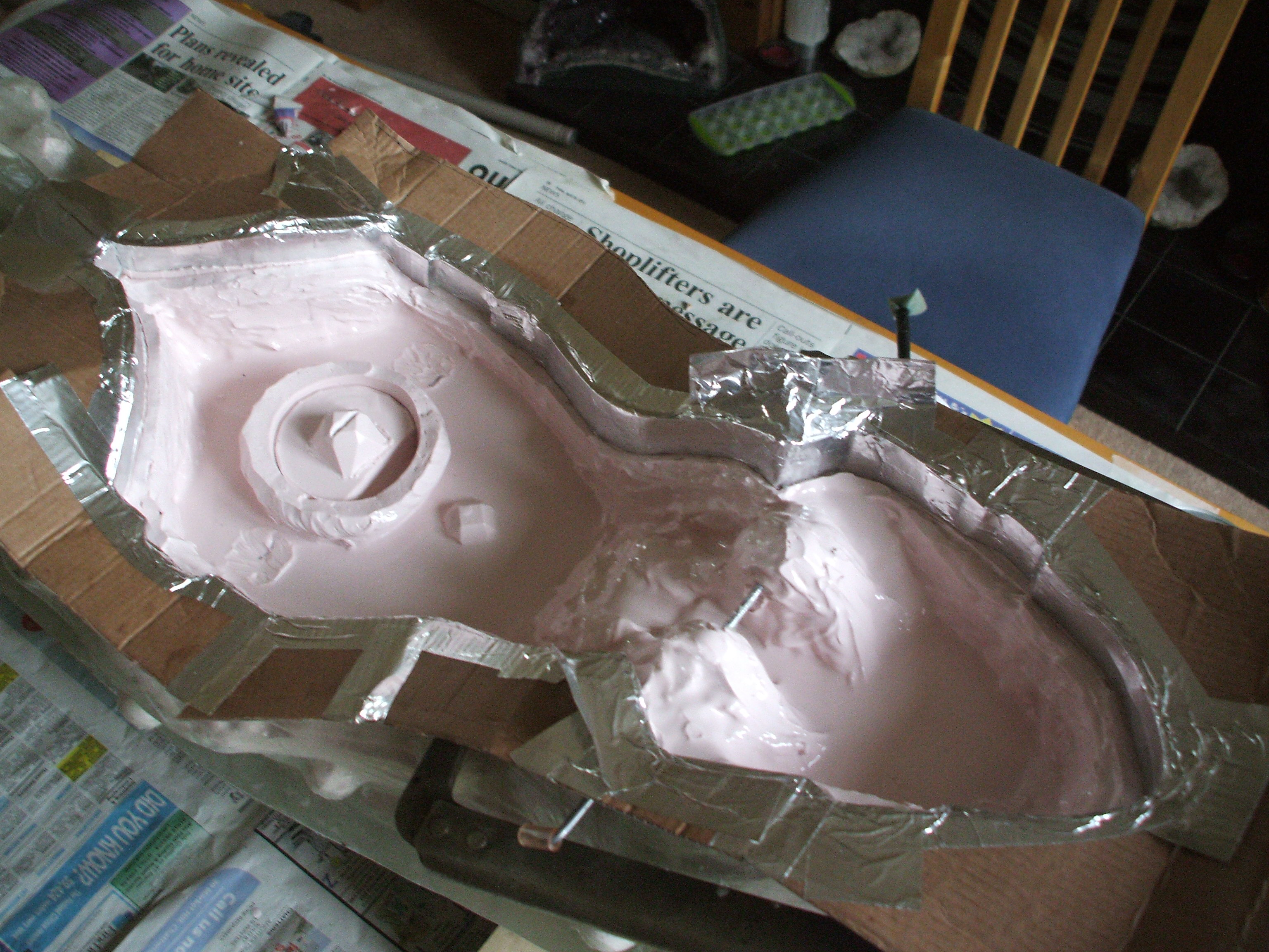

OK, I've made the last rubber part of the head mould :D
I was worried that it might leak down between the model & the other mould parts while I was pouring it but it came out great with no leakage at all :D

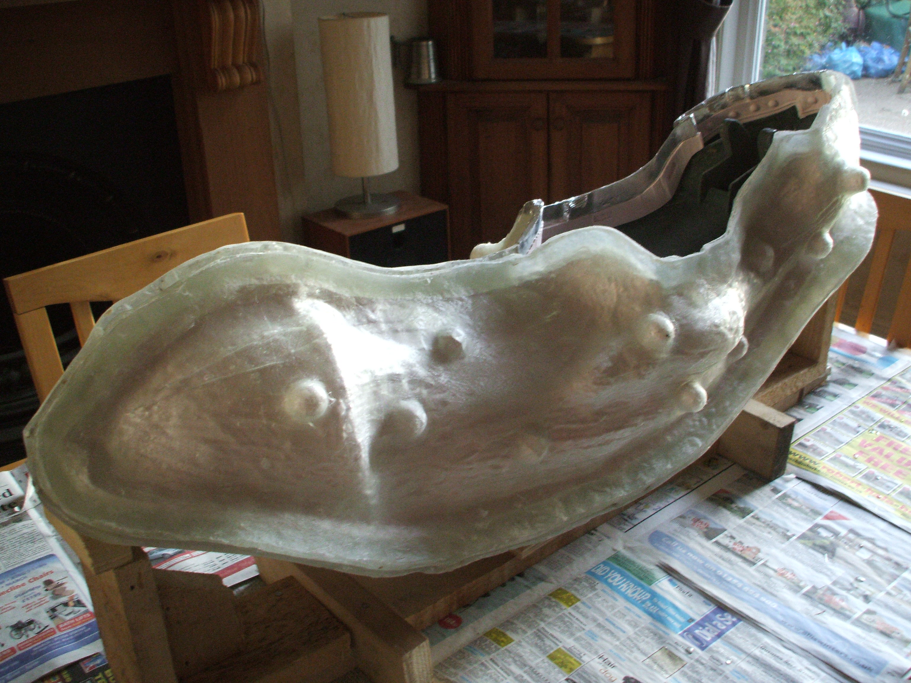

I left that for a good day to cure & I've just finished laying up the fiberglass jacket for this part.
I'll let that harden & then clean up the edges before I post pic's of that :)

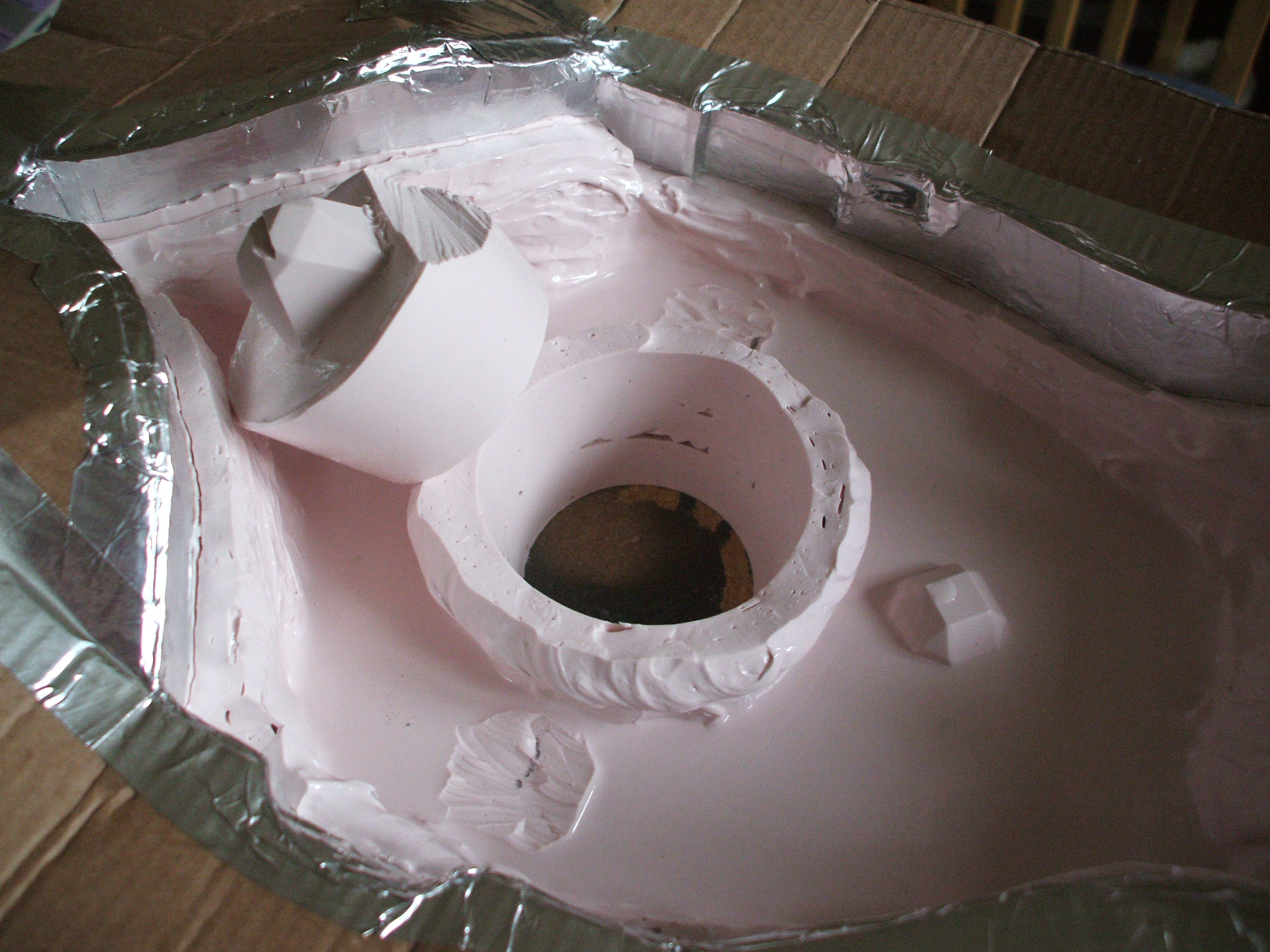

Here's the pic's of the rubber part:
I've made the pour spout by gluing a small disposable smooth sided plastic cup to the underside of the head & then pouring the rubber around it. I also poured some inside it for a plug :)
