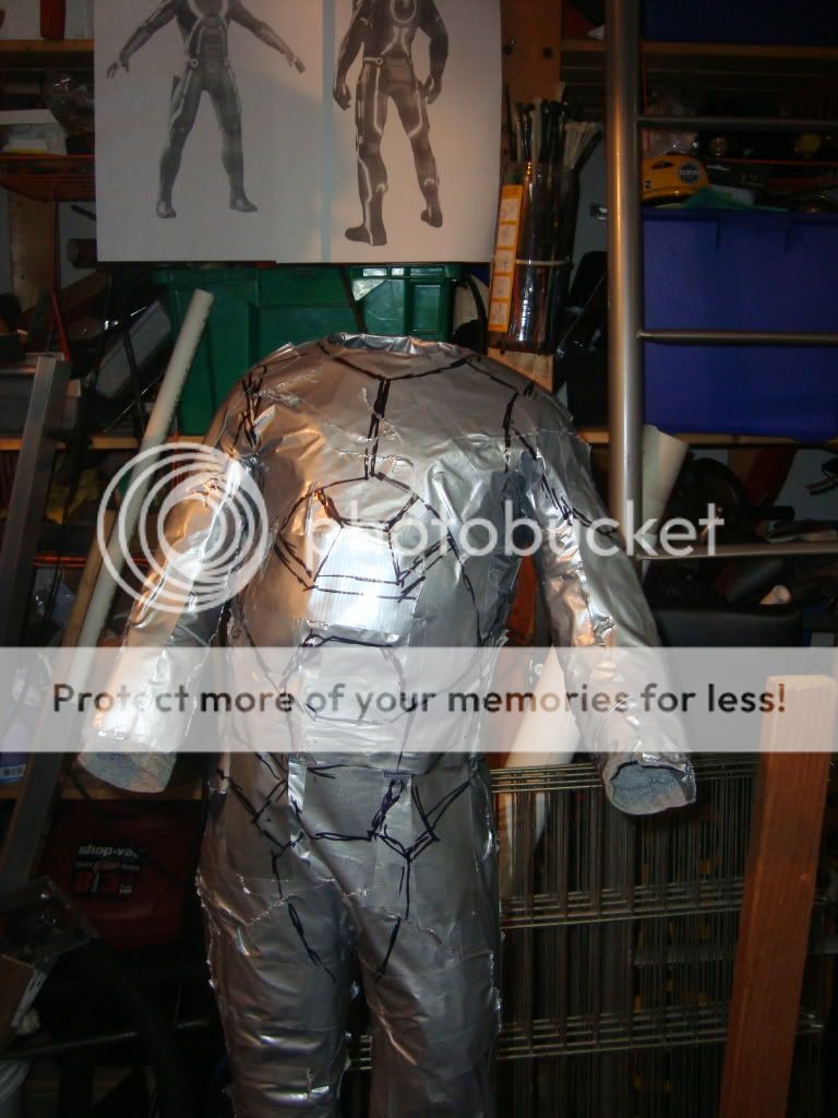

I started by wrapping my kid in duct tape. I stared at it for a day and wondered how to lay that first layer of foam. That will determine how he will get in an out and where the fabric will be shown. I resorted to sketching the panels on the mannequin and that gave me a sense of scale. I will then cut out the panels in construction paper to tweak the shape before using it as a stencil for the actual foam piece.

I'm keeping the dummy as is and laying the panels on top. I'm not cutting it up because I still need it for sizing. The foam I have has a smooth plastic finish, so I don't need to paint or plastidip at all.
I used the same method to build the sentry costume.
First I cut out the panels onto construction paper and trim it till the proportions are correct. Then I use the paper as a template for the foam.

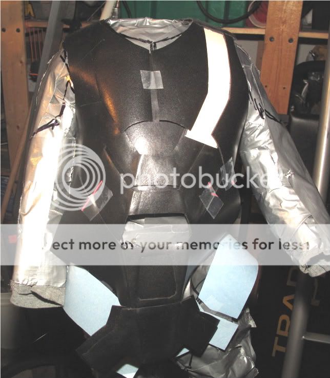

Here's the front panels I cut out so far. I'm not gluing it on yet, because I still need to cut the channels for the EL strips.

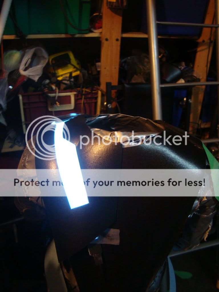

I cut some panels that overlay the EL tape on the shoulder.
Mocked up to see what it's like lit up. I had to shallow out the angle of the chest to utilize a single 1.5" El strip.

Use an old long sleeve T-shirt and pants. Wrap the duct tape on top. I used an entire roll. Then use some blunt scissors (emt shears) and cut slits to get him out. Then add more duct tape to close off the cut areas. Stuff it with some old clothing and you have a mennequin.
Made a little progress tonight by starting to glue the panels together with hot glue. Still need to hit up Gymboree for some tight fitting black undershirt and pants.
