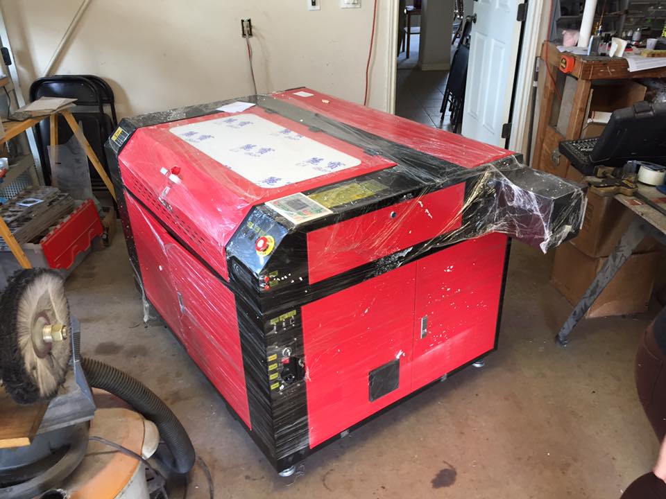

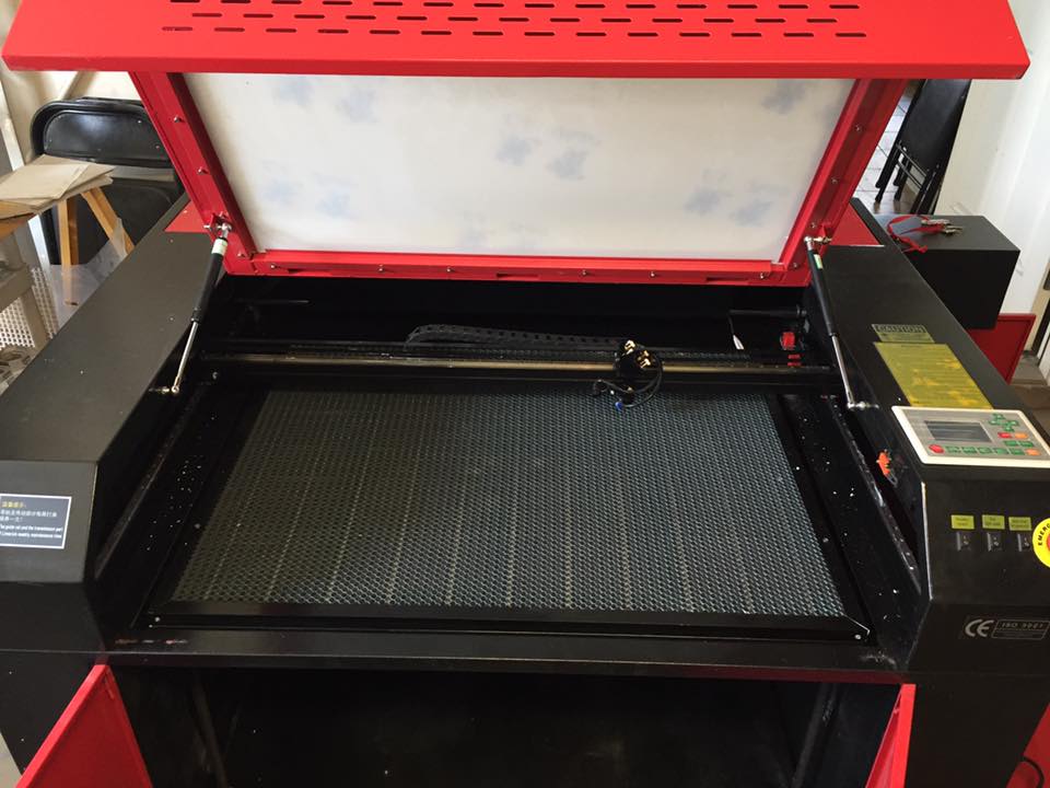

I started working on this project apparently 10 years ago. The main thing holding me back was the lack of a laser cutter capable of doing what I want. This week that obstacle was removed when I bought a huge laser machine.
14264080_10154549106267342_6080137975206851169_n.jpg14316942_10154549106442342_6803293073953407039_n.jpg
So now I can finish this project finally.

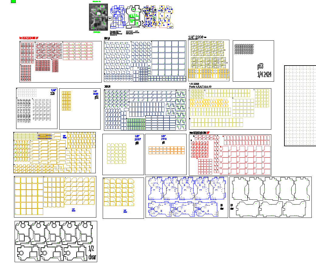

Spent the whole weekend working on preparing the files for the laser cutter.
Will update as I progress.

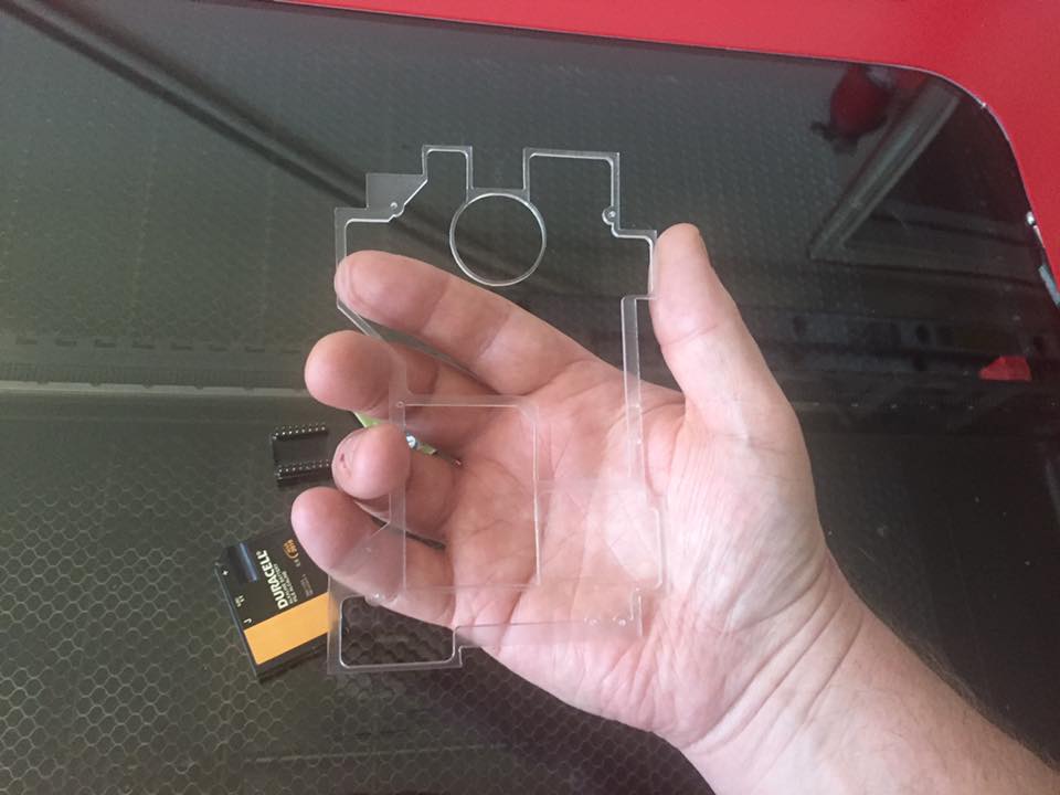

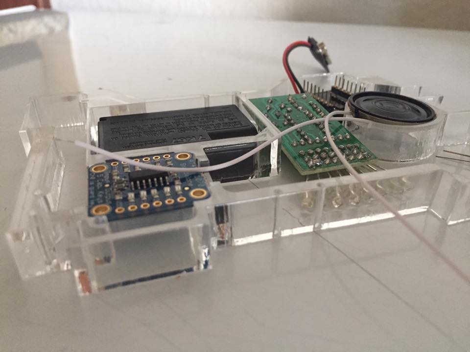

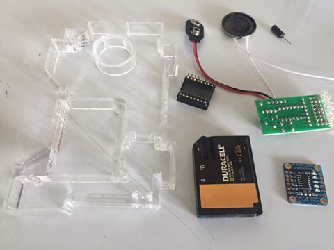

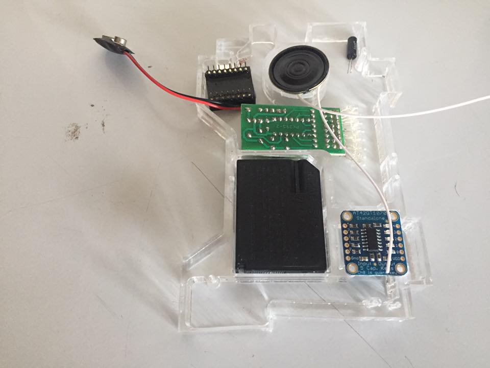

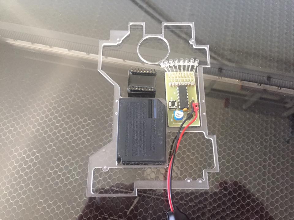

Did a test in 1/2 inch acrylic. I made mounting brackets in the handlink body by varying the power the laser uses. This gives me nice mounts that fit perfectly to the components. Still not done designing the electronics compartment. But you can see how it is shaping up.

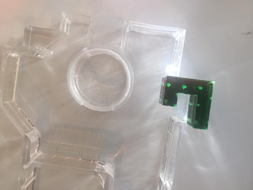

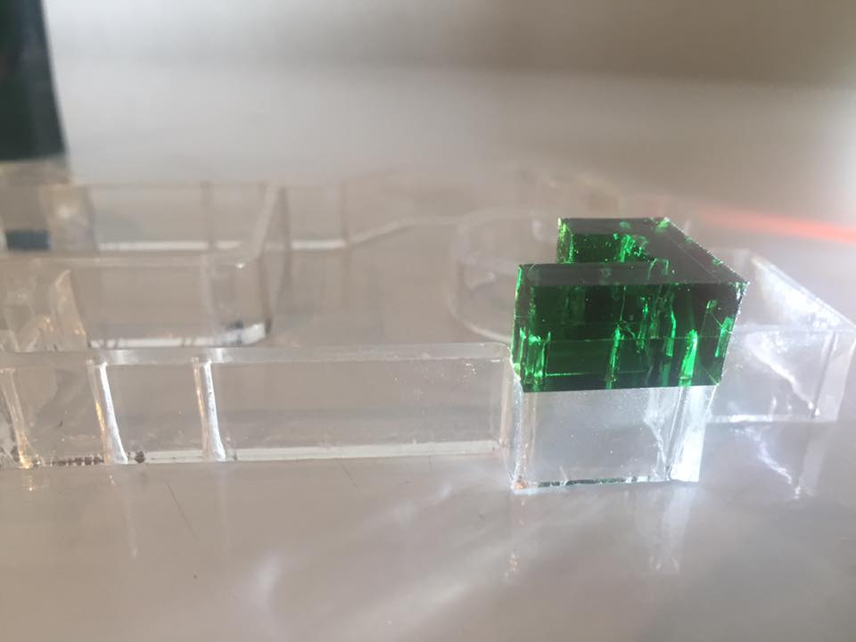

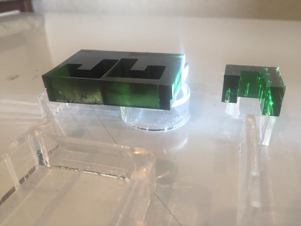

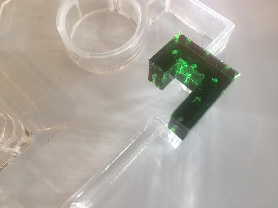

I have not ordered the correct green acrylic yet, so I used some of the darker green for this experiment. It is hard if not impossible to get transparent color acrylic in 12 mm thicknesses. So I had this idea to use acrylic fish tank cement to sandwich together 2 sheets of acrylic then after they cure for 10 minutes cut the part out and see how it looks. Pretty impressive result.
