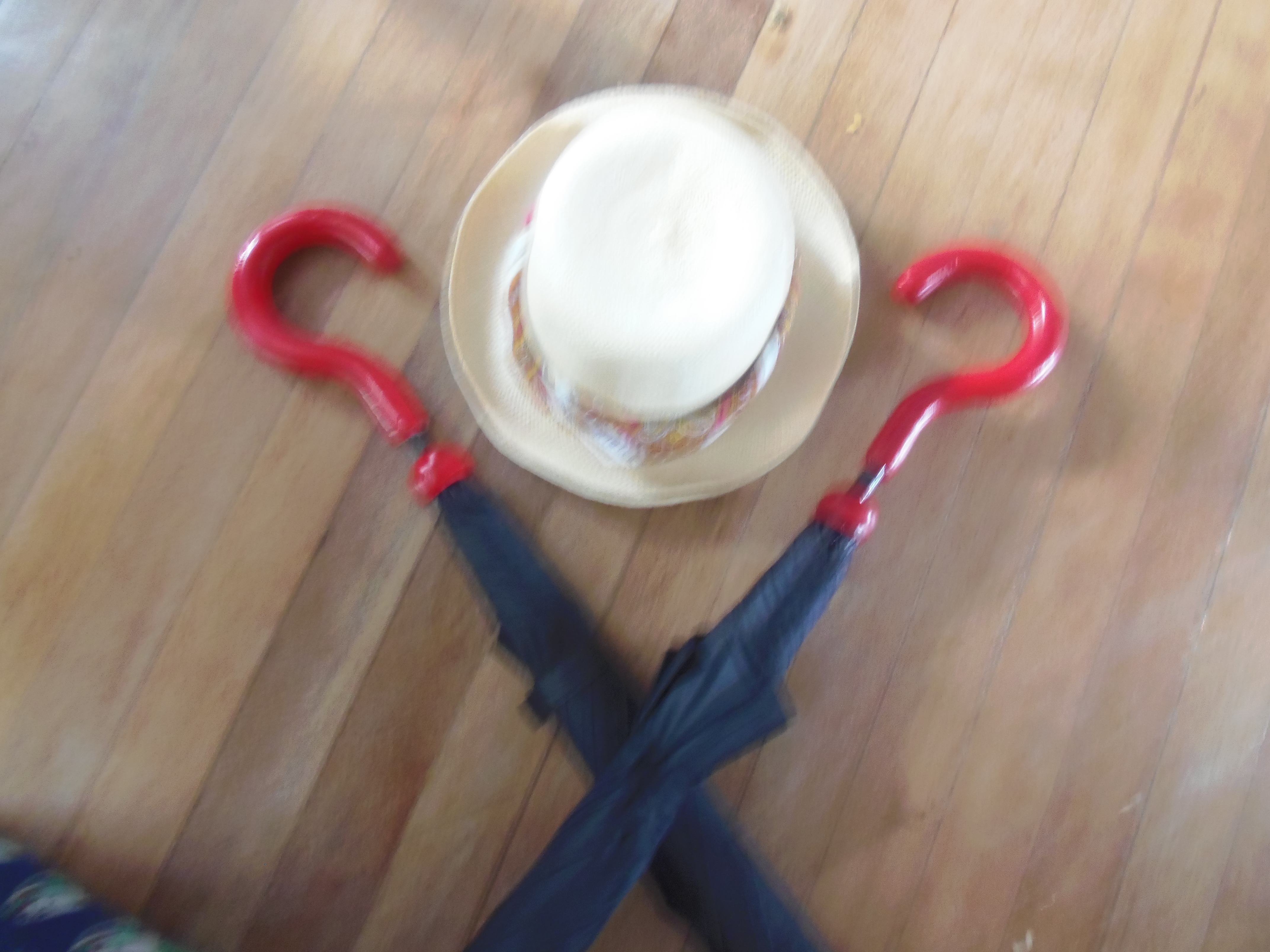

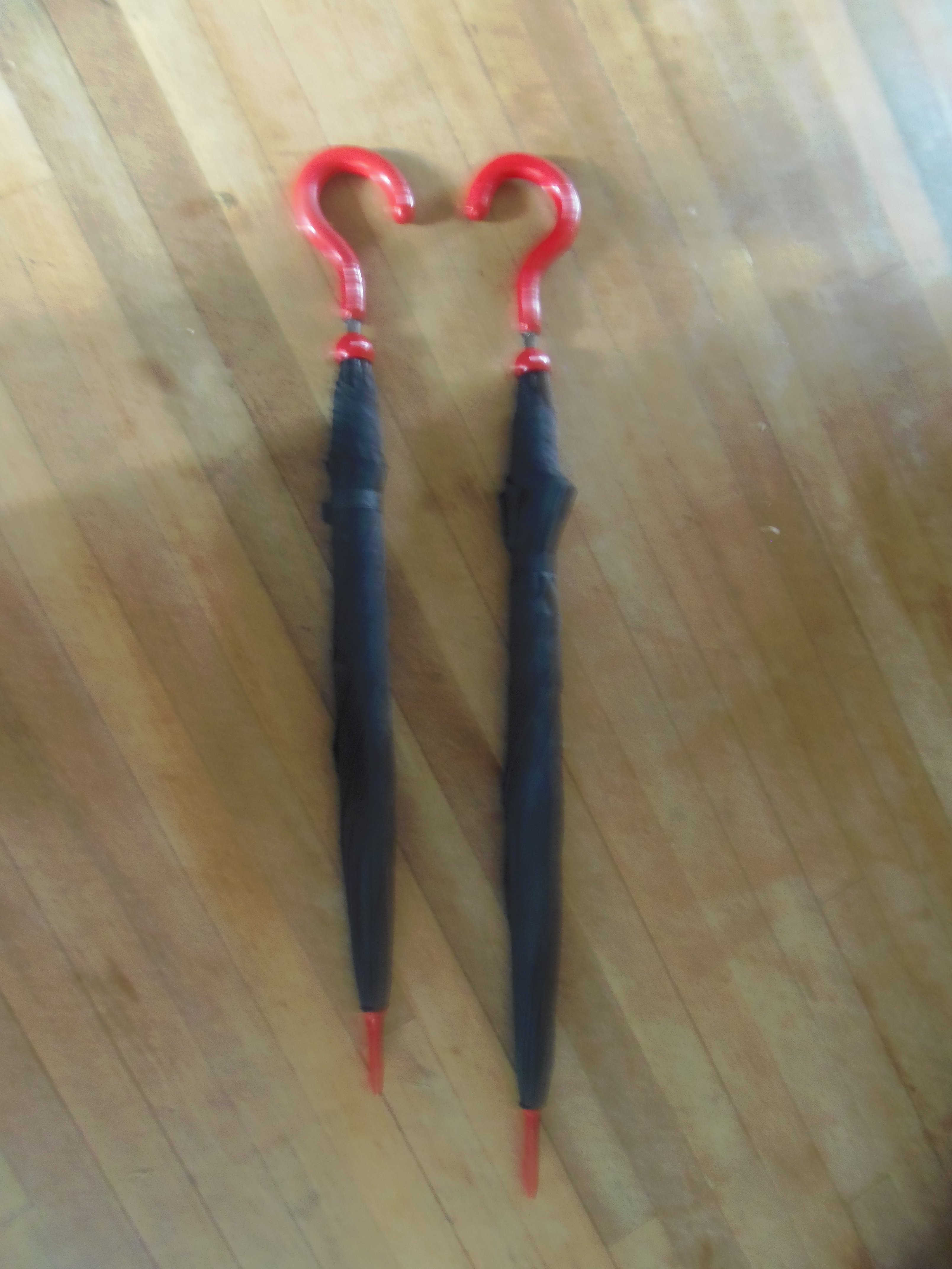

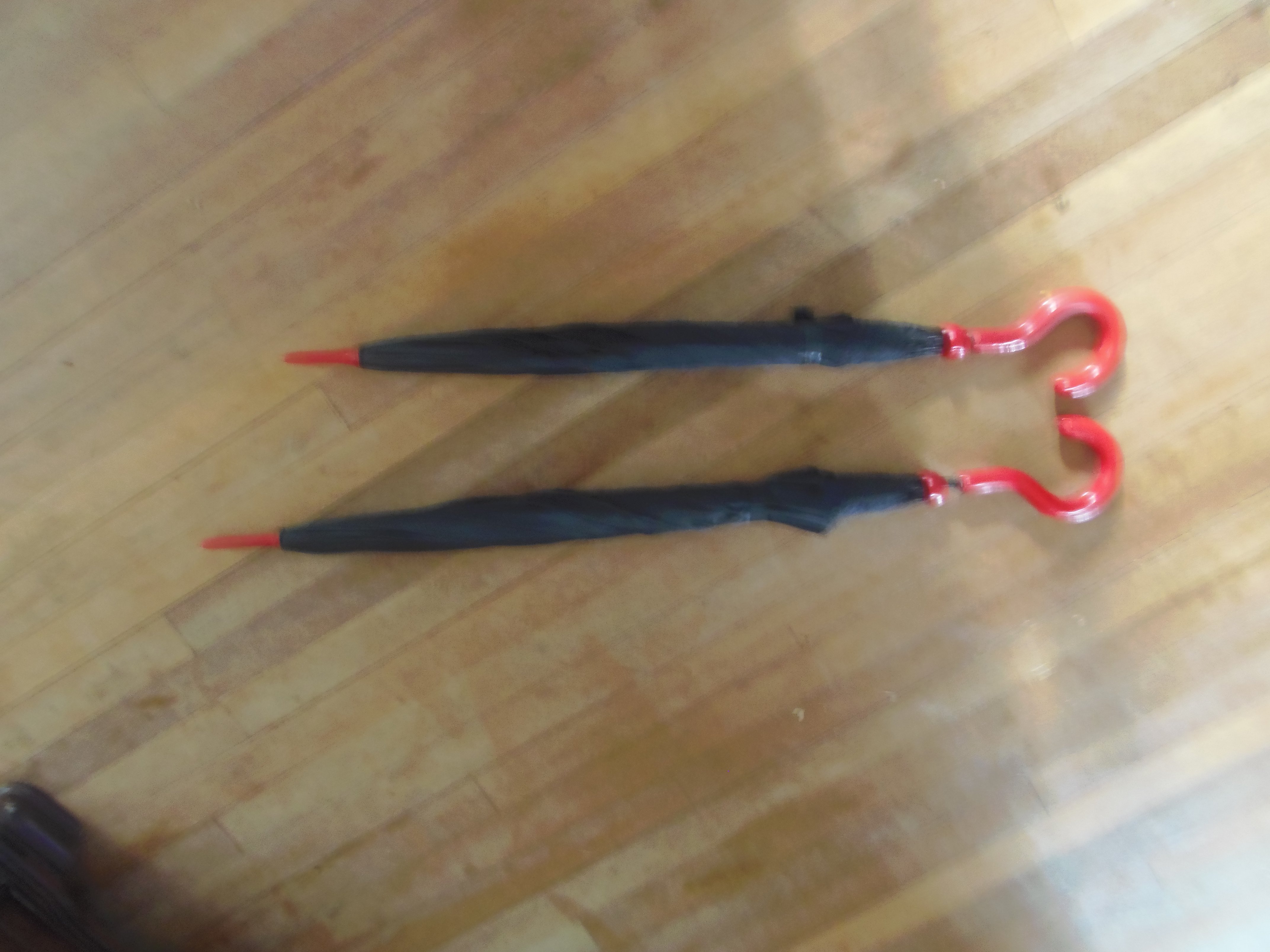

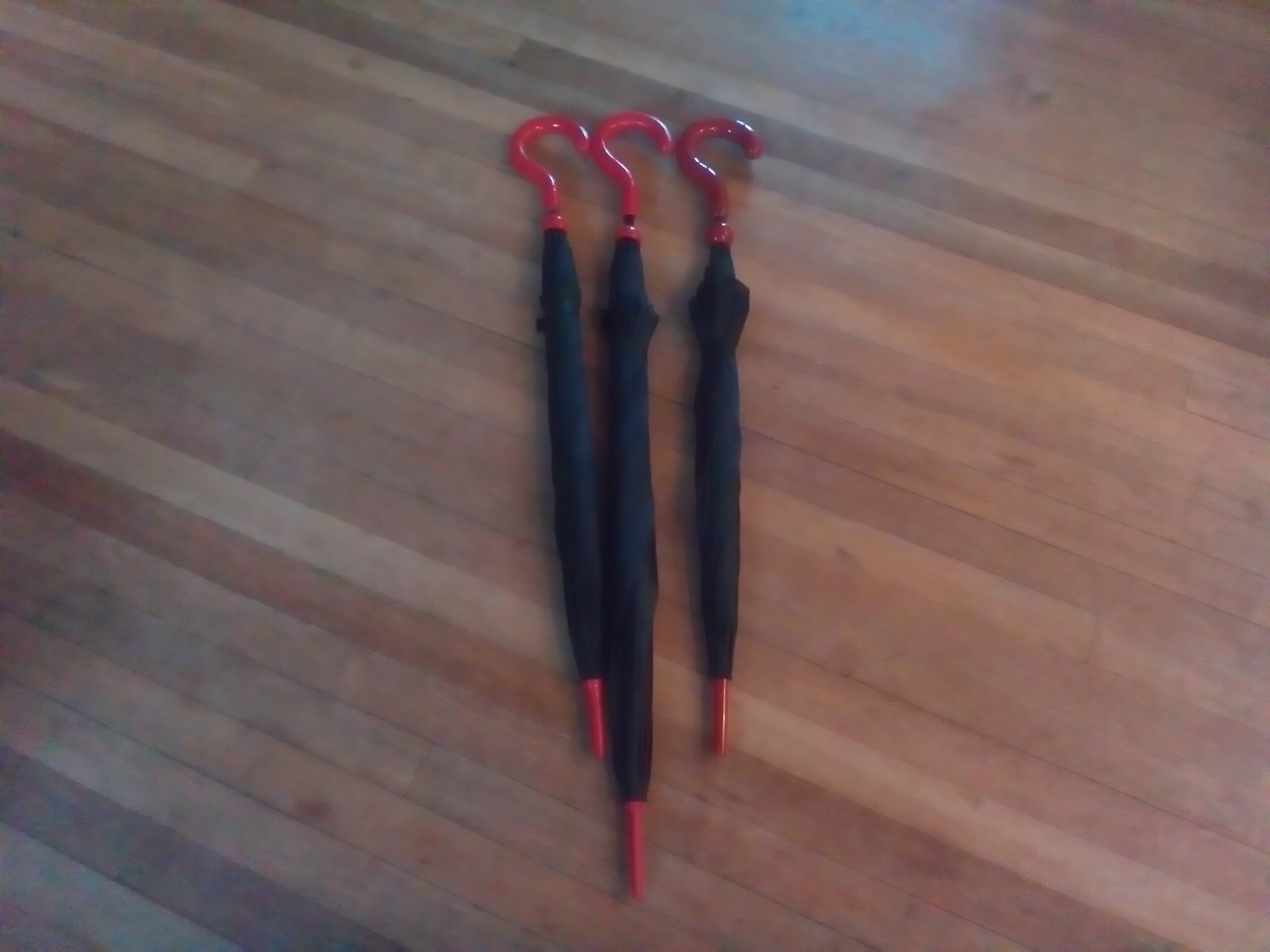

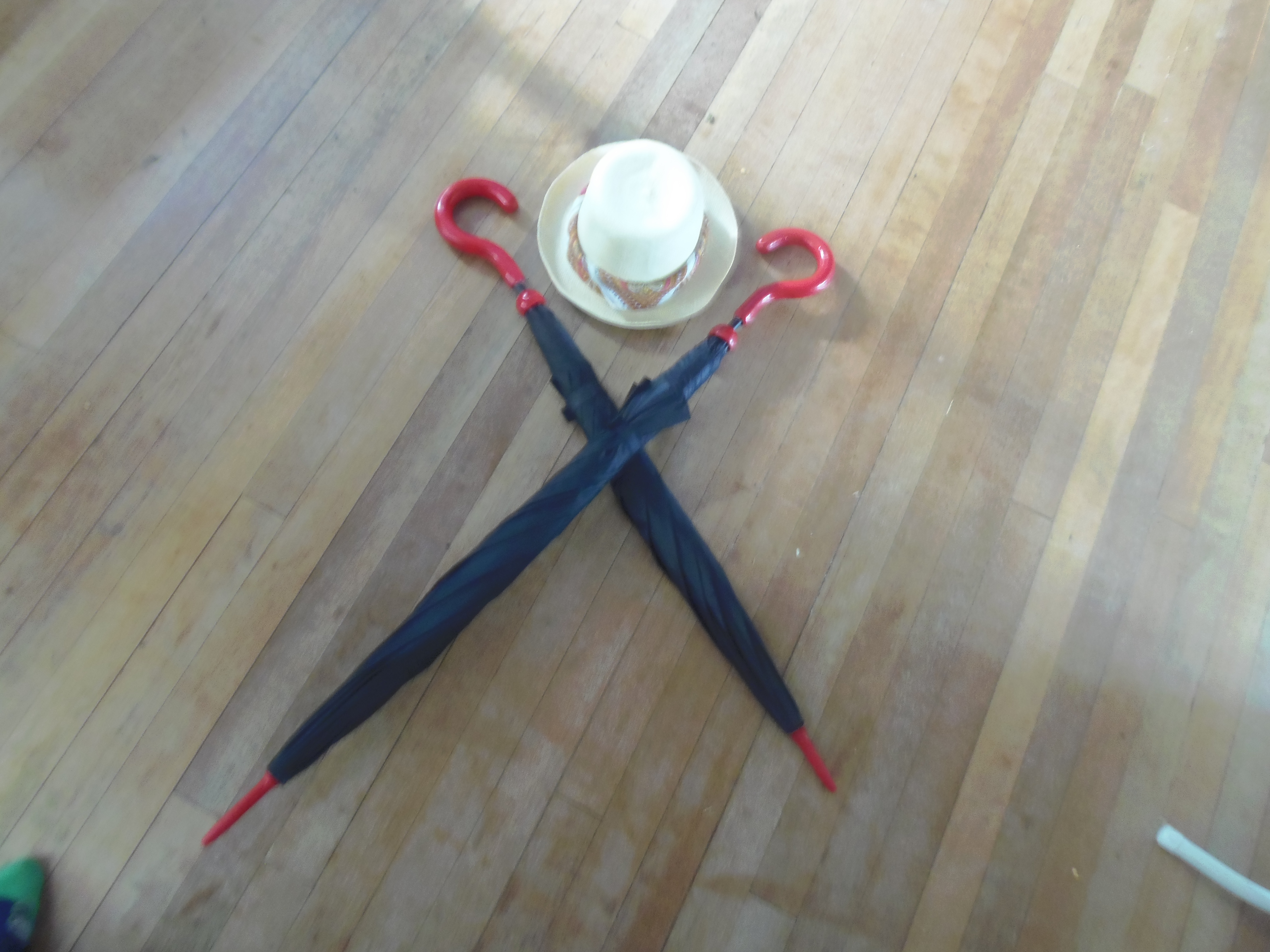

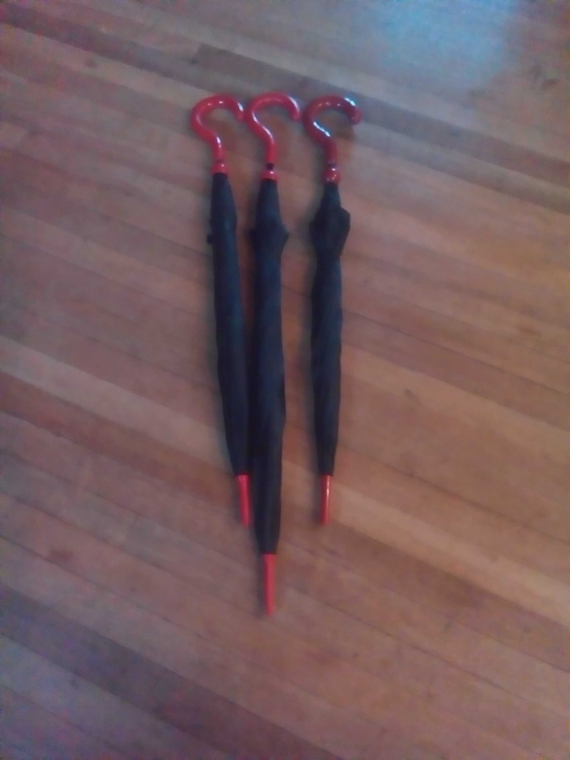

PA110001.JPGPA110002.JPGPA110003.JPGPA110004.JPGPA110005.JPGFinished my umbrellas late August, ended up making two (i broke the first one make a second one then fixed the first one) one of the umbrellas is slightly bigger and there isnt gloss on all of it so I still have a bit of finishing off to do.
Not sure if you know about this but in September AbbyShot released a official doctor who sylvester mccoy umbrella and it probably cost about half the amount of all the materials.

My two umbrellas (on the left) and the official one (on the right).
