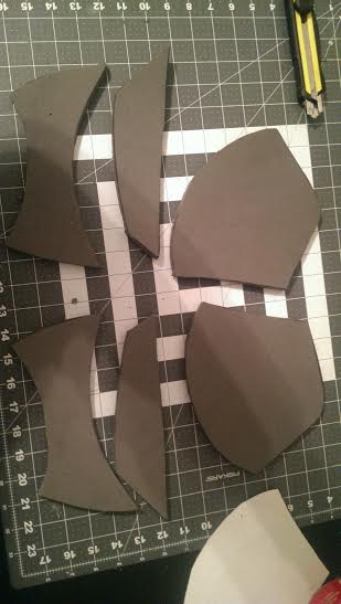

first off was the torso, I used these templates for the chest

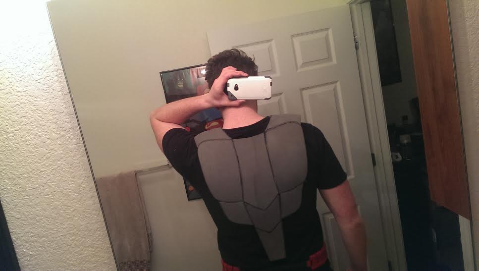

I then cut out the abs and back, then strapped it together

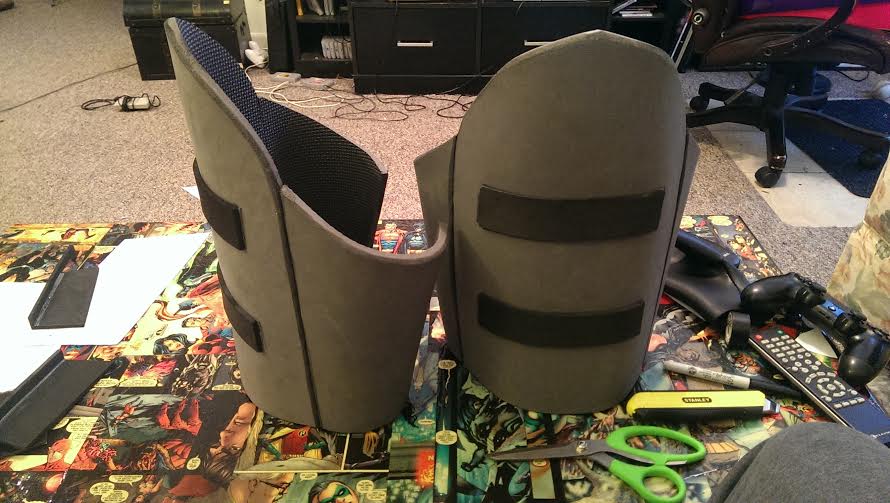

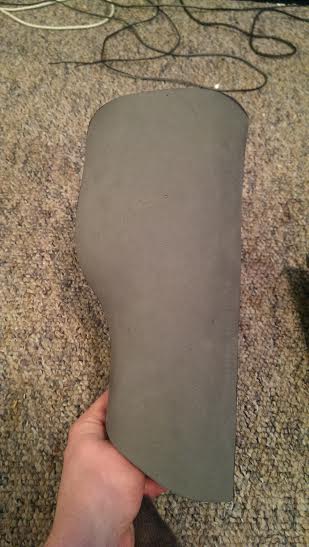

Here are a few of the other pieces after heat forming.
I glued them together and started to detail it with thinner foam.

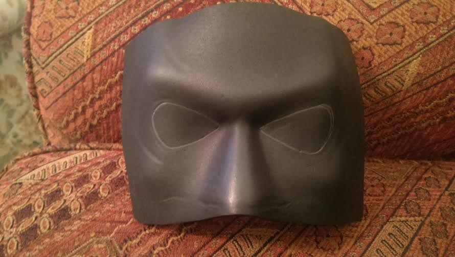

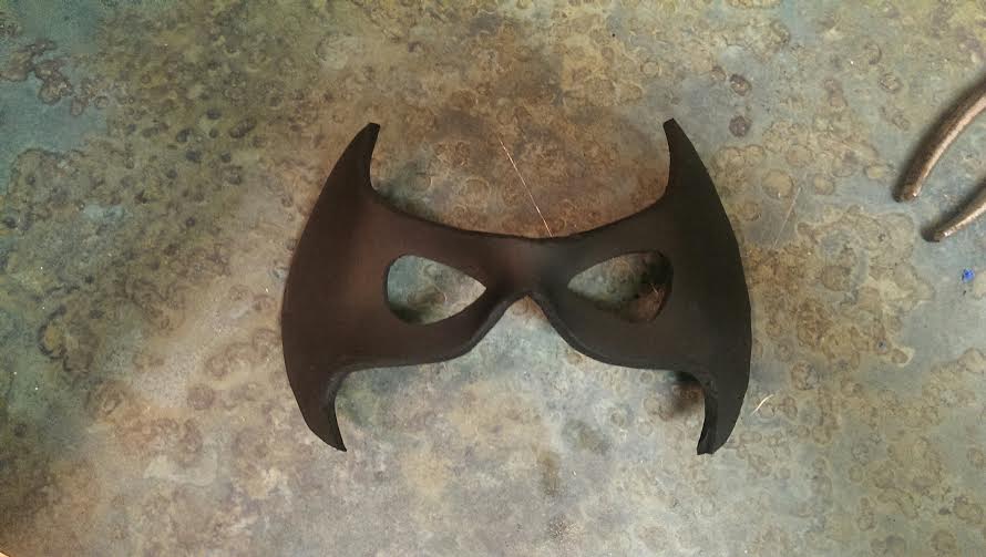

For the mask I heated some 5mm foam and sandwiched it between 2 plastic batman masks, then cut down to size.

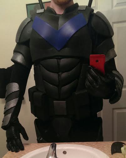

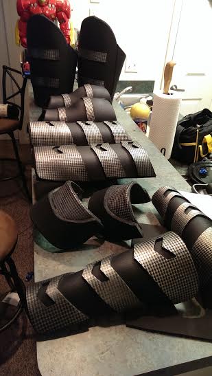

I then plastidiped all the pieces black
Using shelf liner on certain areas I sprayed silver to get a carbon fiber effect

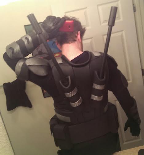

For the escrimna sticks I cut a paint roll extender in half for the base, then detailed it in foam and cut the cap off a paint roller and glued it to the end so it could screw together and form a bo staff.
painted black

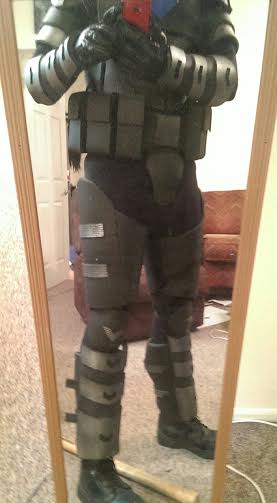

Here is the completed armor
9bc0afe5-8a66-4fb9-a590-21ebddd3b2b8.jpgab7b218c-8019-4596-9ab6-3918e73ea174.jpgb45227cc-4a11-4275-918a-9b1310b61961.jpgbc1d289f-8bd3-4db5-a7cb-5f509eaa24cd.jpg

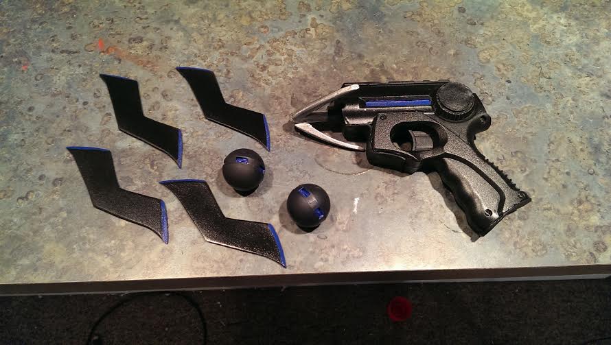

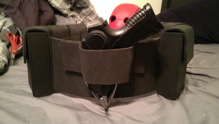

here are a few pictures of the belt and the gadgets
282487c4-a0a3-4c7a-a0c8-8b982622acc1.jpg268654f3-786a-444a-b783-1af545ae773b.jpgab91b57b-aa75-46da-9084-1e288a655076.jpg
The Wingdings are made of balsa and the smoke pellets are sneaker balls cleaned out and painted black and blue. The Grapple gun base is a nerf gun cut down to size using a dremel and the hook itself is made of wood. I used a retractable badge clip to make the hook able to go in and out.

The shoulder was attached to the chest armor using elastic and the back was connected using Velcro so i could get it on and off. :)
