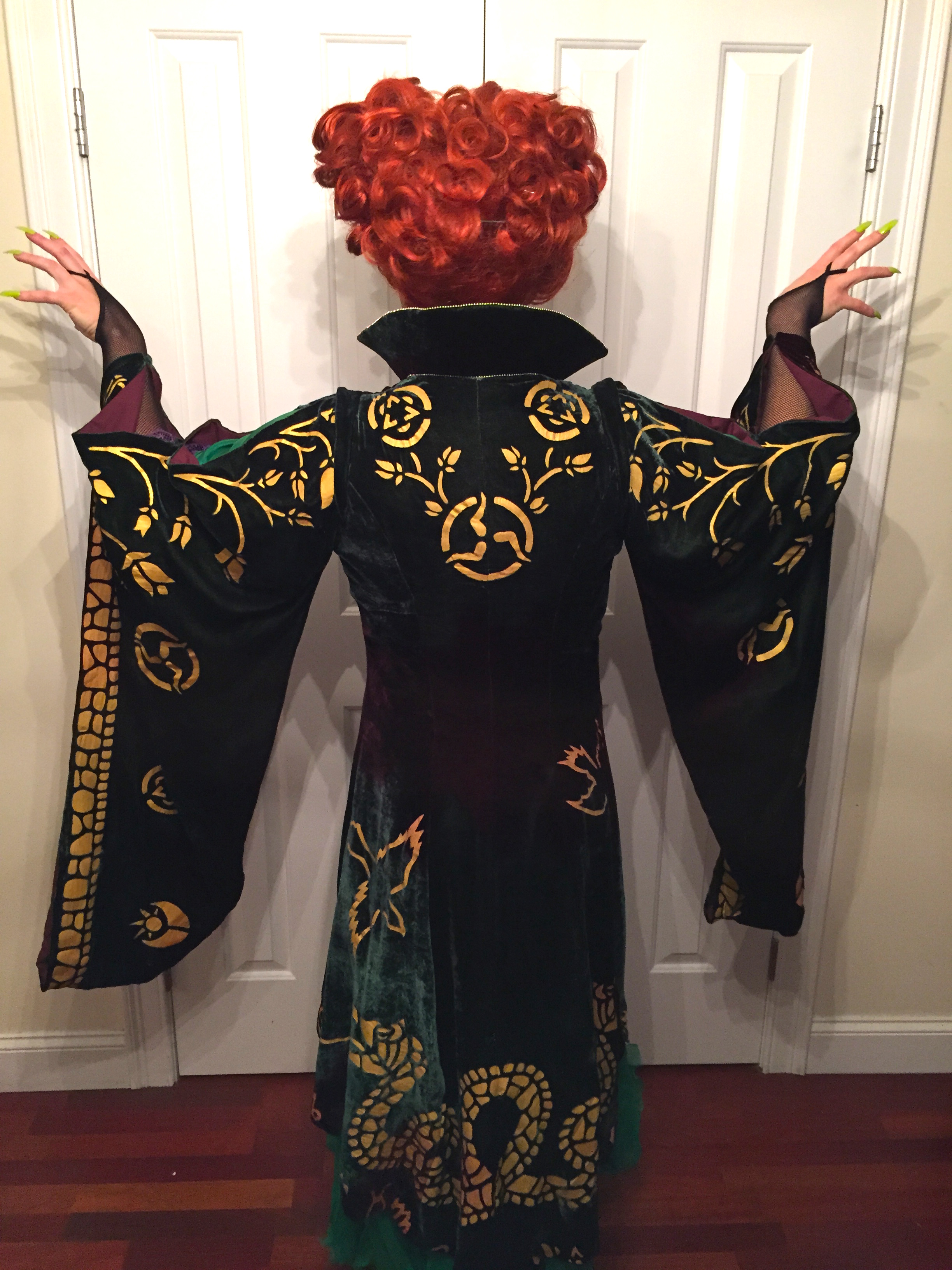

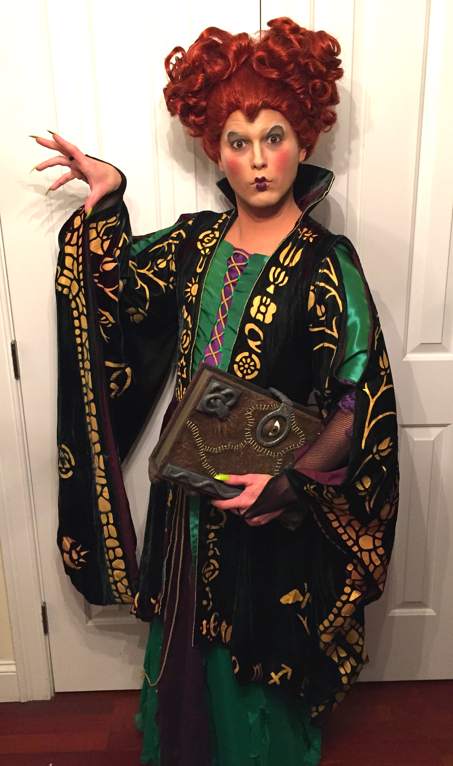

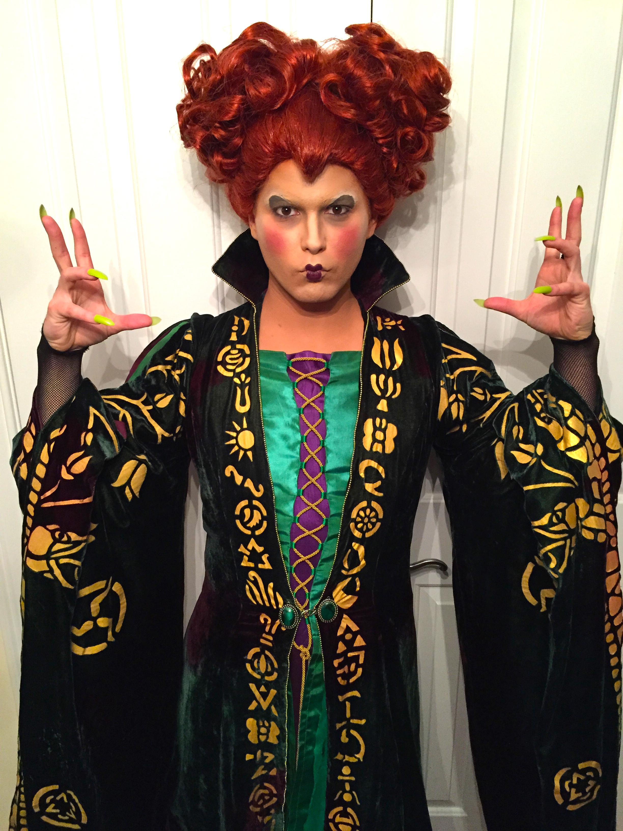

The robe was made in white silk and rayon velvet. First the pattern pieces were traced onto the velvet, then each symbol was hand painted using Fiber Etch on the "wrong side." Once dry, the fiber etch was ironed to burn away the pile of the velvet, leaving the silk backing intact. This was done for all the pattern pieces, which were then dyed with green and purple procion dye. Each symbol was then having painted in gold fabric paint and THEN the robe was sewn and lined.
The dress was made using two toned taffeta and two tone chiffon in both flag green and plum.
