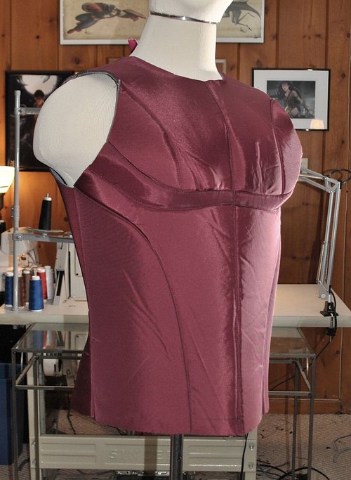

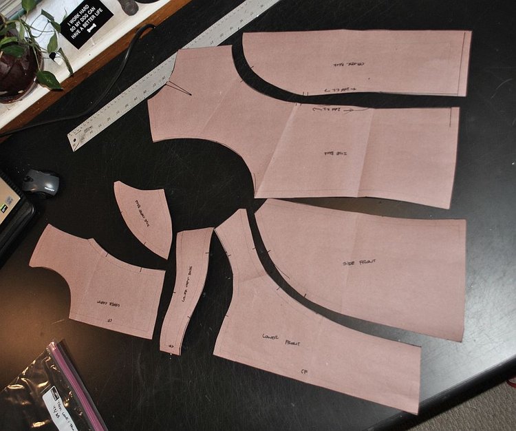

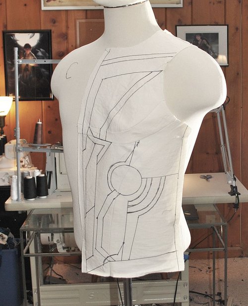

As always, the pattern was the first step. For the base, I decided to use the pattern that I developed for my Etsy shop. I created a mockup in a similar weight and thickness to the expected finished product and sent it off to the client for a fitting. Once the fit was confirmed, I was able to create a muslin version and sketch out the vest details.

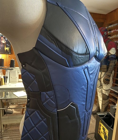

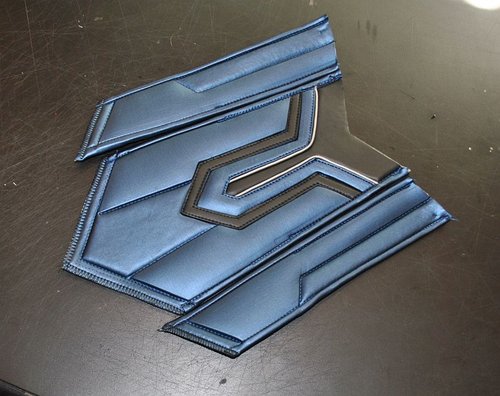

I began with the main torso. Using the muslin with the details, I built the vest out of metallic blue and black faux leather backed with headliner foam. In some areas, such as the chest, abs, and sides, 2mm EVA foam was sandwiched between the materials and sewn down to create the depth needed when the “armor” details were added.

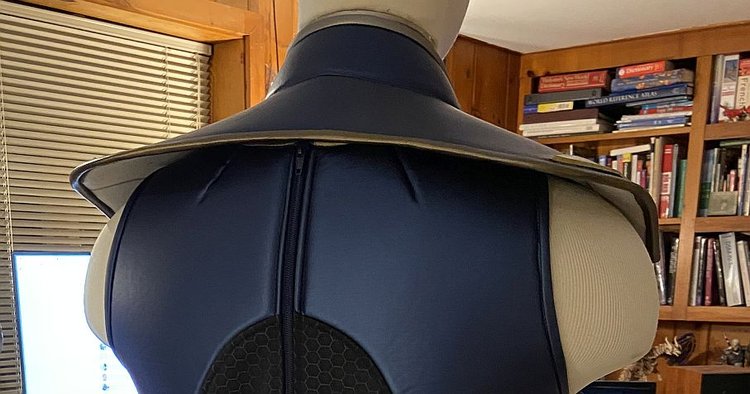

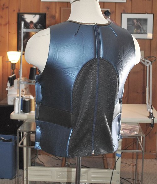

There is a large segment of stretch material that extends below the shoulder blades and covers the lower back. This piece will be covered by the cape and allows for a better range of motion and breathability at a point where most men sweat the most.

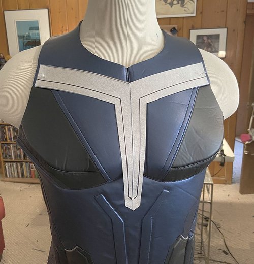

At this point, I created the shoulder piece and outer collar. I also began cleaning up the templates for the armor pieces and the discs.

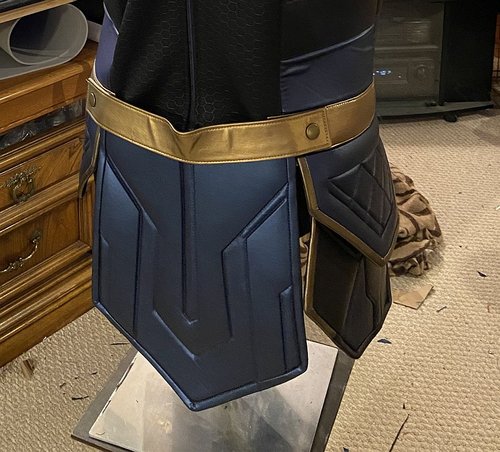

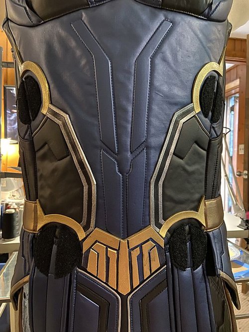

Next, the lower parts of the vest were built. The front, side, and back tabs were all constructed by layering headliner foam, 2mm EVA foam, and metallic blue and back faux leather. The back panel attaches with snaps and was made removable to accommodate the zipper.

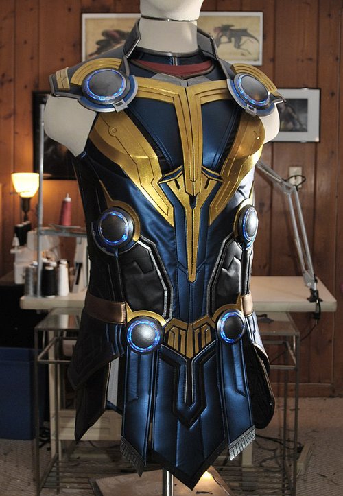

While the vest was underway, the discs were being fabricated by ezbsvs. I created flat vector templates in the correct scale to fit the vest and he created 3D files from them. Those files were printed in clear resin so that, once painted, lights could be installed in the back and show through specific details.

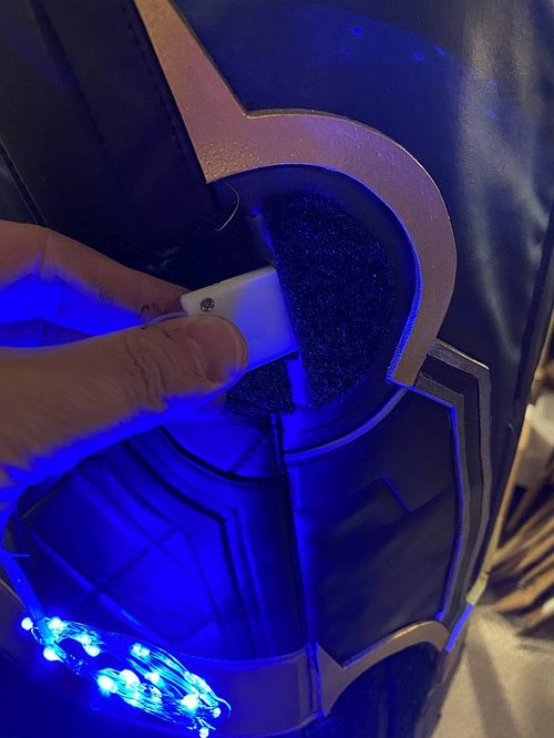

After the discs were printed and painted, I created the light effects using LED fairy lights with small battery packs. Each disc had its own light pack and each set of lights was mounted to an EVA foam disc and then glued to the back of the disc.
The discs are secured to the vest with industrial-strength velcro. The vest has slots punched into it for the battery packs to slip through to the inside.

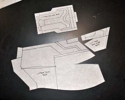

OK, rounding out the write-up on this one, I moved on to the accessories next. I created templates for the gauntlets and boots and cleaned them up on paper.

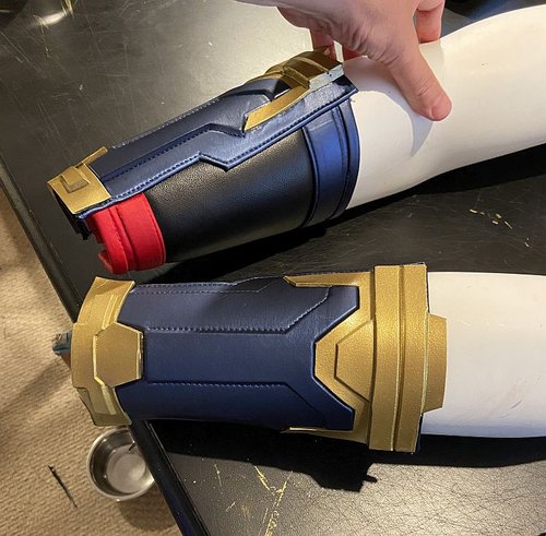

For the gauntlets, I built the front pieces out of layered 2mm EVA foam that I covered in the metallic blue faux leather and used a cording foot to sew down the details. I then finished all the edges, added the painted foam details, and built the backs. The backs of the gauntlets were built from headliner foam covered with black faux leather and blue and red details. They were finished with separating zippers on the backs of the arms.
