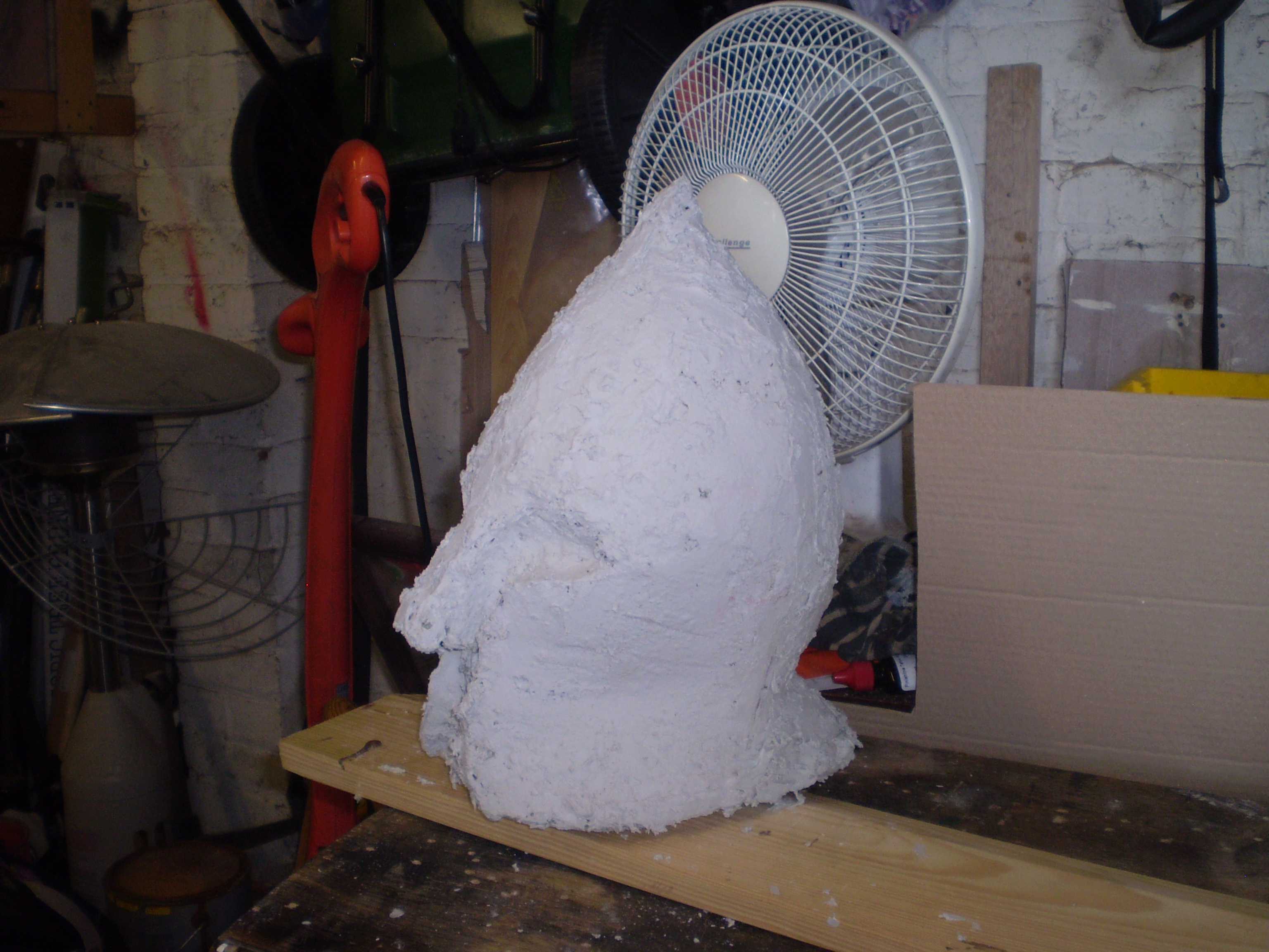

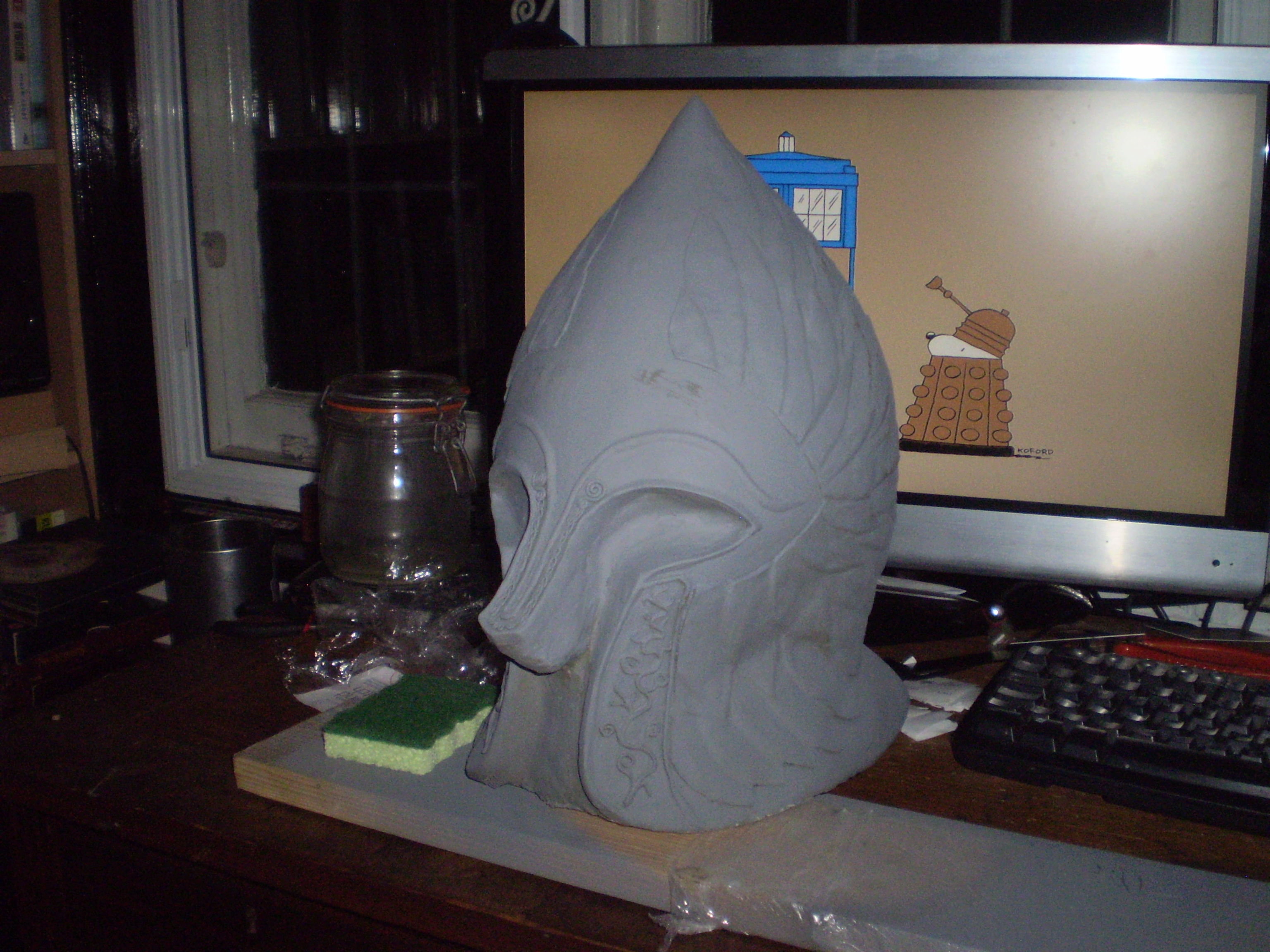

If it's helpful to glib, I gave up on using bondo on paper or foam after a project a few years ago (a Gondoran helmet) because it is such a hassle to work with. If I make a master of a costume piece now, I just use plasticine. It smooths out much quicker, and best of all there's no dust. You can also add fine detail to plasticine which you would really struggle to get with hard bondo.
[edit]
I thought I'd post these pictures to give you hope for sanding your project, and because the first one made me laugh:
You can get it smooth eventually, although I seem to remember using a big power sander usually used to remove the varnish from table tops :p

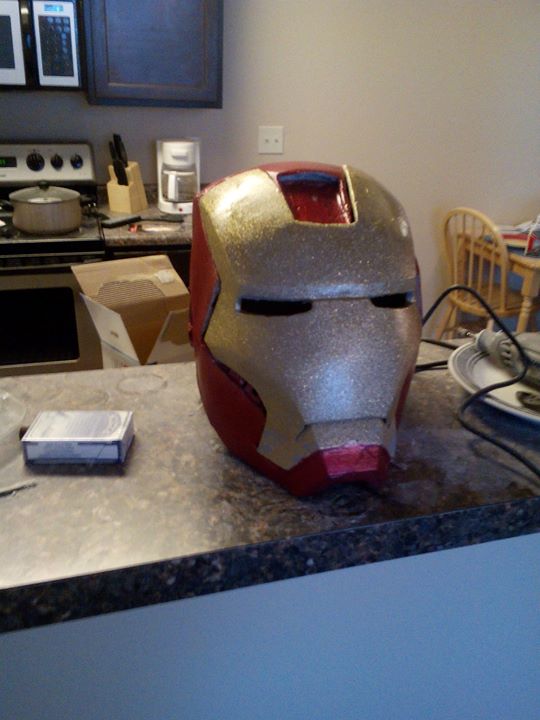

this is right. Resin is harder to sand than bondo. just spread on thin layers of bondo and sand that. I would not use an old credit card. spend the $5 and buy a bondo paddle set. many people are talking about using rondo, but if you talk to any real fiberglass fabricator, or auto body man, they will tell you using rondo in general is a joke. just use bondo and sand that. even on the inside were some people say to use rondo, i still dont. i do many layers of resin. resin is stronger than bondo, so by weakening the resin with bondo, to add strength to the inside, is a bit self defeating. Someone also mentioned a mouse sander. that is a good option for small detailed areas, but for large areas, go with a randomizing orbital sander, it is better, but just a bit too big to do details with.
This was done with 0 rondo, and nothing but an orbital sander. I am going to resand it and pull off all the paint because i am not happy with the colors, but u get the idea.
