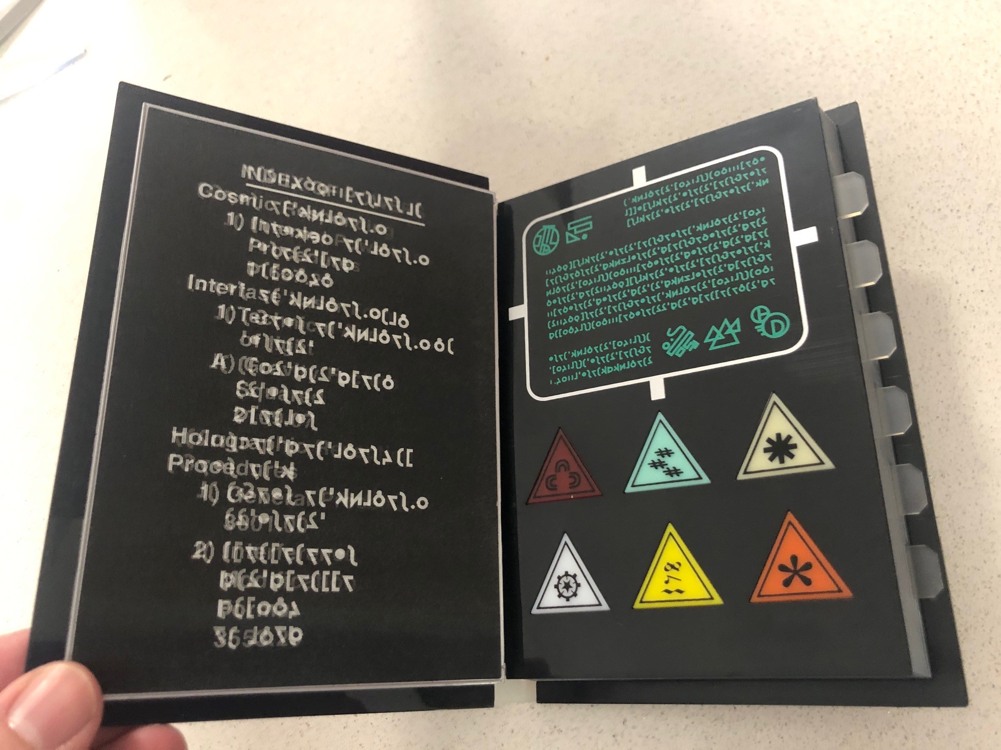

The book istelf is pretty cool. The construction is almost entirely solid acrylic, theres a bunch of LED's inside for lighting the spine, tabs and the icons. The graphics on the inside aren't terribly accurate to the screenshots from the Season 3 opener which I think is the only time we see the inside of the book in the show.

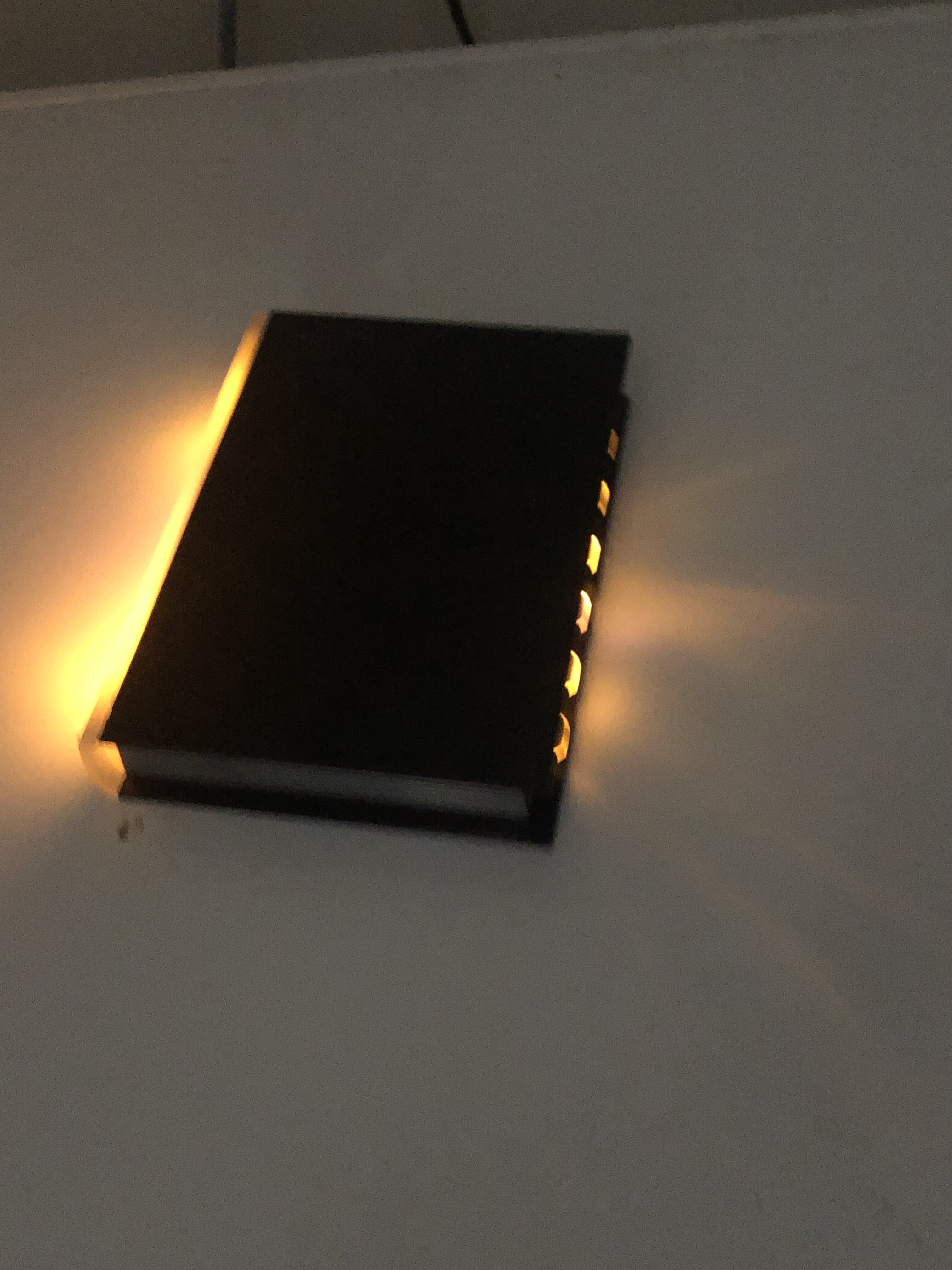

Thanks for the advice folks. A little vinegar on a cotton bud did the trick! Super pumped. The lights a lot less diffuse in person and the individual LED bulbs are pretty obvious, especially in the spine and the individual internal triangles pretty much all look orange. But it still looks great. Just need to give it an all over clean and then decide if it’s good enough or if I want to mod it with better internal lighting.
