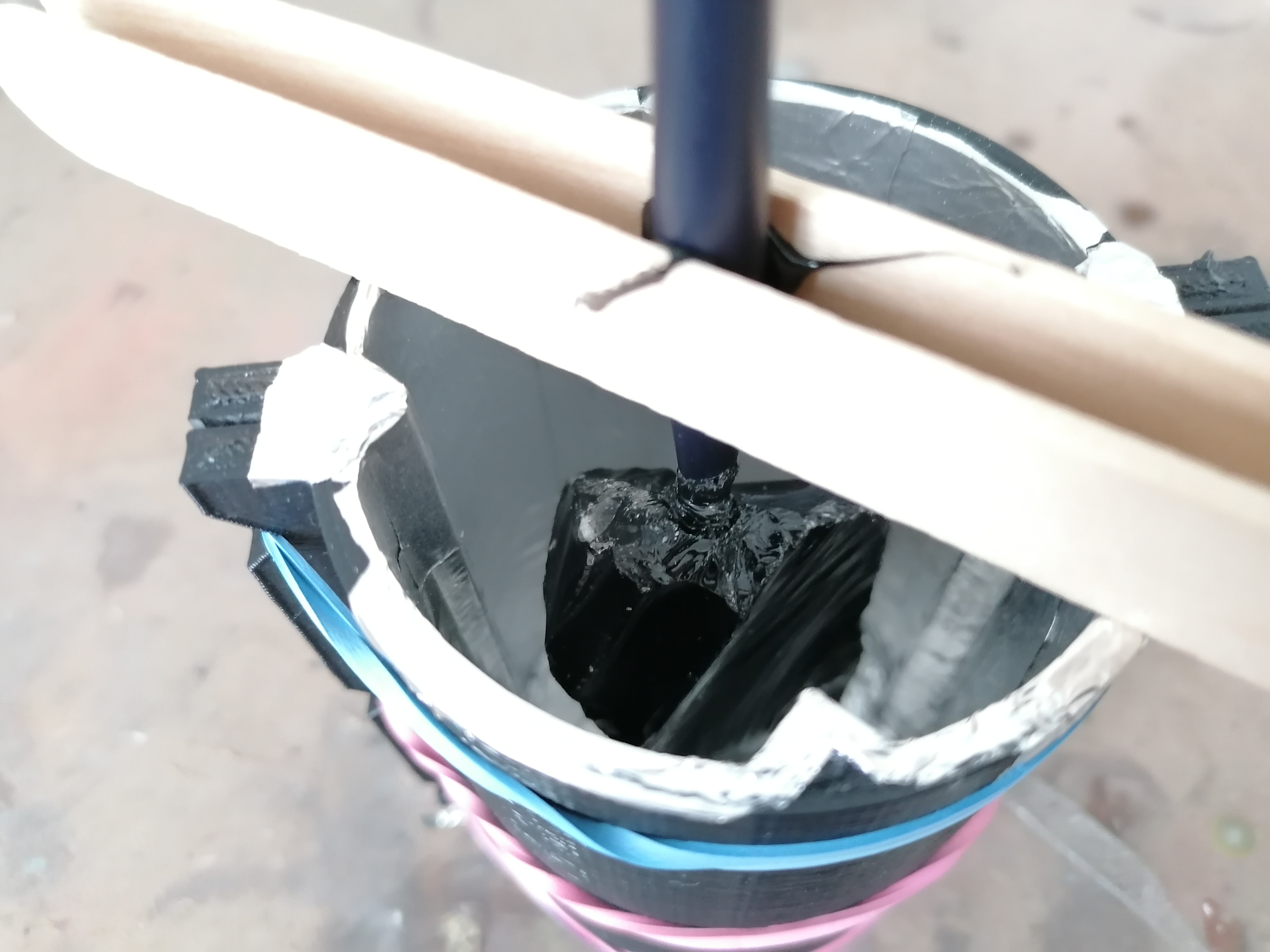

When it finally arrived, I grabbed some silicone (Polycraft K4 Translucent Addition Cure Silicone Shore A40), and went about making a mold jacket on the 3D printer, ready for casting. I did a little shaping to the obsidian before casting, which mainly involved hitting it with a hammer, and hoping too much didn't break off...
The casting process itself was pretty straight forward. I used the handle from an old paintbrush, and hot glued it to the back of the stone in a convenient little nook. I then used this as the pour spout, but also to suspend the stone into the mold jacket, ready for the silicone.
I then poured my silicone, placed it into the pressure pot, and left it overnight.
getting the mold free from the jacket was more of pain in the bum than I expected, but eventually, I got it free, and was then able to cut the stone free, using lines on the stone to hide the seams.
