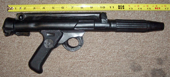

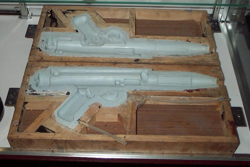

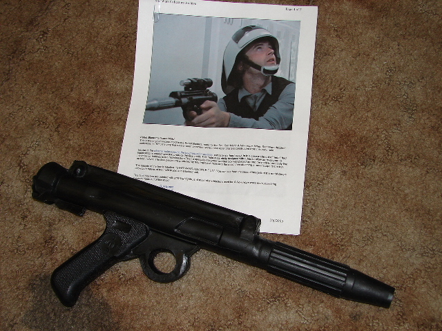

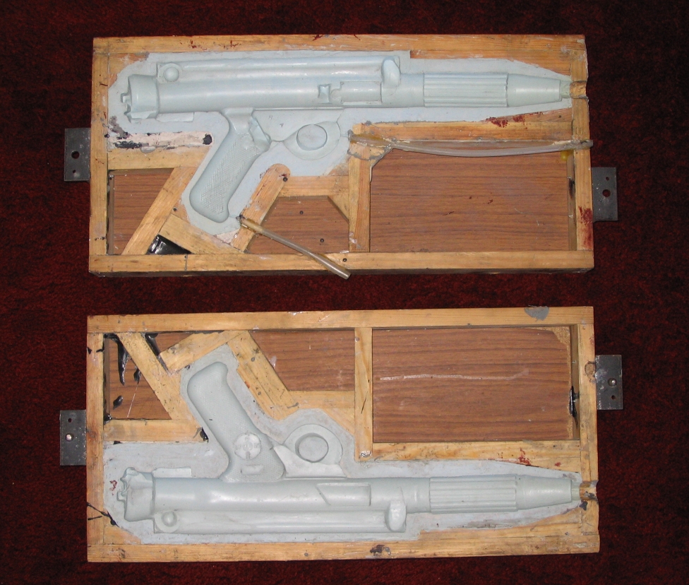

Collector Gus Lopez has a mold used for making the ANH blasters, and a cast.

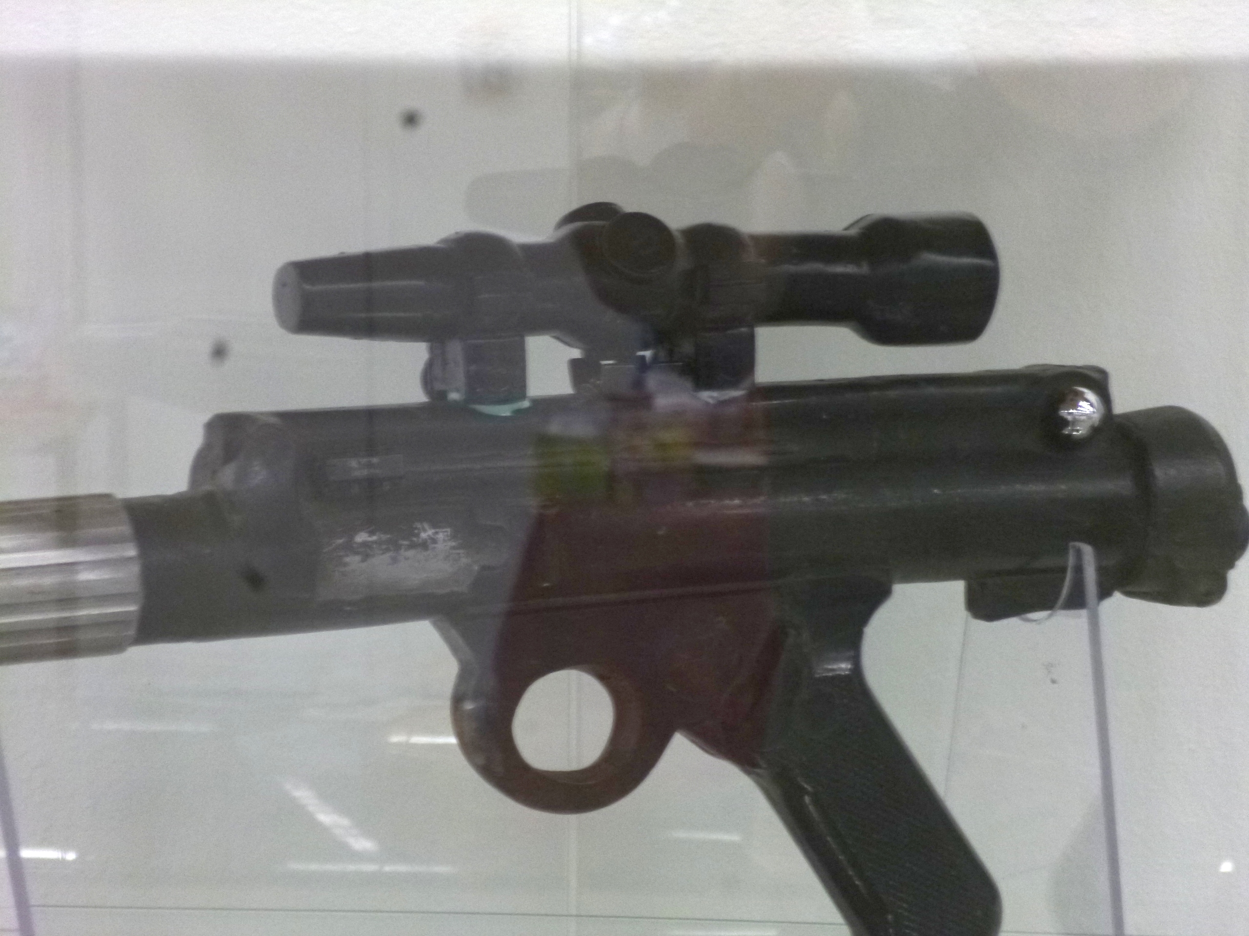

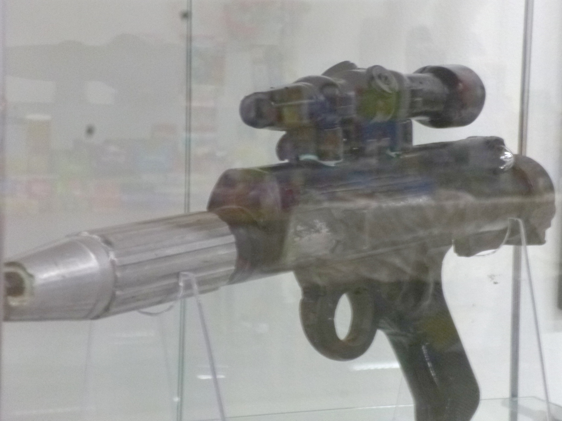

Two of my really bad shots (distance and glass) of the left side of Isberg's blaster, shot at one of the conventions he ran in Sweden:
Isberg's blaster still has the front of the two "scope rail" pieces: it looks like bent sheet metal.
The space below the rod has been filled, and the sides slope. On the left is a socketed small IC and glue residue from a lengthwise rod behind it.
In images from the movie, people have identified two Mitchell turntable pieces on the right side just in front of the endcap: 3D-printed replicas are available at Shapeways.
There is an "Imperial Disc" (Mitchell pulley) on the left trigger guard. Then different blasters have various wires.
BTW. Master Replicas' replica of the ANH blaster got almost all the greeblies wrong.

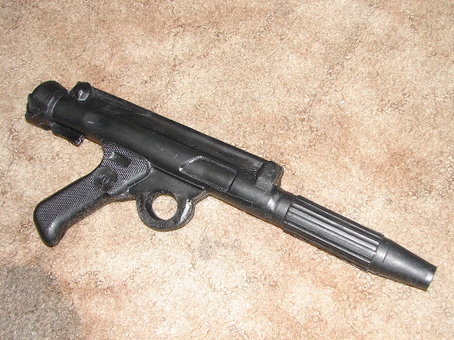

These are from that mould: MR was going to make them way back when.
It would have been part of their “Garage Kit Line” wherein the props would be cast from originals and not cleaned up in any way.

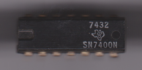

I believe they used the same 14 pin IC as was used on the MSE droid.
I found some on eBay a few years ago: Texas Instruments SN7400N Quad 2-Input Positive-NAND Gate (this one was made 1974 week 32)

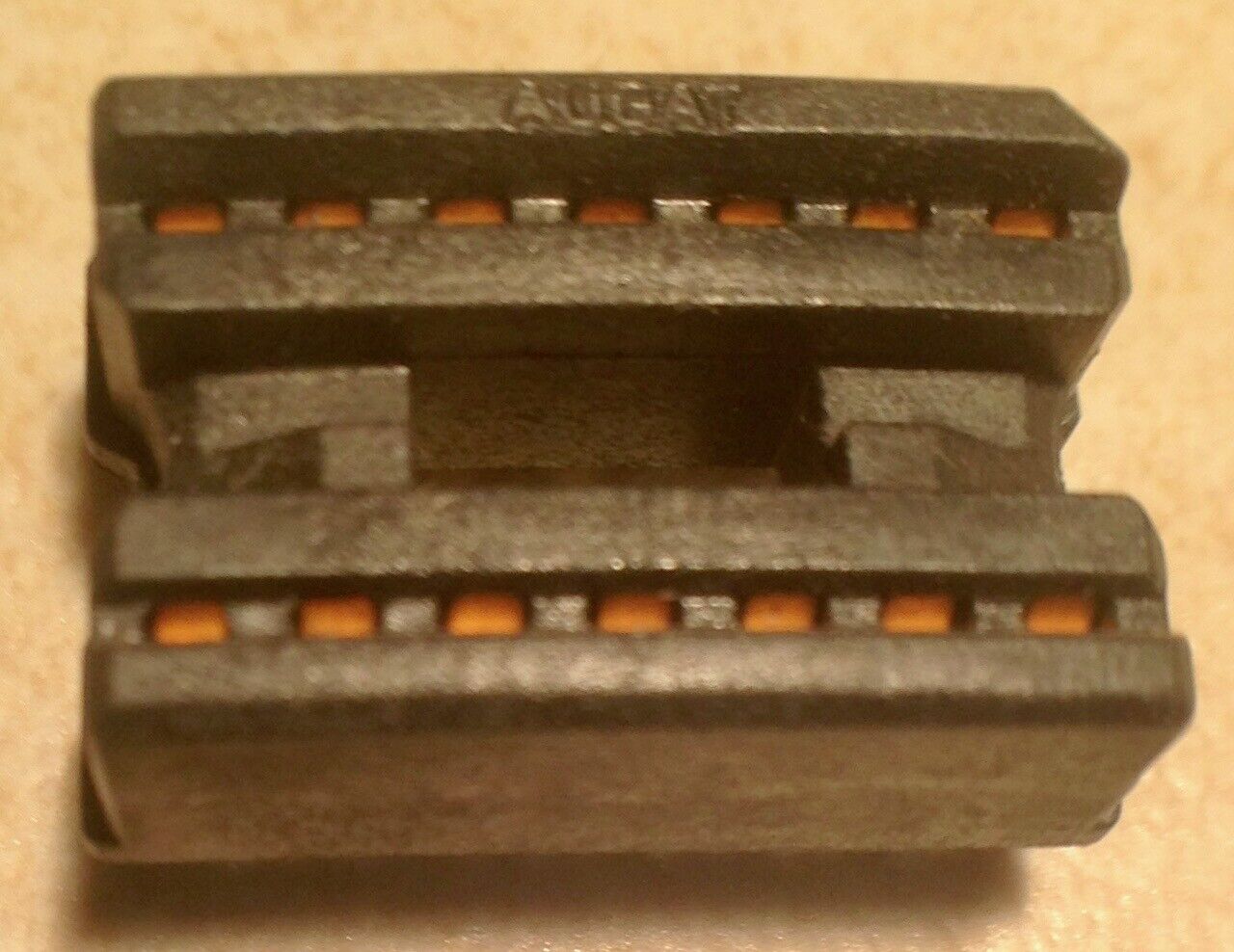

I also found on eBay the wide IC socket they used: "Augat Apple 1 14 Pin IC Socket" as it’s wide and has angled sides.
