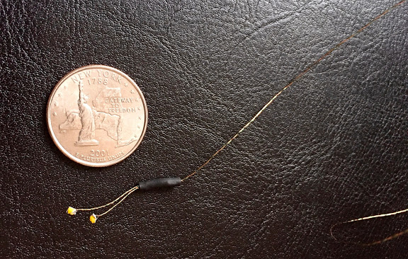

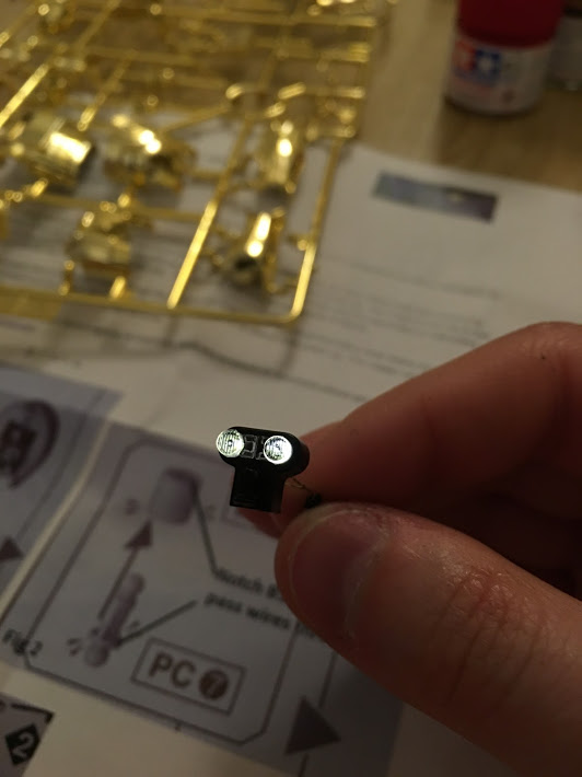

I haven't worked with LEDs this small before, so it was kind of shocking to open the package.

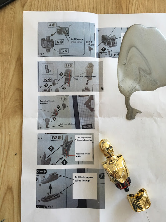

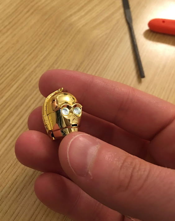

Testing the light diffusion - while the instructions were pretty straight forward, there was lot more cutting and clearing than I expected to get everything to fit and thread nicely.

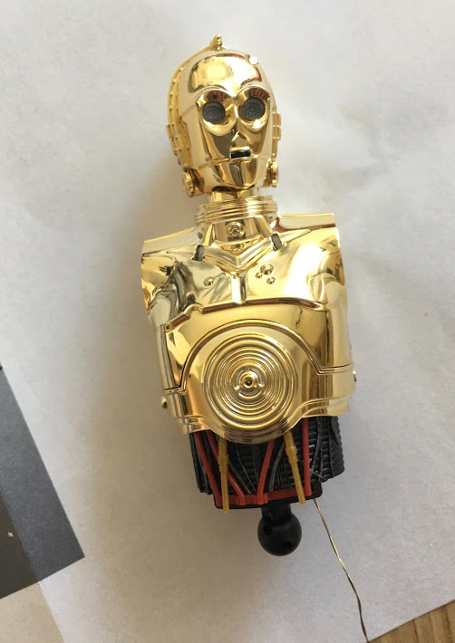

Step one - getting everything settled in the head
Coming together nicely

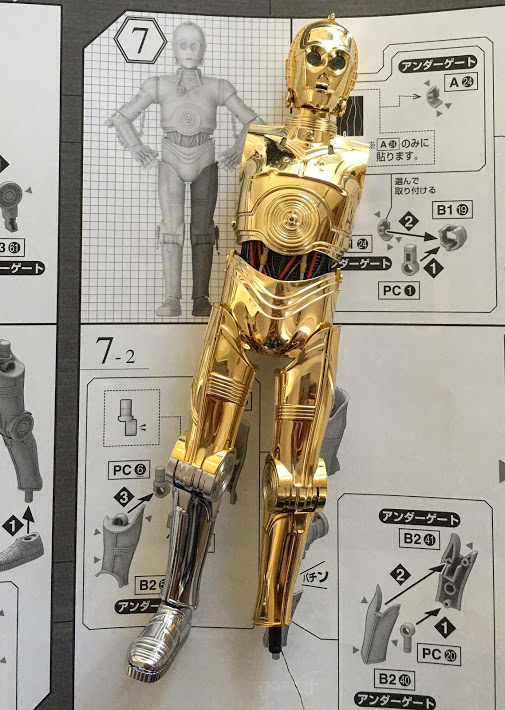

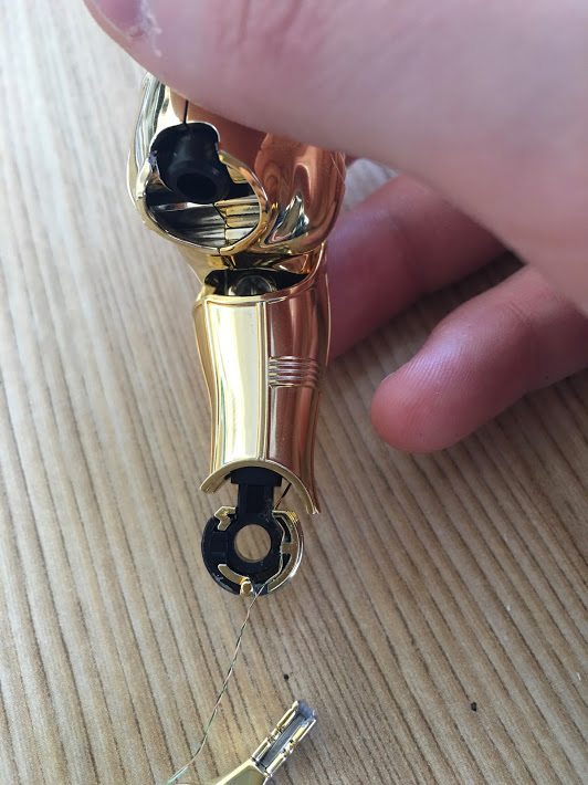

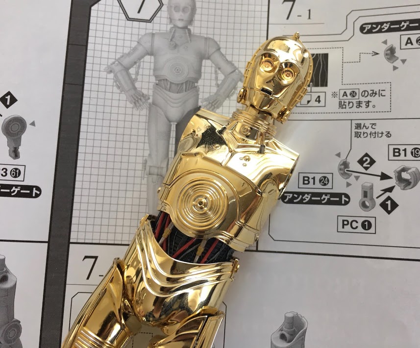

Threading through the knee was easily the most difficult part
I was pretty thrilled to get here - basically the hard part was over

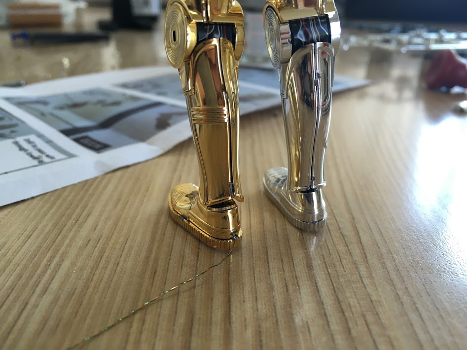

I didn't want the wire coming off the bottom of his foot, so the back of the heel worked well

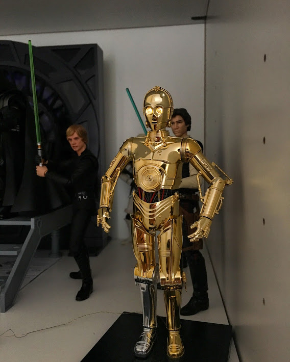

He lives!

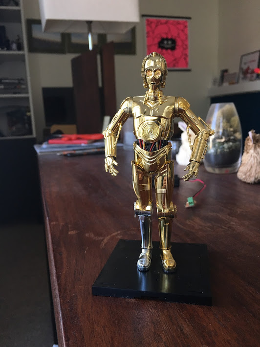

New home

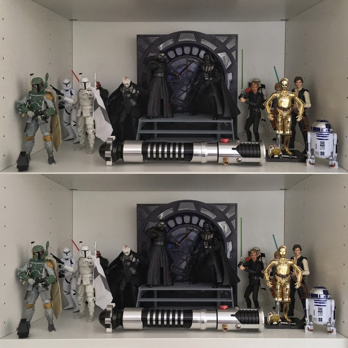

Perfectly scaled with my other figures
