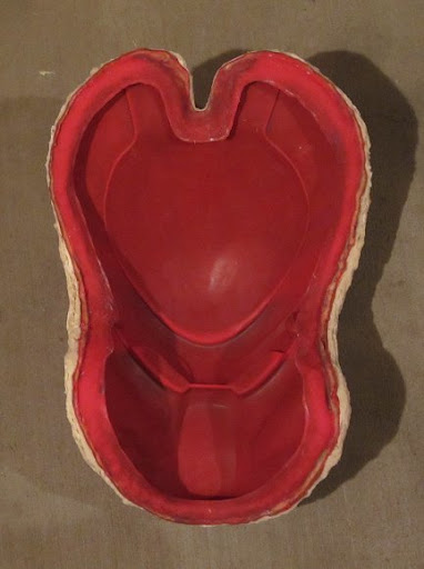

    Last couple layers of silicone before I add the Plastipaste mother mold:
    And ending it with red:

    Mother mold is finished. I LOVE working with Plastipaste - this stuff is bloody awesome and perfect! Once it started to harden, I used my Xacto knife to trim the edges and hopefully eliminate any locking. If it does lock on, I can always trim it with my dremel.
    Waiting for the mother mold to cool down and then pop it off!! SO ANXIOUS!!!
    The whole process from start to finish. 6 layers of silicone and 2 layers of Plastipaste:

    I was freaking nervous as hell pulling off the mother mold, but surprisingly enough it almost popped off with little effort! I then started pulling the silicone away carefully...the whole thing came off no problem! After inspecting every inch of the inside of the silicone, there are 2 flaws: there is a bristle hair (from the brush) on the surface of the dome; the side of the Bio rim has a small 5mm gap but that shouldn't even be noticed at all once the resin is in there. I'm blown away that there were no air bubbles trapped in there!
    I'm just stoked right now...this is something I should have started to do a long time ago. To be honest, when I saw guys like Rob, Daman, Gene, Paul, Casey, and all the other countless Bio sculptors doing this, I thought it was way too complicated AND that their talent was off the charts. I didn't think I would be able to do it. All it took was a few of you guys telling me that I should start sculpting. That little bit of encouragement over the past 2 years pushed me to take a leap of faith and trust that I could do it.

    This was right after I took the mold off. The clay is perfectly intact. While I dislike working with such hard clay, the benefit is that it retains it's shape quite nicely:
    Thank goodness for the mother mold because the silicone is about as rigid as a floppy donkey dick!
    Finally, here's the silicone with the excess drippings trimmed off:
