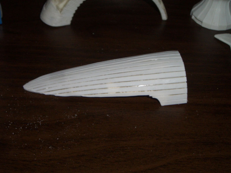

    My first scratch after 2 years break and first post here:

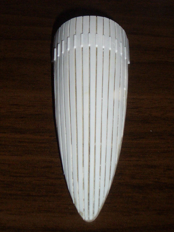

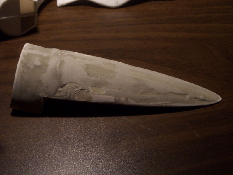

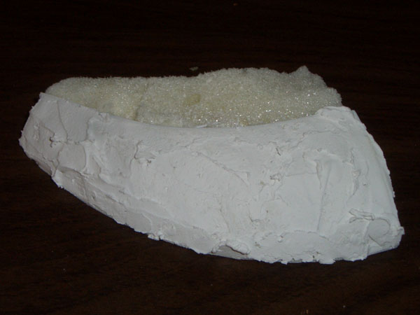

    The Jellyfish, my favourite ship design of the new Star Trek.
    I try to build it with light and moving parts.
    Here some progress pix:

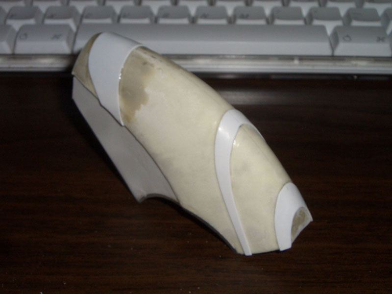

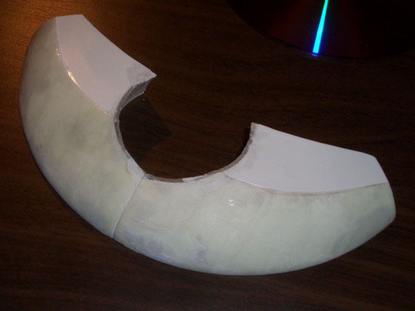

    Head:

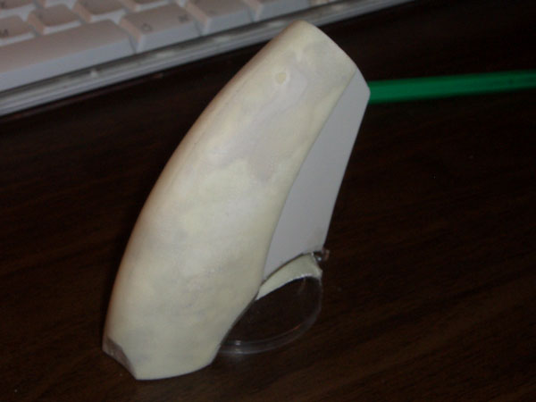

    Bow:

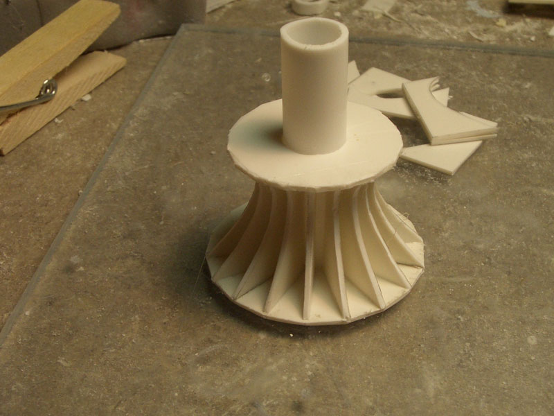

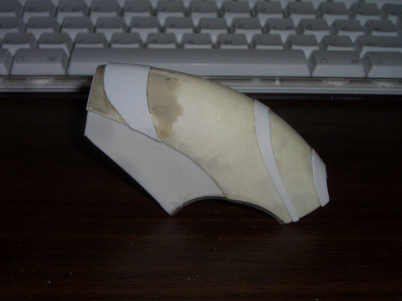

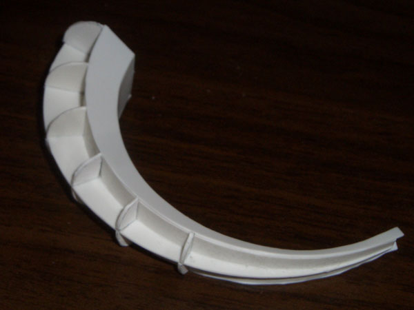

    Middle part of rotating section:

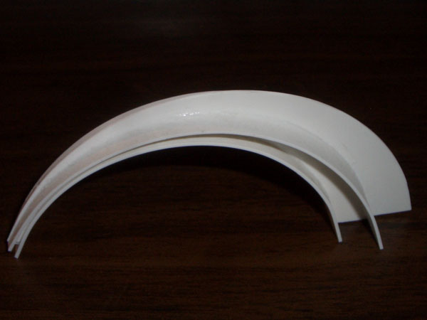

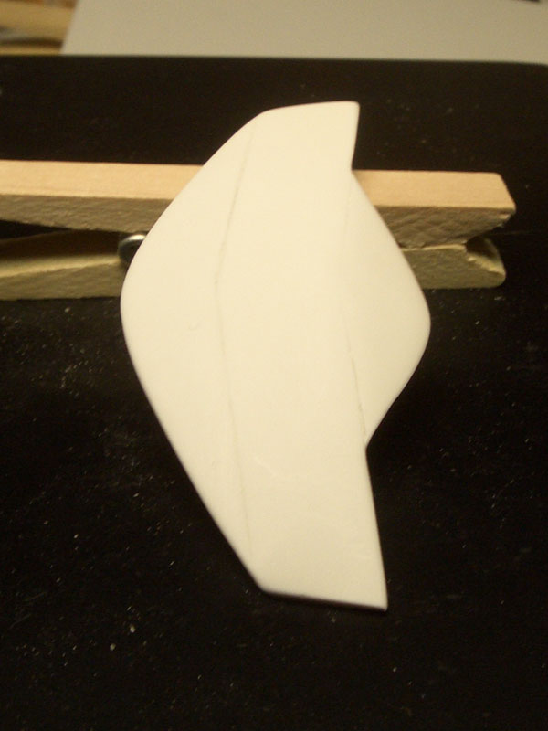

    Blade:

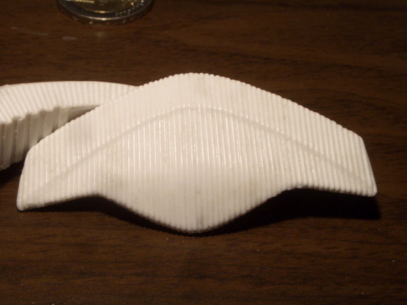

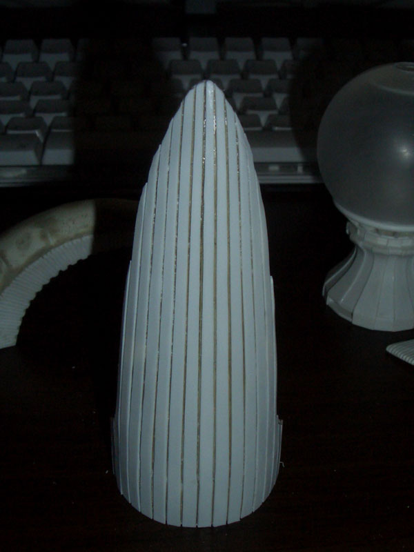

    without plating
    plating done

    Jan 27, 2010 - Re: Star Trek "Jellyfish" scratch #2
    Lovely clean work! How did you do the plating?

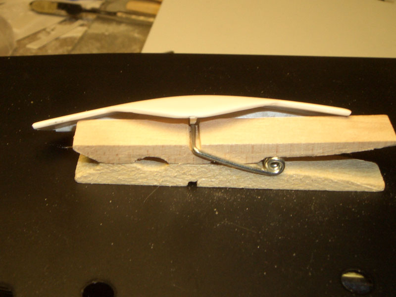

    You can't beat those old wooden clothes pegs.

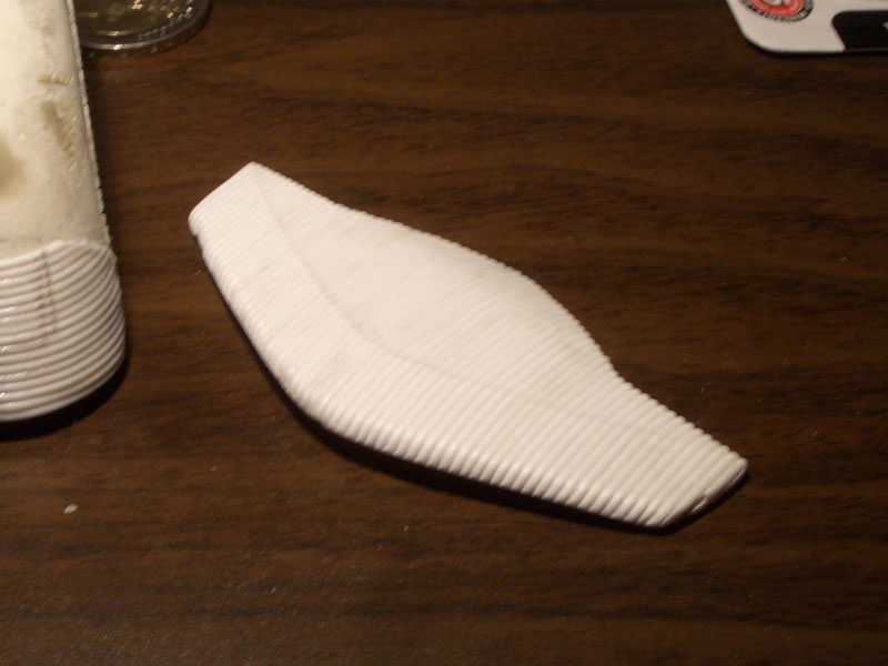

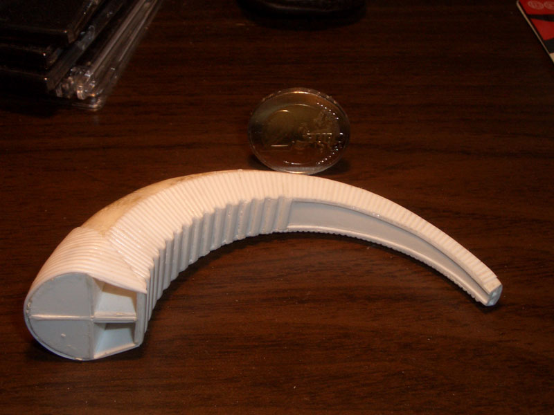

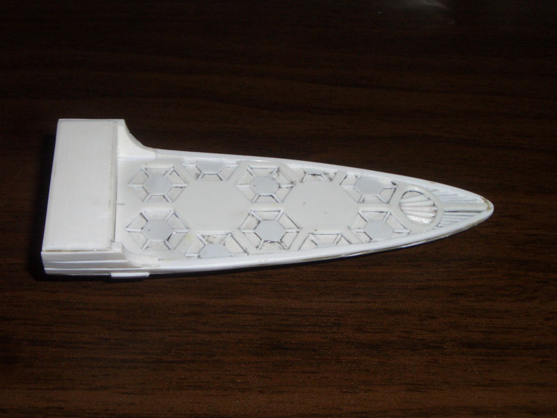

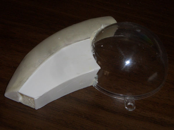

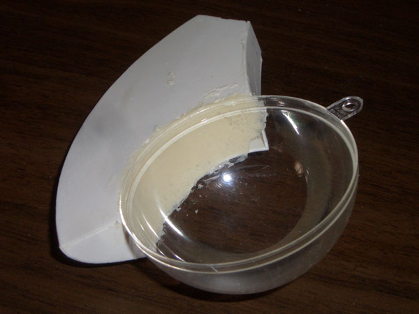

    Jan 27, 2010 - Re: Star Trek "Jellyfish" scratch #5
    Thank you.
    Plating done with Evergreen Ř 1 mm halfround profiles.
    I too would like a few more details on the build.

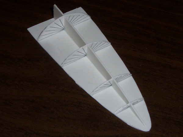

    The basic structure is build up with PS sheets. The "head" and "bow" filled up with selfexpanding PU-foam. And filled the pores with putty.
    To give the surface more strength I used one layer with resin soaked glassfibre cloth. Clean up with putty and a lot of sanding, sanding, sanding...

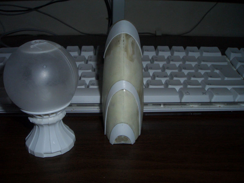

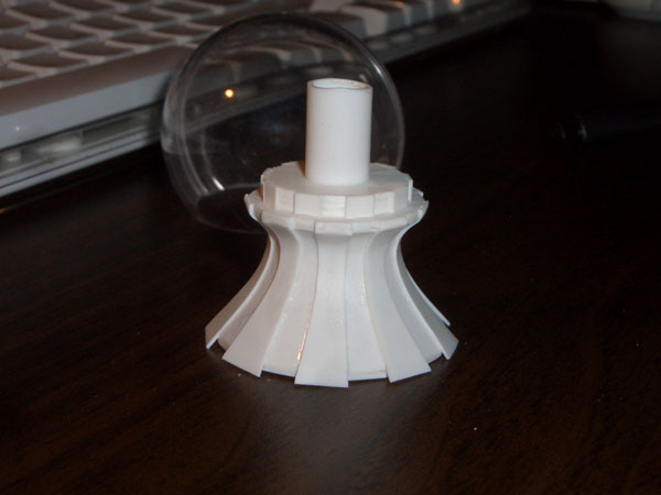

    The round cut-out is made with PS sphere:
    In case of the symmetry of the ship I planed to do only one half and cast the other half to complete it.
    At the moment I´m doing the forked tail. Once again a lot of sanding
    And I search for a posibillity to replicate that organic surface of the ship:

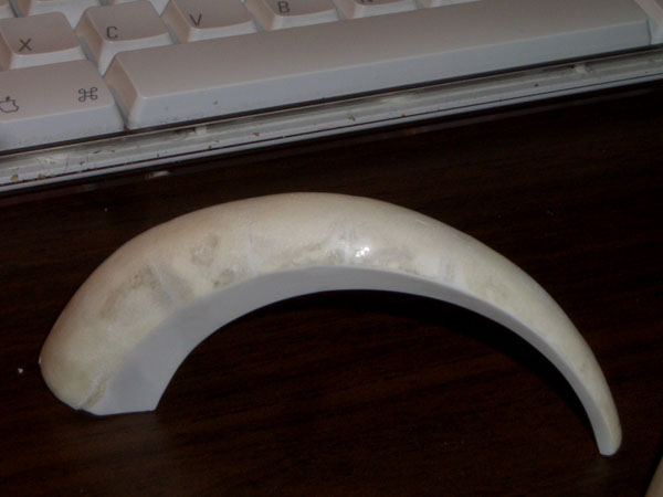

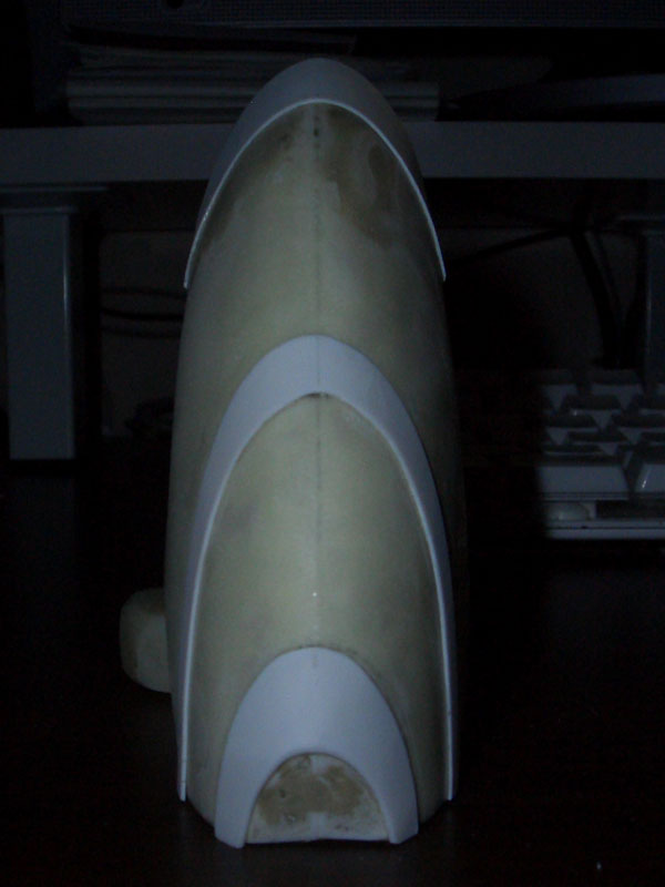

    Jan 31, 2010 - Re: Star Trek "Jellyfish" scratch #19
    Thanks.
    A small update.

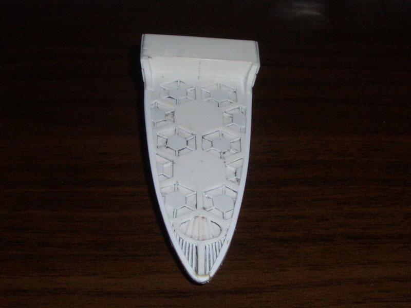

    Added some details on the "head". Once again I use PS-sheet for that.
    The 3rd in the back is unfinshed, in case that prt "hover" over the hull. I complete it when the head is casted.
    I plated the forked back, I try to get this result.
    Next I do clean ups and add more details on the inner side of it.

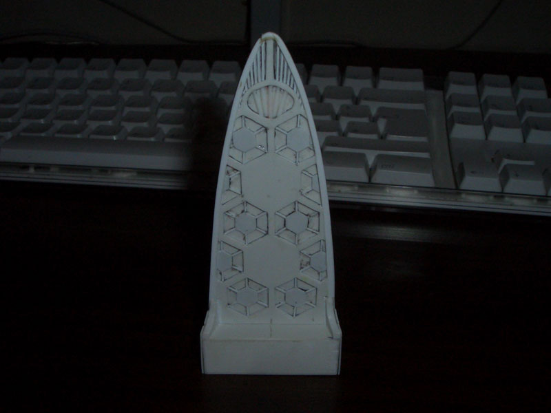

    Feb 5, 2010 - Re: Star Trek "Jellyfish" scratch #21
    More details on the back part done

    Feb 5, 2010 - Re: Star Trek "Jellyfish" scratch #22
    Lovely job, I really like the detail of the inner face !!
