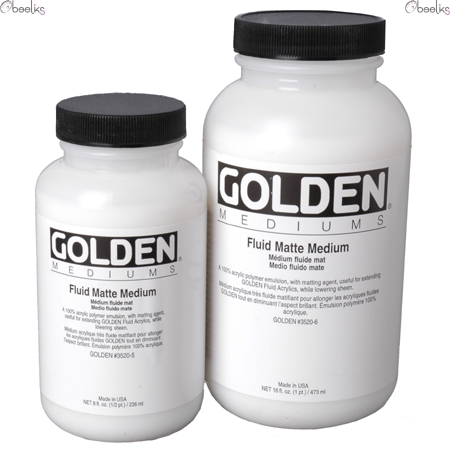

    I always keep these guys close in reach
