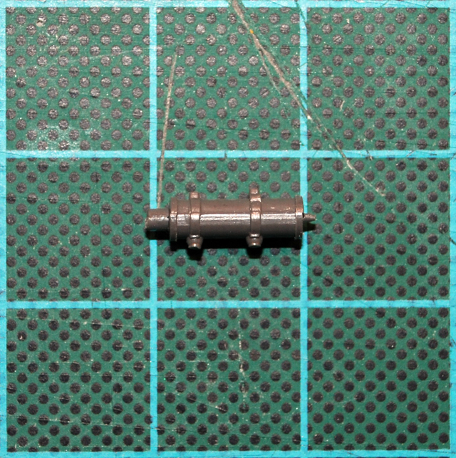

    Thanks to the generous support of -... . .- --.. I have my scratched version of the Tamiya 8Rad part, and this is definitely the one I will use in my model.
    This has forced me to change the depth of the wings rear channel as it was designed to use the Hanomag parts and, therefore, was deeper than I need to use the 8Rad parts.
    The channel depth on the end of wing was correct but the on the wing startup I had to reduce their depth in 1.5 mm. For this, I cut new channel bases of 1.5 mm. and carved wedge-shaped with a blade to refine them at their ends towards the wing tip, leaving a very thin end zone of about 0.2 mm.
    The goal is to get the 8Rad parts protrude from the channels as in the reference images.
    Once I returning to work in those rear channels, I have taken the opportunity to also reduce the thickness of the walls, achieving a thickness of 1 mm. only in the inner panel of the wings and not 1.5 mm. that I mistakenly gave them.
    Thanks for looking.
    Rafa
